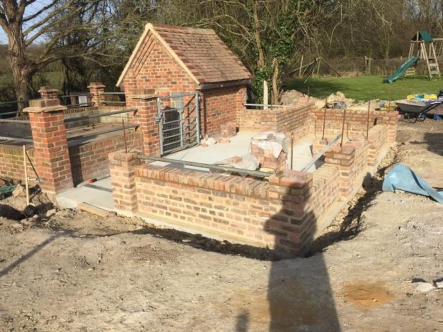

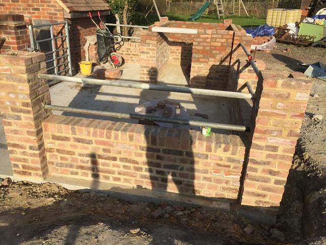

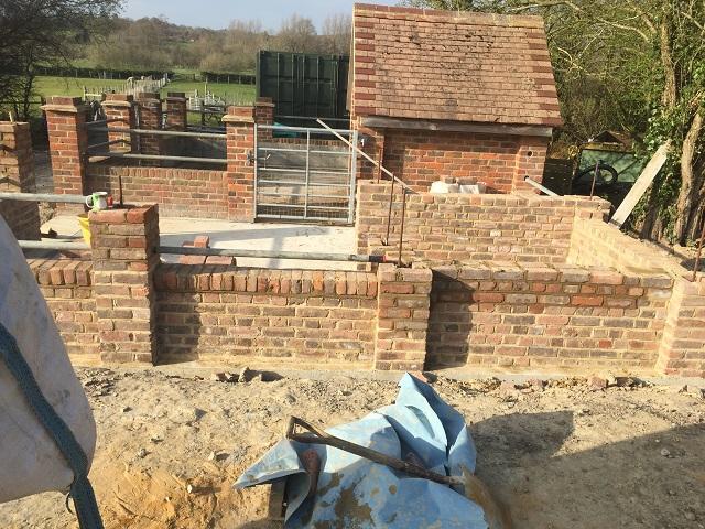

Well another weekend has come and gone which brought Brian the Brickie here for a day and a half with some commensurate progress. That's 1500 bricks bumped out, and my body is telling me the details of every one  :bugeye:

That's a posh piggy palace!
How do the pigs like the concrete? Don't they miss being able to root about in mud and generally turn the ground to mush?
Re: What Keeps Me Out of the Workshop
« Reply #28 on: April 12, 2015, 05:24:17 PM »
We used to raise pigs on earth on that very spot before we built the first sty and yard, but it became totally untenable over winter.
Not only was it so soft they could easily circumvent the fencing as they worked it loose, also keeping the sleeping quarters viable was impossible - we are on a very soft bit of low lying ground. I do also have two earth pig runs elsewhere but we rarely use them now as the pigs don't seem to have an issue not wallowing. They get the occasional turf to keep the mineral input up, and a hose spray in hot weather.
If you consider that virtually every cottagers sty was either cobbled or concrete it's not a new thing.

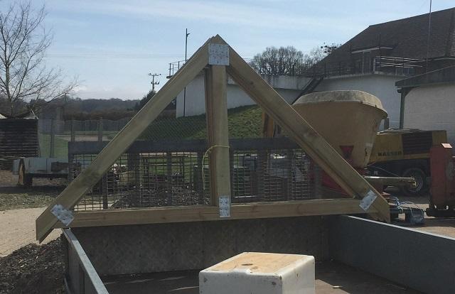

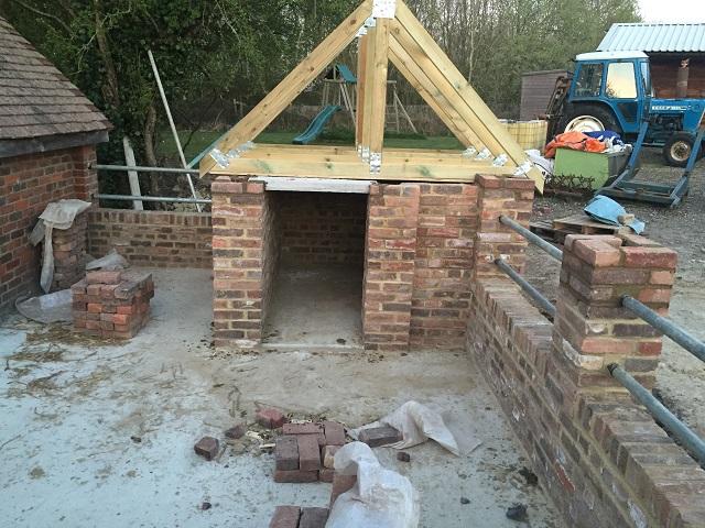

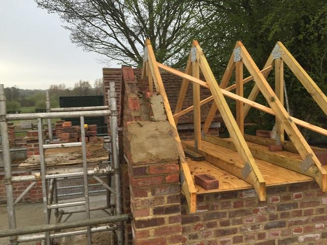

So as mentioned above I made the four simple trusses for the sty roof this morning. Usual crude building woodwork fixed with nail plates. I think that they're identical to the ones I made a few years back for the first sty - but as there's a 'ceiling' of 20 mm shuttering ply with 200 mm of rockwool insulation above I cannot actually see anything other than the lower few inches of them. The brickie builds the gable ends to the shape of the outer trusses, so they're needed before that bit of brickwork is done.
I doubt Brian the Brickie will  be ready for them next weekend when he comes, but at least the pressure is off as they are ready and waiting, conveniently stacked across my Ifor Williams trailer.

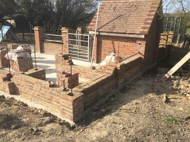

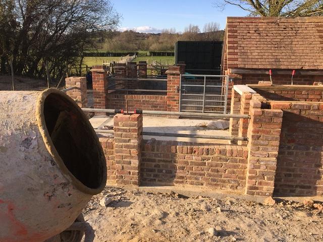

Well a bonus day today (Thursday) as Brian the Brickie was unexpectedly able to give me another day laying bricks.
Incidentally, these bricks are all rejects from the local brick yard, and a fellow buys them as hard core, and has his wife and daughters sort out what is vaguely acceptable to lay, and pallatise them. They give a rustic charm :)

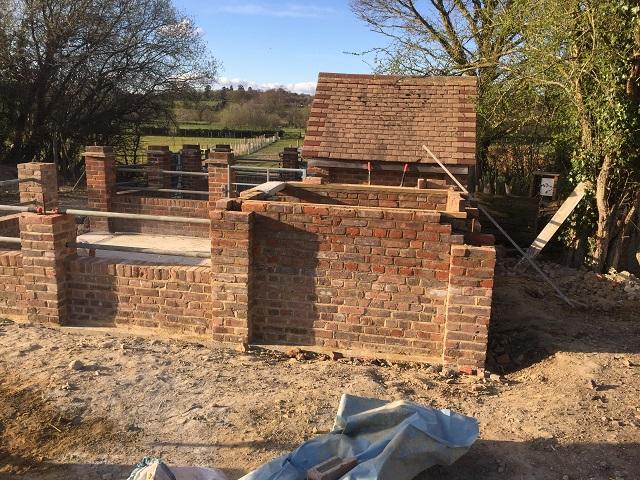

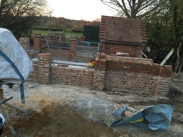

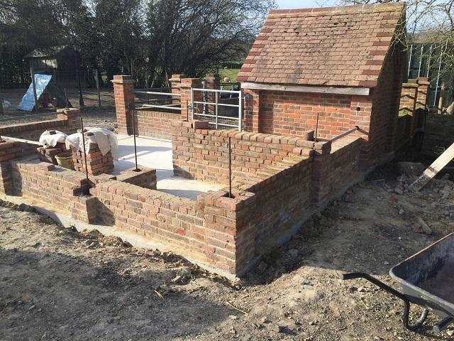

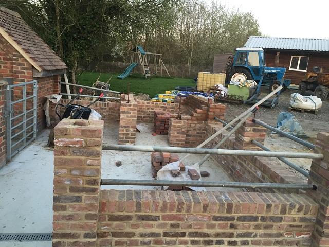

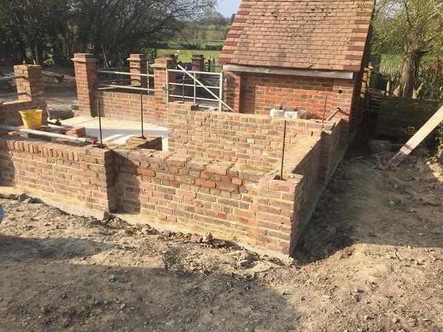

So another week end and a bit more progress - Brian could only put in 3 hours on Saturday but made up for it on Sunday working a straigt 10 hours.
The wall plates are now ready for the trusses, but all the pillars need filling with concrete before that happens, and two of them are not up to height yet

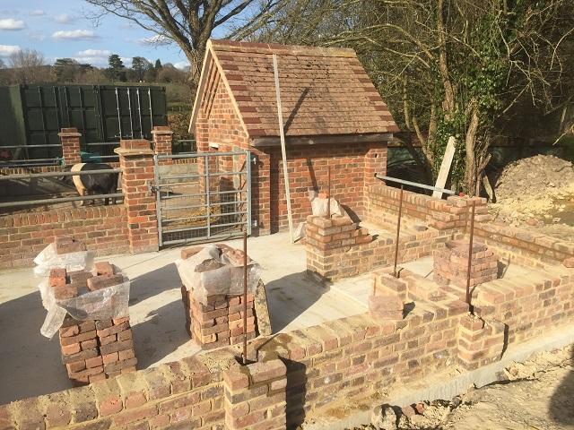

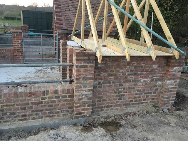

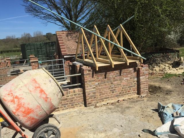

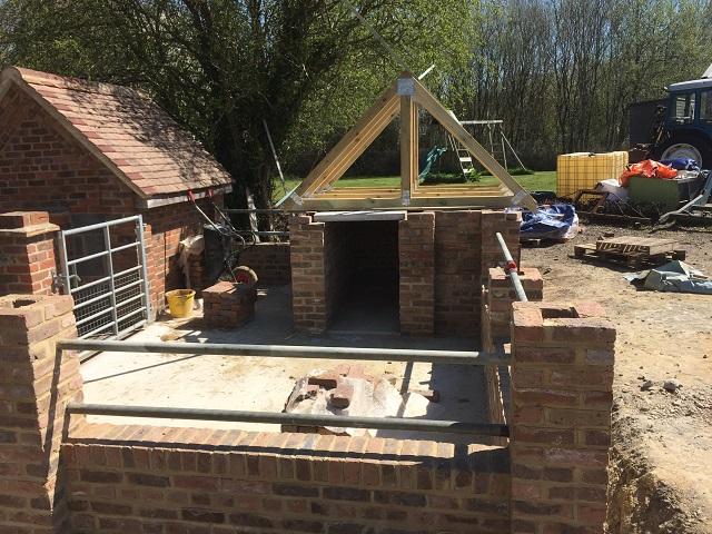

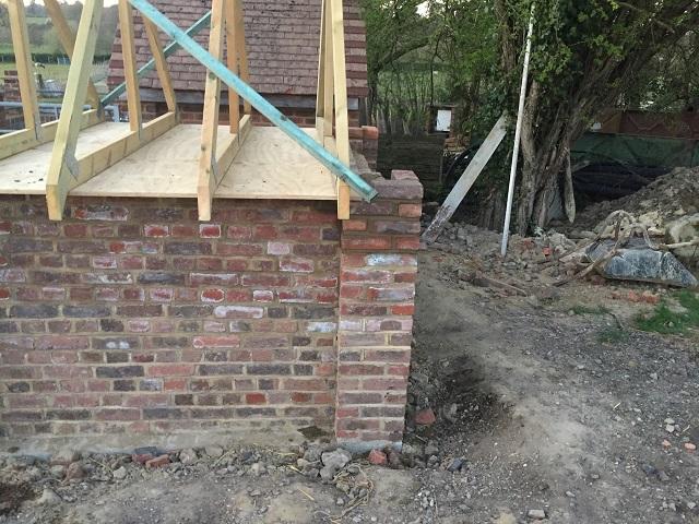

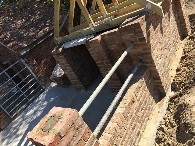

My eldest son came to visit today, so I took the opportunity to get him to help fitting the trusses. I'd thought that they'd obstruct the pillar tops thus preventing me filling them with concrete, but in practice they don't. Construction is rather unconventional, in that I've laid a 'ceiling' of 20 mm shuttering ply from wall plate to wall plate, then set the trusses on top of the ply, as fixing a ceiling after the trusses are in would be very difficult in such a cramped place.

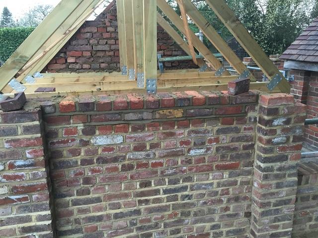

It was while measuring up to cut the ply we realised that Brian the Brickie had set the lintel in the wrong place - it was 4 1/2" too far forwards. So I chopped it out, and there is still access to re-set it even with ceiling and trusses in place. He's back this evening to finish the pillars, so he can re-set it then.

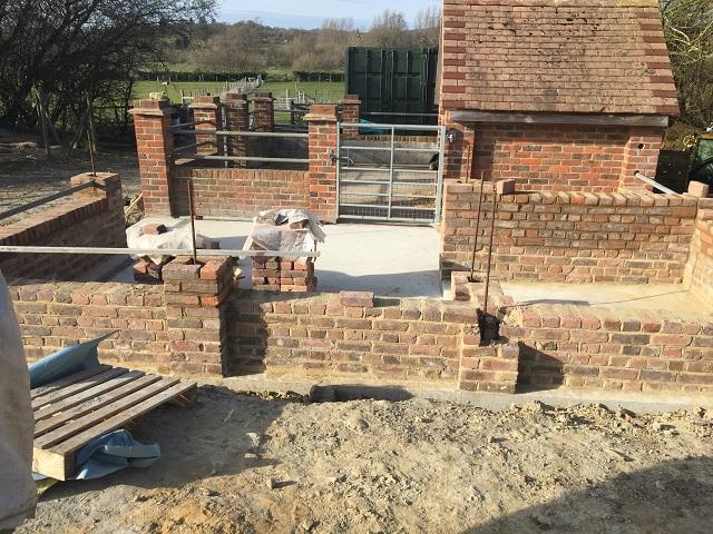

So as promised Brian the Brickie popped in for a couple of hours this evening to bring the pillars up to a height that I can fill them with concrete (hopefully tomorrow) He also re-set that lintel that I had to move.

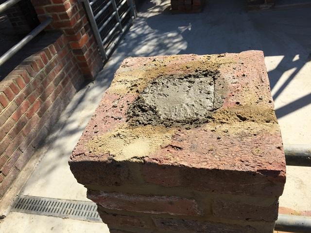

I spent a couple of hours before breakfast knocking up some strong fine concrete and filled the pillars. Used a cut off sheep feed sack as a funnel to avoid putting cement marks down the outside. Took a remarkable amount by the time it was tamped down and fully compacted - 10 cubic foot by my calculations.

When renovating my house, I moved a couple of door frames. Not knowing that these days they are just foamed in, I filled the frames with cement mortar. Amazing how much you can get in a seeming small space if you don't bother calculating the volume.

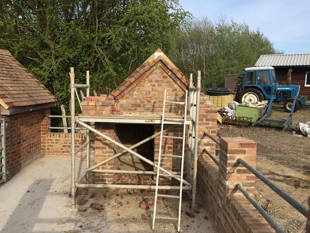

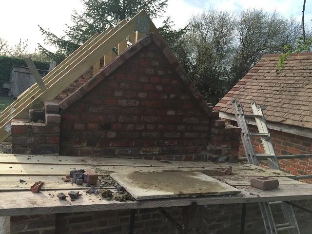

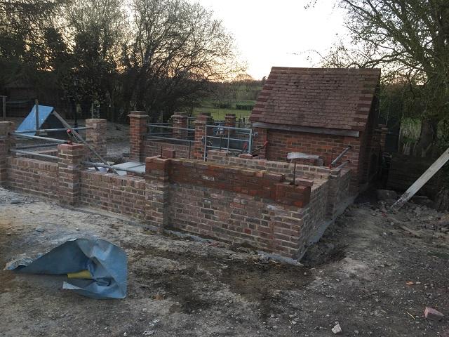

Brian the Brickie returned today (Saturday) and put in another 10 hour stint. He's got the majority of the front gable end up and (for some inexplicable reason) done a bit on the rear gable.
He can't manage tomorrow as he has a meeting of the local crown green bowls club, and being chairman has to be there :( He's suggesting he'll be able to be back Tuesday or Wednesday, but the weather is breaking so that might well stop him - still quite a bit of progress today.He's motivated to finish it, as I've told him he can't borrow my digger until this job is finished  :lol:

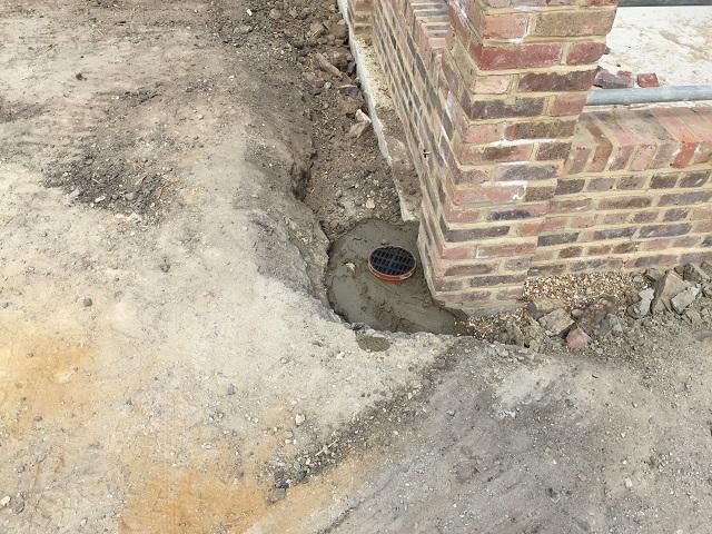

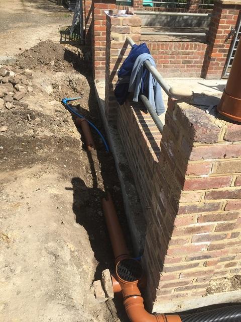

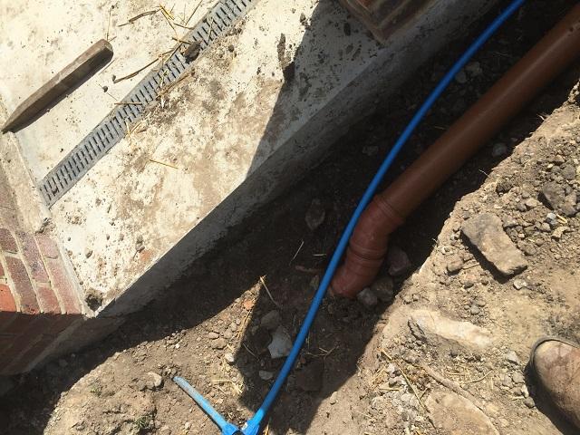

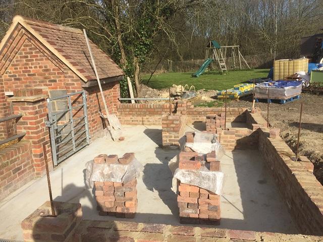

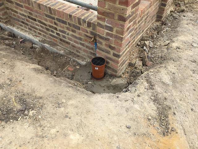

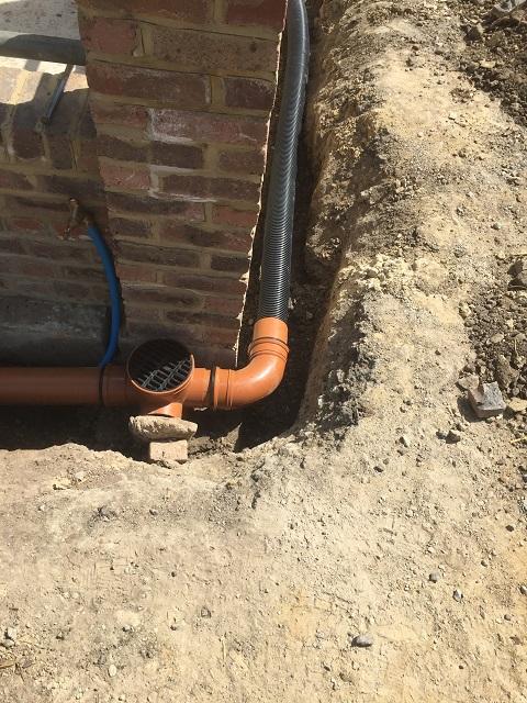

So today as Brian the Brickie hadn't turned up by 08:30 I decided he wasn't coming, and I'd get on with the surface / land drain run, and water supply, which entailed hand trenching up the side of the slab, and connecting to the 'Y' point I'd previously installed when I put the 'Aco' storm drain within the pig enclosure. Hand trenching as it's too tight to get the digger in.
I'd done the first couple of metres by 9:05 and of course Brian turned up - my trenching cutting him off from where he'd been working  :bang: So we agreed that he'd continue on the rear gable while I got the drains in.
Solid pipe up to the corner of the sty, and perforated land drain in pea shingle across the end. As I wanted a rodding point at the corner I decided to incorporate a 'back entry gully' that I had left over from previous works, and place it under where the tap will be on the corner pillar. I just had to buy an 'extender' to bring it up to finished ground level (not yet in the pictures.) *** edit actually you can just see it sitting upside down on the pillar !!!!!!!

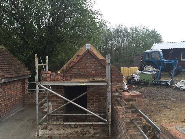

Brian got the rear gable up to the first layer of corbelling, and put the second corbel on the front gable.

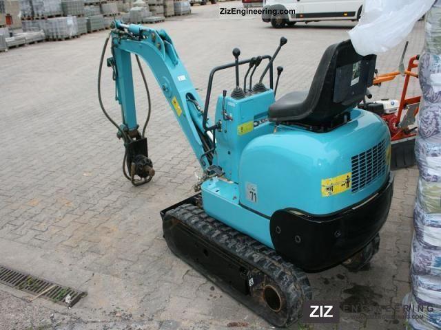

Today I let Brian persuade me to sell him my Kubota K008 3/4 ton digger. He needs a small one to fit through a door for a job he has coming up, and I need a bigger one, but not as big as the JCB 3CX 14 tonner that I reluctantly parted with last year.
I've located a JCB 803 and committed to buying it - this is a 3 ton machine that should hopefully fit my needs and not be too much of a dog when I see it in the flesh - bought blind from a dealer 300 miles away  :bugeye:

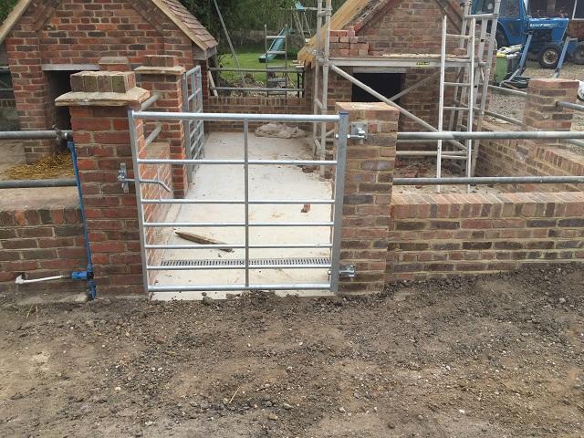

I decided having laid the land drain etc to start back filling up to the walls in road planings that I'd saved when I excavated for the slab. First I had to fit the 'drain riser', then the gate to see where things need to end up
