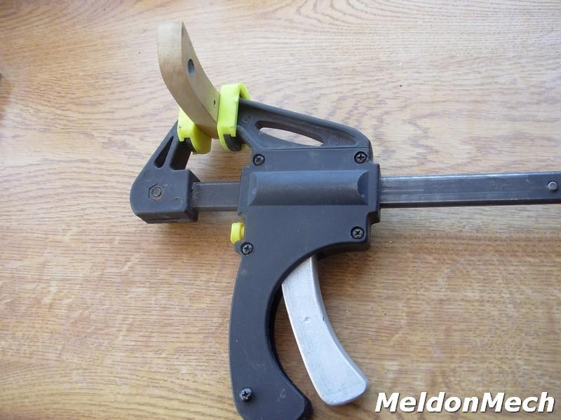

 Hi Guys

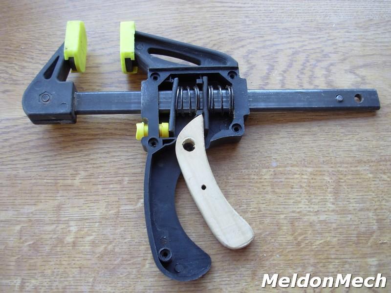

     I have had half a dozen plastic and steel ratchet camps for quite a while now. They were originally bought when I was building the conservatory.  They were never top quality but were available when I was in desperate need. Recently one expired, so I removed five retaining screws and opened it up, and found the plastic ratchet lever/ handle had lost it's nib.

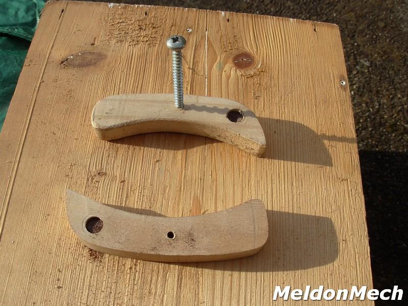

      I made a hard wood replacement to see if that would work and it did, quite well, so decided to cast some in aluminium.
Re: Ratchet Clamp Repair
« Reply #1 on: March 30, 2015, 03:09:15 PM »

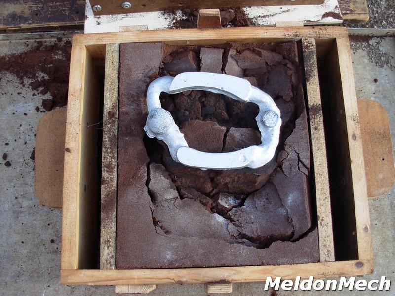

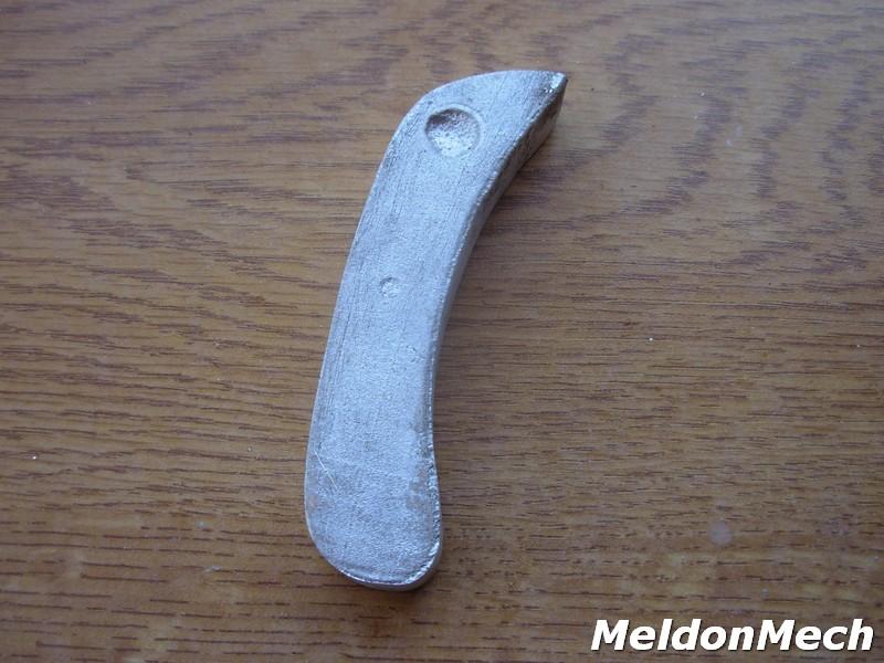

     I made some patterns, and on a recent sunny day when converting scrap into ingots decided to make some moulds for the handles. A couple of handles where cast.
« Reply #2 on: March 30, 2015, 03:12:51 PM »

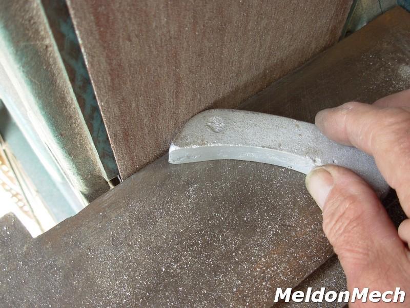

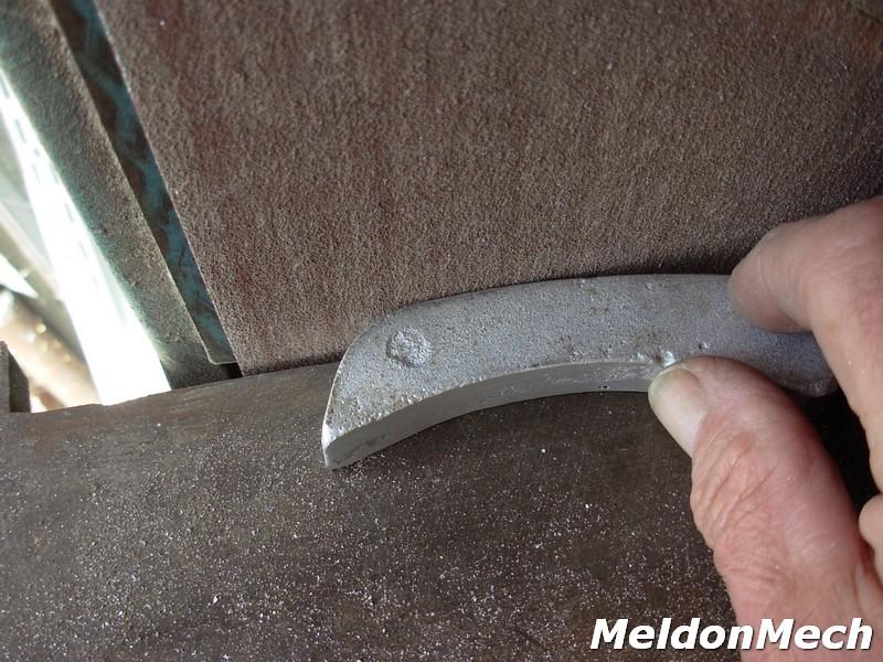

    The surplus metal was sawn off,  then the castings were fettled on the belt sander.
« Reply #3 on: March 30, 2015, 03:19:33 PM »

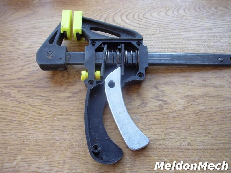

    The handles were then drilled, and finished filed to final shape, with corners removed for comfort, and given a trial fit. The ratchet worked well so the cover was replaced, job done.  Only five more to go.
