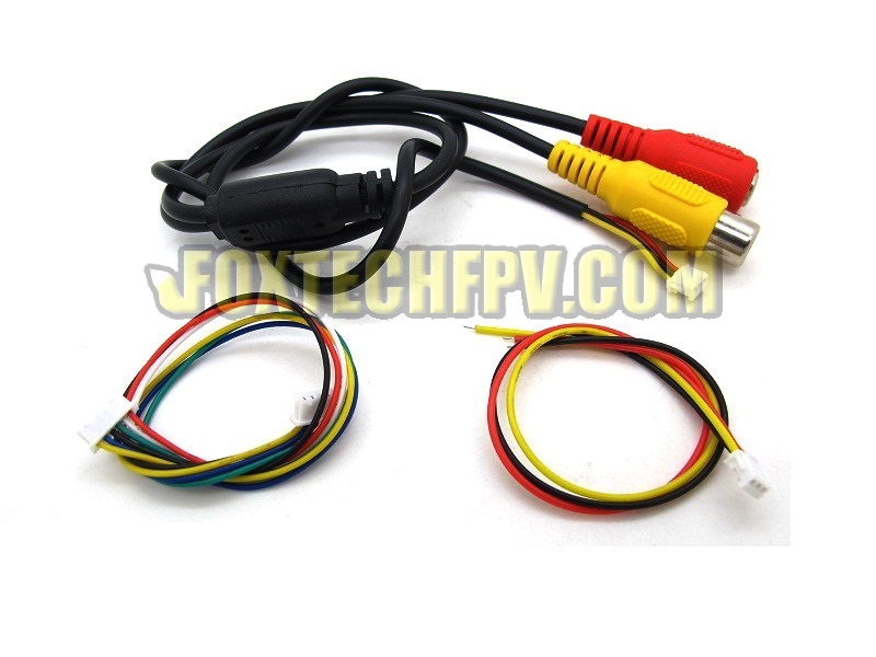

« Reply #5 on: May 22, 2015, 08:23:04 AM »
A little progress and few changes.
I'd like to get away with minimal amount of hanging connectors. The original camera has annoying short cables.
It has two inline connectors:
1) One connector for OSD menu buttons. I don't need this for anything else than for setup, therefore I'd like to keep original cable harnes intact but I'm not planning to use it continually.
2) One four pin connector that has power, ground, video and audio, that I will not use.
Is there somewhere ready about two metre video/power cable like this?
http://www.foxtechfpv.com/product/FH32/3_wm.jpg
Or what is that white JST/PHR type connector and I will make my own?
Distance is about two metres for video/power signal I think normal shielded instrument cable will do? Or is there better suggestions? I would like to get away with one cable sticking out of the camera enclosure.
