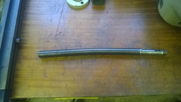

rob :- it is indeed a chester 626, unfortunately I believe it tried to roll off of the forklift and broke its foot casting and bent its knee screw. :(
That will do it every time Burtie  :Doh:  , what your plan for fixing the bent Z axis  screw ?    , I think I still have a one lying about some were  :scratch: yours if you want it  :thumbup:

plan to fix the bent screw??  bend it back ;)
thanks for the offer rob, I may well take you up on that. though I am also thinking of adding a riser block, so may need a longer one.

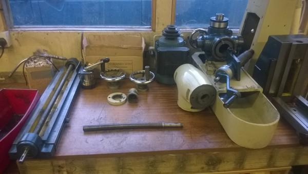

Well after a couple of hours on my own in the rain iv managed to get it all into the workshop and onto the bench.
Now to start cleaning, then work out what to do about the base

hopefully these pics will be a better size, think I've done it right
managed to spend a few hours cleaning today, used up most of a can of ipa!

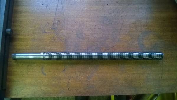

also managed to straighten up the screw by holding it in my vice and having a short tube on the other end. didn't take much effort. though worryingly the workshop wall seemed to be moving :S
Re: milling spindle upgrade
« Reply #14 on: March 28, 2015, 04:20:25 PM »
I think you got rid of the barrel distortion when you photoshopped that second pic of the leadscrew -- excellent!
amazing what can be done with a computer isn't it!
