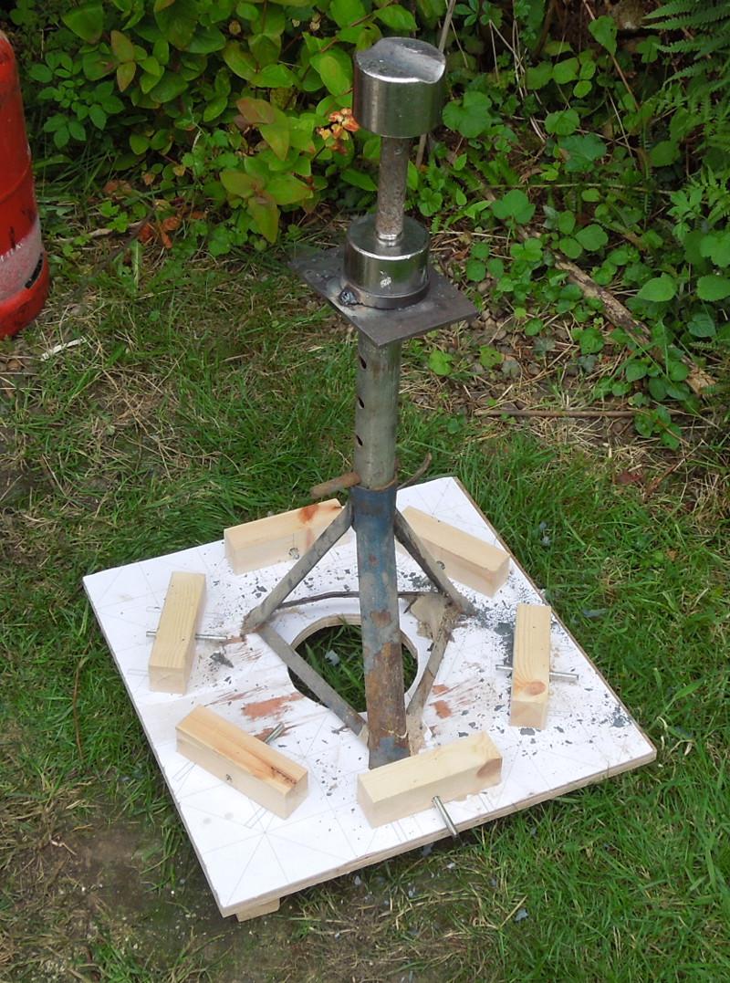

I always wonder if there's some sort of solution for gripping awkward parts in a vise like this. If I had more space i'd consider making a vise pedestal, filled with concrete and anchored to the floor, to give more space below the vise where the jaws overhang.
I also solved the head spatter problem by putting the face shield on, with it lifted up to cover my head.
Job done. I might punch the slag out of those holes just in case it interferes with the case hardening. I'm also considering putting a sort of trim around the edge, to give a better space to fill with the fire clay.
It's kinda silly how proud I feel about this ugly welded tube.

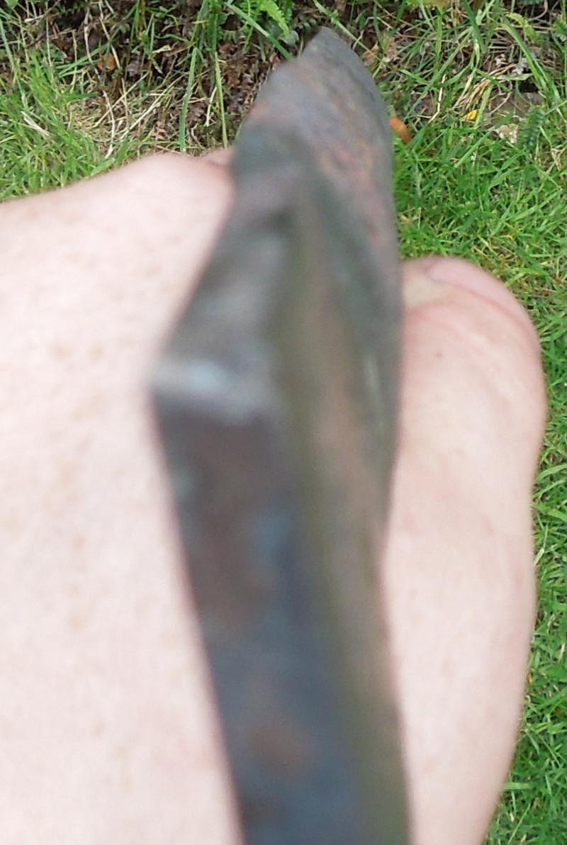

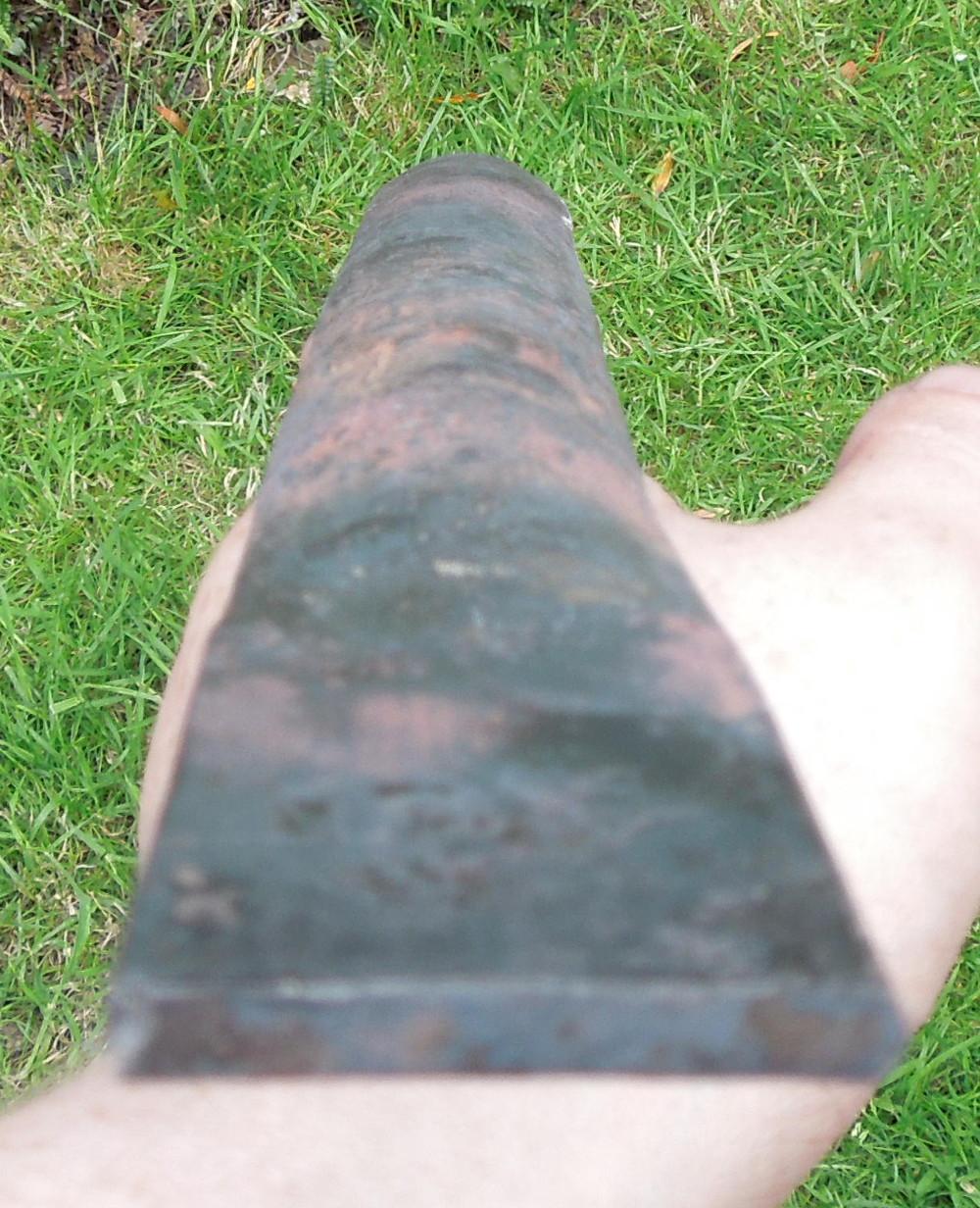

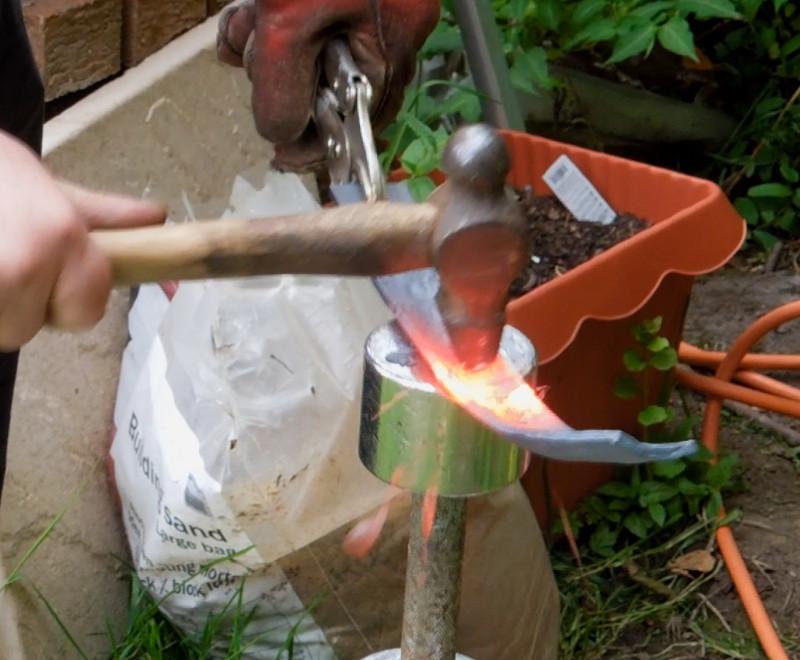

Forging.
Was alot of work shaping this, since it's the classic case of if you move one thing the rest moves too. Lots of back and forth trying to find a satisfactory medium and get it close enough.
I went around the garage looking for something to make an anvil stand from. At one point I was considering welding a small temporary extension to the bottom of my metal melting furnace, but I found these... car holder-uppers that haven't been used in 20 years. Not since a younger me managed to accidentally drain the oil from the hydraulic jack. It worked very well.
Got the thing close enough. The tang end is twisted but most of that will be easy to correct when I cut the tang.
I spent alot of time working the transition from curved to flat, trying to get it straight, to the point that the metal bulged out. I think really I probably should've just made the whole thing curved to make life easier, but you don't get alot of time to think when playing with hot metal!
