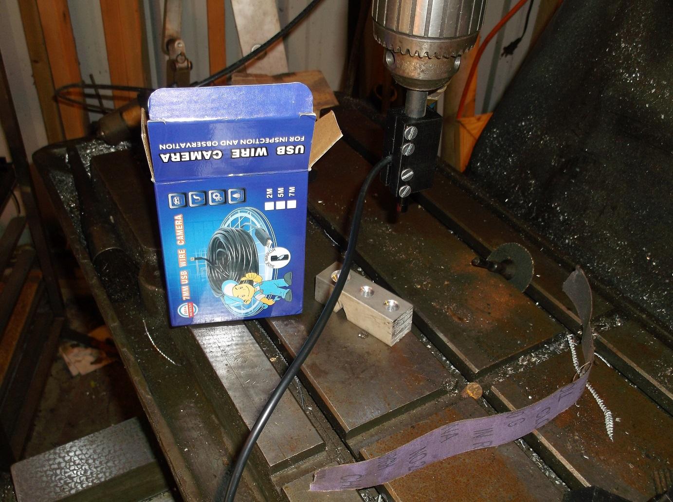

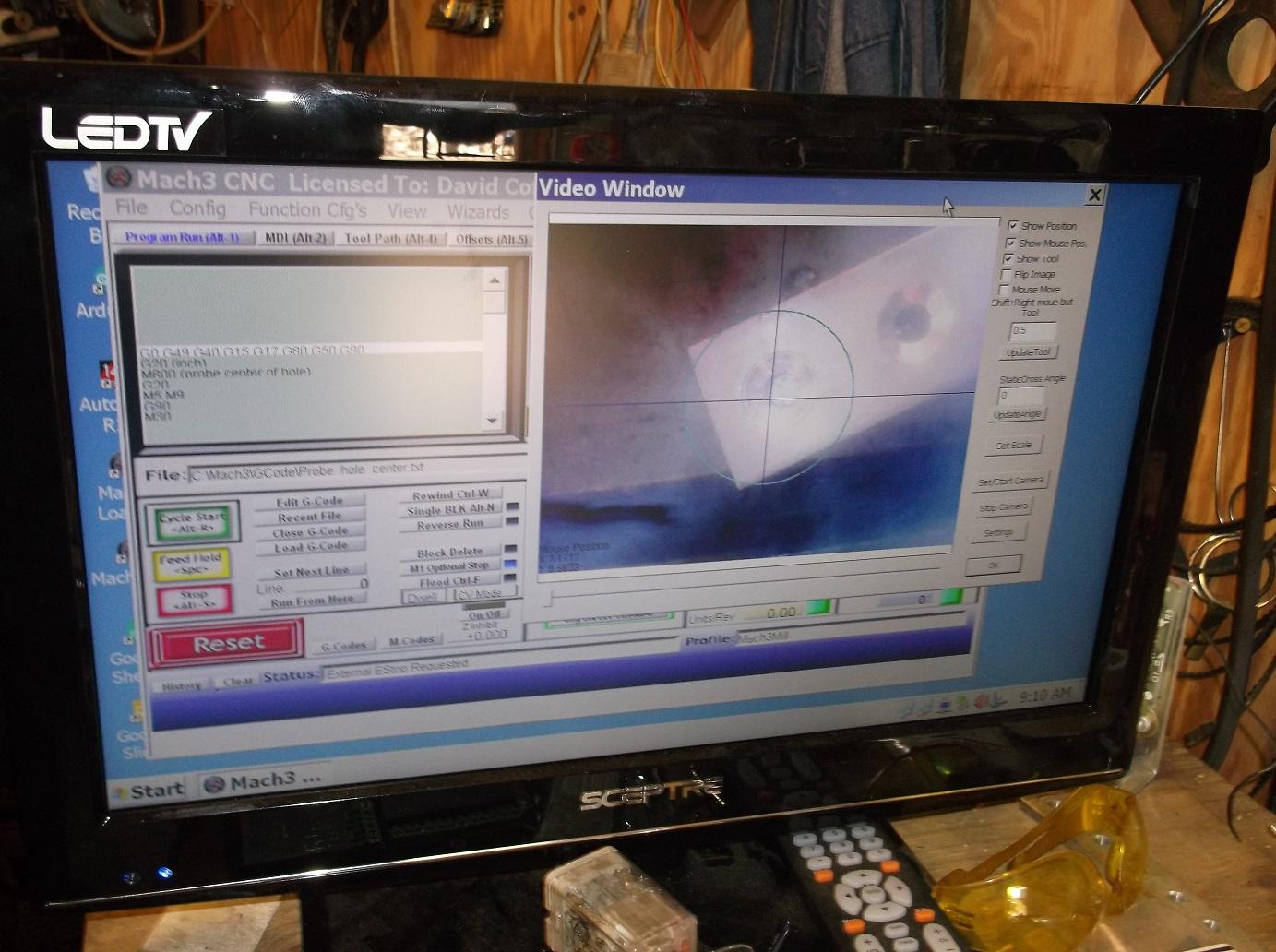

I first came up with one of these around 2001 (I really don't know or care if I invented it), Art incorporated it into Mach3 later.  Mucho better than my constant crashing one I was using a robo-vision driver for Visual basic 6. (I still suck as a programmer)
I printed it on the 3d plastic printer in PLA, created the model in Cubify Design 3d, exported it as a STL file, then printed it (twice, first time was too small so I had to reprint at 1.03% size)
Working great, I bought the snake inspection camera off ebay for $14.95 US Dollars (sent to China) Has a LED intensity knob there on the USB plug.. not perfect.. but nice.. A better design would have air purge to keep the lens clean.. and a laser cross-hair.. and a edgefinder made in.. and..
 FORUM WOULD not let me share the Stl, you can email me for it if you want.. it is simple, a block, 7.83 metric hole on one end and a .5 SAE hole on other end for the chuck dowel. A slot for the cable to come out.
