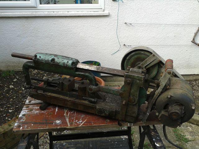

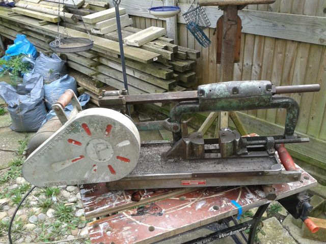

I have managed to get hold of this Portee hacksaw, portable it aint (more like a 2 man hernia job).
Small enough for my small workshop.
Complete with coolant sump and a pump that seems to work off the crankshaft.

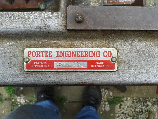

Never heard of this company, has anybody had one of these good/bad.
A project in the making.
John W

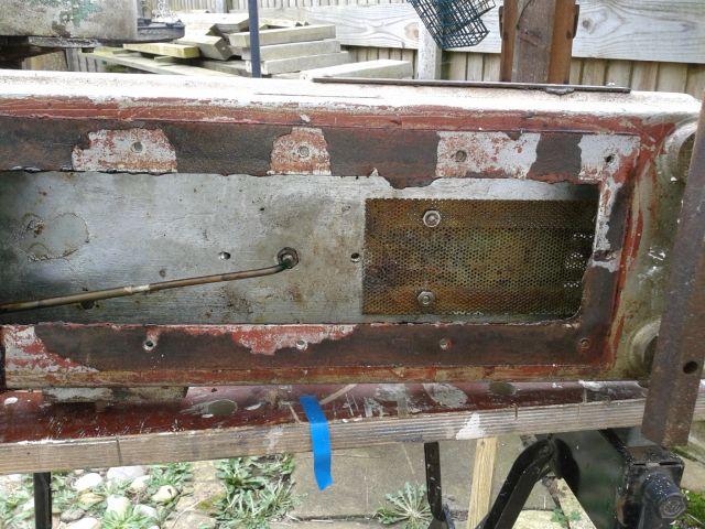

VT, the motor runs quite well considering the state it was in when I found it, I have scraped a lot of detritus out of the sump, the motor runs very quiet. I do not know the age but as you see by the pictures it will need some TLC (tender loving care) to bring it back to life.
The cut is square and true so no worries on that count.
I will post progress as I go.

  Baron,  I have never heard of this company still a little treasure all the same, I think we will use the word portable with tong in cheek.

Also today phoned a long forgotten tool supplier in Gosport :Doh: he has the sizes I want. Apparently a 13" blade was never made so fingers crossed.
