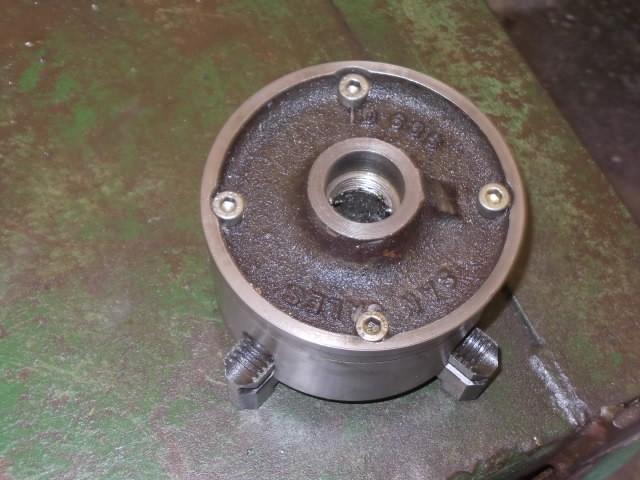

What Baron said about using a barbell weight is great advice.  Get one that is similar in size to your chuck.  All thread on type chucks will have some sort of register that keeps things aligned.
When cutting cast iron on small machines like the ml7, I first use a burr to remove the skin, a lot less hassle than chipping a carbide insert.  Externally I use a grinder and remove the scale by hand away from the lathe, less mess better machining.
Offline petertheterrible

This one is made from a castor used on trolleys to hang beef carcasses on.  Bought about 100 of these trolleys and have found many uses for these wheels,and trolleys/cages themselves.  Threads are single pointed for a myford ml7.  Just one way of doing it.
