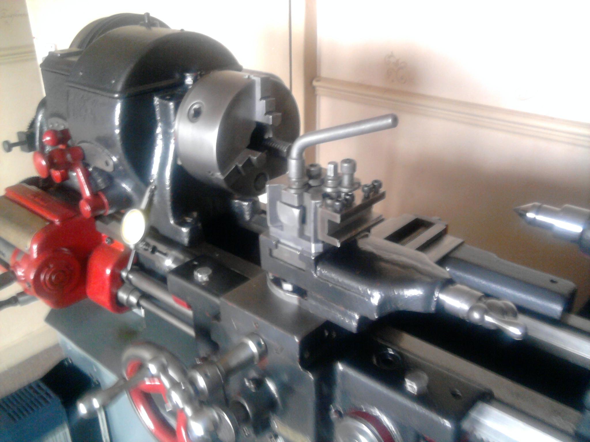

Hi,if you lived in England l would offer you this machine its rated highly in America but ignored in this country,every bit as good as the Boxford but at Auction they make peanuts whilst the Boxfords make fortunes.I was told by my American friends that these are a joy to be worked on, and they are a very smooth cutting lathe highly underated but l think its simply lack of knowledge about this machine.Its a 10ins Leblond Regal aged 72yrs old gears are imaculate and out live any owner
Re: Building a New Lathe
« Reply #351 on: July 29, 2015, 03:22:23 PM »
HI Trapper, thanks for the thought! Yes indeed LeBlond's are highly rated over here. I once secured a large newer LeBlondfor the firm I worked for and transported it in a big rental truck during a massive snowstorm from Rochester, NY to Vermont. Full day and evening there and back -- quite a ride!!
Of course I'm enjoying building my own lathe by now -- taking a break from it during the summer, but will pick it back up when the weather cools. Tons to do right now outdoors.
Thanks for the thought though, and it certainly would be a nice acquisition! :thumbup: :beer:
