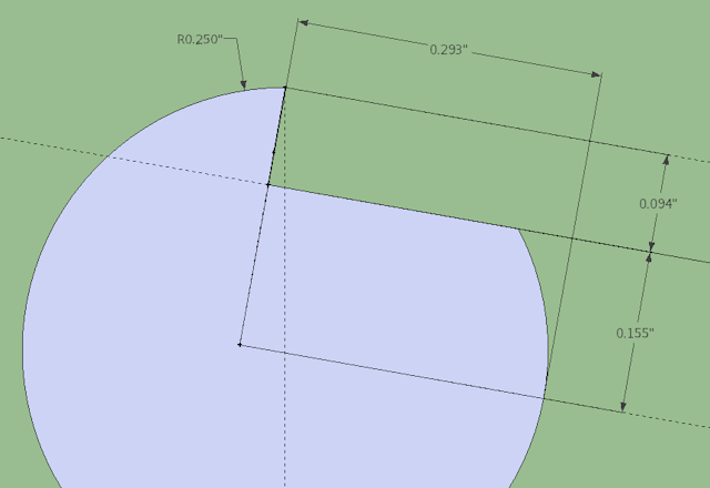

Things don't always go well, of course, I had a disappointment this afternoon in trying to make a tap for acme 1/2" - 10 TPI. These cost $50 if you can find them. That's hard to justify, especially since I need to save for a chuck eventually.
So I've been collecting info on tap making.
I tried a method I saw on another forum after a web search, which showed a tap made by simply grinding 4 flats at the end of some threaded rod, set at a taper of about 30 degrees. This just didn't work for me. I tried it with various angles, and unhardened and case hardened (with kasenit) on a scrap piece of aluminum, I simply couldn't get it started. It would just chew up the aluminum and wobble out of line. I don't know what I was doing wrong.
Seems to me the thread is just too coarse for this kind of tap, even though the reference I read said acme taps made that way had been successful. The picture though in the post was of a very fine thread 60 degree tap, and the example had cut into brass, which I think would thread much cleaner and crisper than aluminum.
So tomorrow I will probably try again, but this time attempt a conventional machined tap, turned on the lathe to an entry taper, with flutes, and some rake angle.  And I'll case harden it from the start.
So, fingers crossed it will cut zinc alloy cleanly.

Steve, tapping coarse acme threads, I've always bored and threaded them undersized in the lathe then used the tap as a finishing pass.

Notice that the chart shows the tap rake angle as low as 0-3 for cast iron, and relatively low for brass (just as we typically reduce top rake angle for lathe tools, and flatten drill lips for that material) but relatively high rake angle for aluminum and zinc die castings.
That makes me think that the first tap I made, following the old style 4 bevel end on a coarse thread produces a very low rake angle, and while it might work for finer pitches in brass (as shown on the forum post I saw) or cast iron, would definitely not work with coarse acme in aluminum.
Since the ultimate use will be on zinc, I'm going to say a 10 degree tap rake angle would be minmum, according to that chart.

Thanks Pete, will try making one before buying -- pretty sure I can get them here, if need be. Right hand, so not too unusual.
I've been playing around with a drawing and one way of cutting the flutes to get a 10 degree angle might be to just offset an end mill from center and cutting to a specific depth -- at least it works out on "paper."
In this case, bring the edge of the mill in .155 from center, then mill to .293 depth. That should yield 10 degrees tap rake angle:
(Interestingly, the .293 depth determines the rake angle, the .155 just determines how much clearance you get -- I just guessed .094" might be enough for the tooth depth. Tapering the end of the tap just reduces clearance, but doesn't alter the tap rake angle  -- it is determined throughout by that .293 cut.)
There is no backed off relief in any of this -- hoping it will work well enough wihout it -- fingers crossed....

Cutting:
« Last Edit: July 11, 2017, 03:50:36 PM by vtsteam »
  • Posts: 6835
Re: Building a New Lathe
« Reply #216 on: May 07, 2015, 12:48:02 PM »
Fluted and stub squared:
« Last Edit: July 11, 2017, 03:51:05 PM by vtsteam »
  • Posts: 6835
« Reply #217 on: May 07, 2015, 12:49:22 PM »
Case hardened and tempered:
« Last Edit: July 11, 2017, 03:51:33 PM by vtsteam »
  • Posts: 6835
« Reply #218 on: May 07, 2015, 12:51:10 PM »
Test cutting some chewey aluminum scrap:
« Last Edit: July 11, 2017, 03:51:59 PM by vtsteam »
  • Posts: 6835
« Reply #219 on: May 07, 2015, 12:52:52 PM »
It works!  :thumbup:
« Last Edit: July 11, 2017, 03:52:23 PM by vtsteam »
  • Posts: 9051
« Reply #220 on: May 07, 2015, 01:34:17 PM »
Excellent Steve - and the zinc alloy should tap (hopefully) even better. What sort of finish did it leave on the aluminium?
