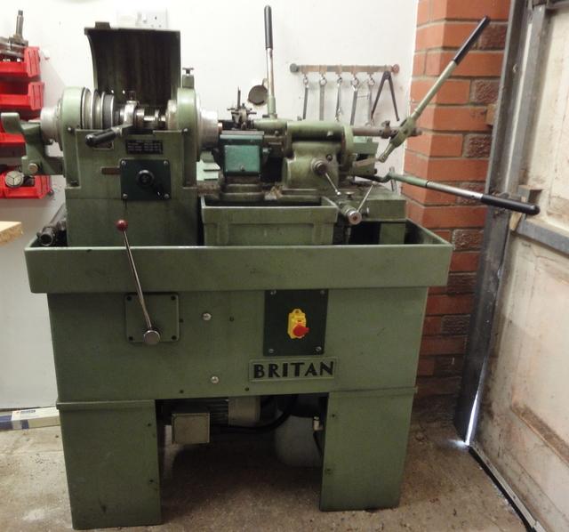

 I had been looking for the later version of this lathe for  a while. Originally they were first made during WW2 and most that survive are the blue painted 3/4" versions. Nearly all of them have lead a hard life, producing maybe 3-400 turned parts a day for years. The one I purchased is from the early 1970's and is the squared off version painted light green.
Electrically all Britans had a three phase  two speed reversing motor and stepped pulleys  to give a reasonable speed range. Later ones incorporated a long lever at the front left which was a high/low mechanical speed  clutch.
The motor on this one had been replaced by a standard single speed three phase  one and the speed switch with a  rotary fwd/off/rev switch. A geared auxiliary motor drives the compressor for the bar feed, the hydraulic pump for power feed and the coolant pump.
The lathe itself was in rather a mess but showed little sign of any hard wear and had been stood idle for a while.
Some of the things I learned may be of use in general repair and renovation. Attached are a couple of pictures.

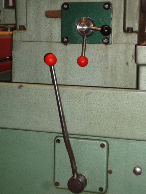

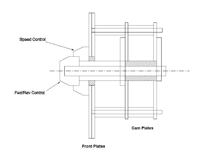

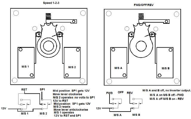

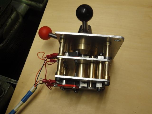

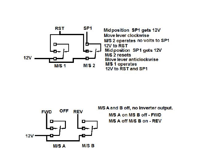

I wanted to return the controls to original as much as possible, so I made up a coaxial Fwd/Rev speed change switch. Details attached.
The motor was  standard 3 phase and delta connected1.1kW, 1420 rpm. The VFD a Teco E2 40 3NF rigged for 240 volts input.
The easiest to understand programming details were at :-  http://www.teco.com.au
Sorry, I am not very good with explanations but for those of you who are familiar with setting up VFDs, this is what I did.
Programming F19 = 2 and F20 = 6 allowed me to set F08@20Hz, F26@35Hz and F27@50Hz. This gave me three fixed speeds, so with the mechanical High/Low clutch, there is a choice of
six speeds.
Ian

So another couple of photos.
The black control is for fwd/stop/reverse and the top red is for the VFD speed change selector. The lower long lever is the mechanical clutch high/low lever. Speed range is from 60 - 2000 rpm without changing any belts. Being programmable, the speed range can be altered if a special need arises for a production run.

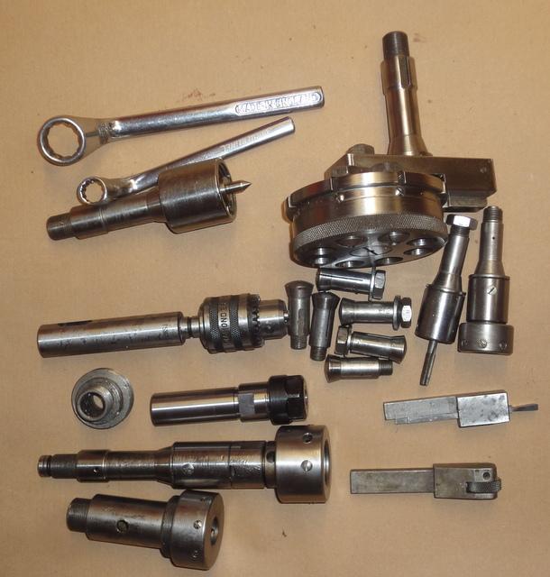

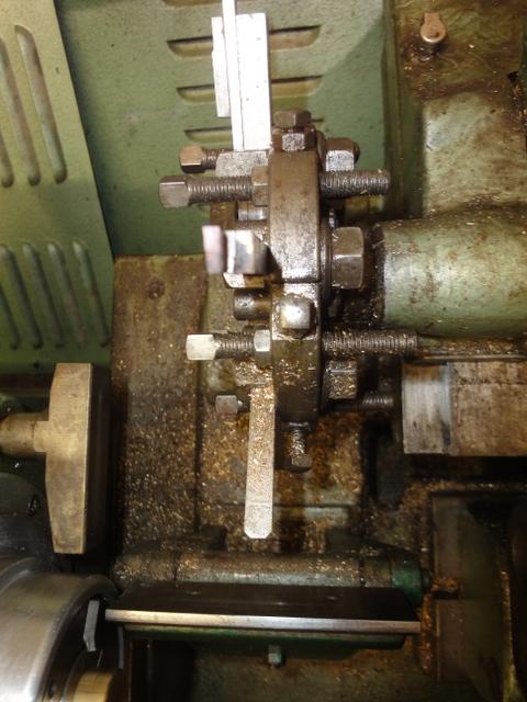

Tooling photo shows the tailstock turret with tap and dieholders. Main tailstock holders can have larger drills, taps and dies, drill chuck, ER collet chuck or live centre.

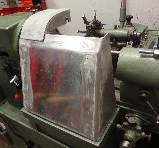

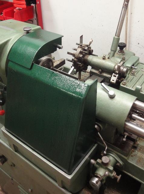

The original had a cast aluminium coolant and swarf guard which was missing on this machine, so I decided to make one from 3 mm sheet aluminium. I solved the corner problems using a 19 mm x 3 mm wall tube and cutting them on the lathe with a parting tool mounted on it's side. The sheet was cut to size and I used BrazeTech solder to join them all together. Quite solid. There was a splashguard cover with a plastic window originally but it got covered in coolant - it was not very good, so I did not try to put in a window. I undercoated them with Hammerite Special Metals Primer then Hammered Dark Green.
