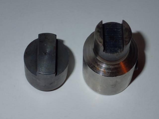

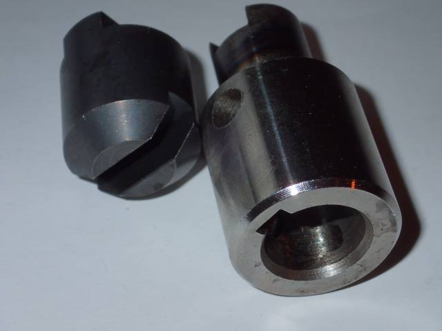

There is a miniscule oldhamn coupling between electric motor 1500 or 3000 rpm and 0,55 or 0,75 kW. The coupling part is really small 14/10 mm diameter and looks like hardened steel.
What kind of grease goes for it?

Jeah, I know what you mean. I do have some very adhessive grease that does not separate, but NLGI is only 1, it's not very viscous. I think that pressures are very large, but movement is very small even close to fretting/scuffing.
Effective dia is only 13-14 mm and "key" is 4,52 x 8,00 mm and 7,1 x 5,12 mm.
Electric motor shaft is D14 mm and key 5x5 mm.

Thank you for the ideas.
Got 10 ml of Klüber ALTEMP Q NB 50 assembly paste from machine shop. it should do the trick.
