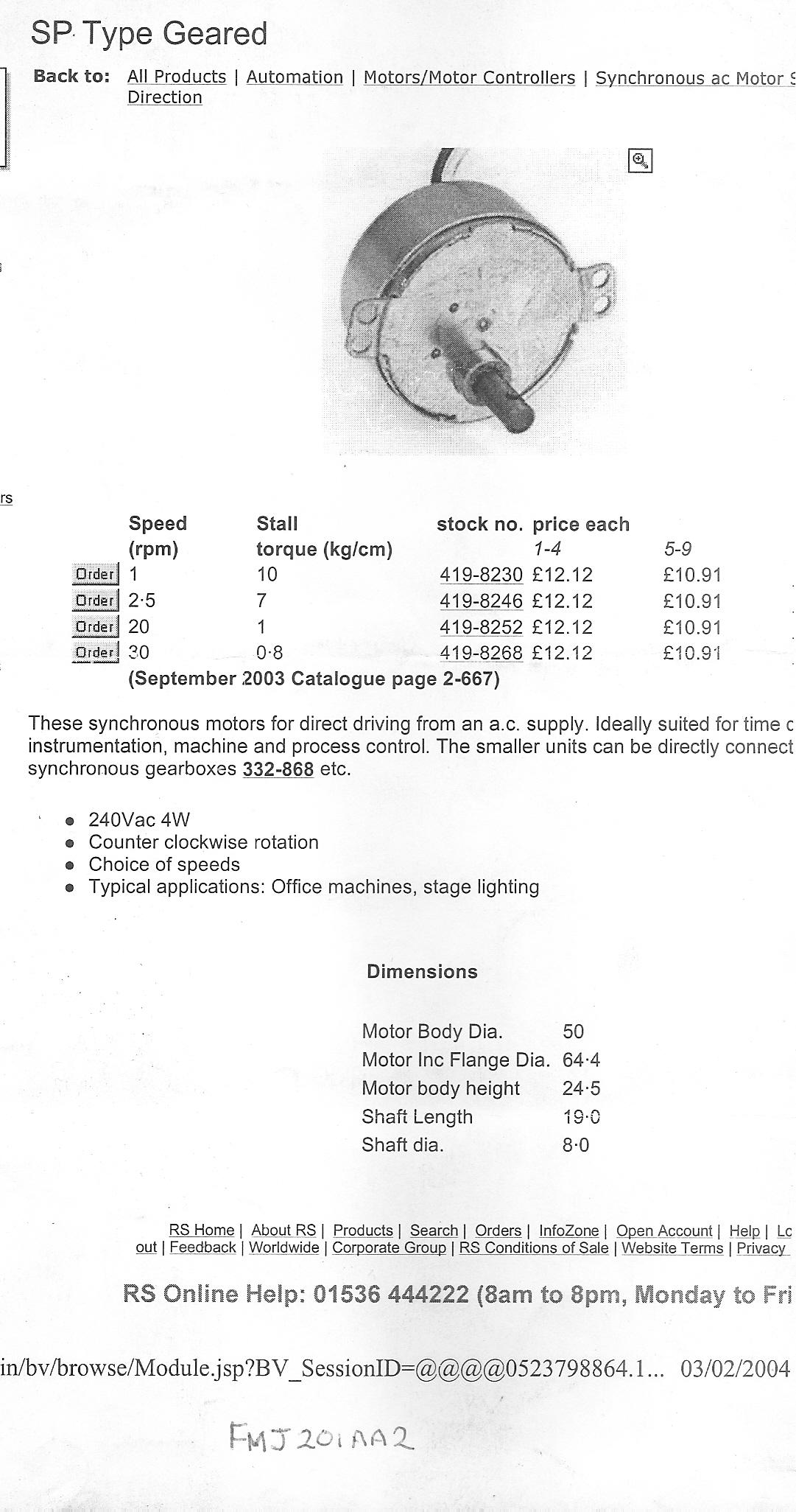

Hi again Dave,  Here is the info on the motor for what it is worth. Looks like it is a geared jobby, as there are various speeds available in the same housing. I chose this one because of it's nice compact size.
The only other info I have is a drawing with all dimensions shown, no electrical spec, or gearing info.
Hope this helps.  Cheers Dek.  :med:

Not sure if this helps you ......my son and made a clock using a stepper motor and 12 LEDs....driven by a pic micro ....the LEDs were for hours and the sweep hand minutes...all battery driven...no inverter needed just in case you change the motor..
But back to your orig....if the inverter uses a sq wave then as Dave says, the motor might sing a bit...maybe some sound proof material might help if its too loud...

Hi Dek,
I think this is the right motor:
http://www.ebay.co.uk/itm/REPLACEMENT-MOTOR-4W-1-RPM-CW-DJ-DISCO-KARAOKE-LIGHT-LIGHTING-/261783348199?pt=LH_DefaultDomain_3&hash=item3cf380e3e7
£5.99 inc delivery!
I can't advise on using it with a 12v to 240v inverter but I have a 150w unit somewhere (I think in the caravan which is wrapped up for the winter). If I find it and have time I'll have a look at the frequency and see how it will drive a similar motor.

Hi Dek,
I've retrieved the inverter from the caravan and have connected it up to a DC power supply and to a synchronous clock which has a seconds hand.
It must be running at slightly less than 50Hz because 5 minutes on the clock took 5min 4.45secs on my stopwatch so it's not too far out to demonstrate your clock. There were no untoward noises from the clock and no noticeable rise in temperature. I'll leave it running for a few hours.
The inverter is taking 0.5 amp at around 13.5v. It has a cigar lighter type connector so would need something rigging up to connect it to a battery. I've got it connected from my power supply with crocodile clips.
