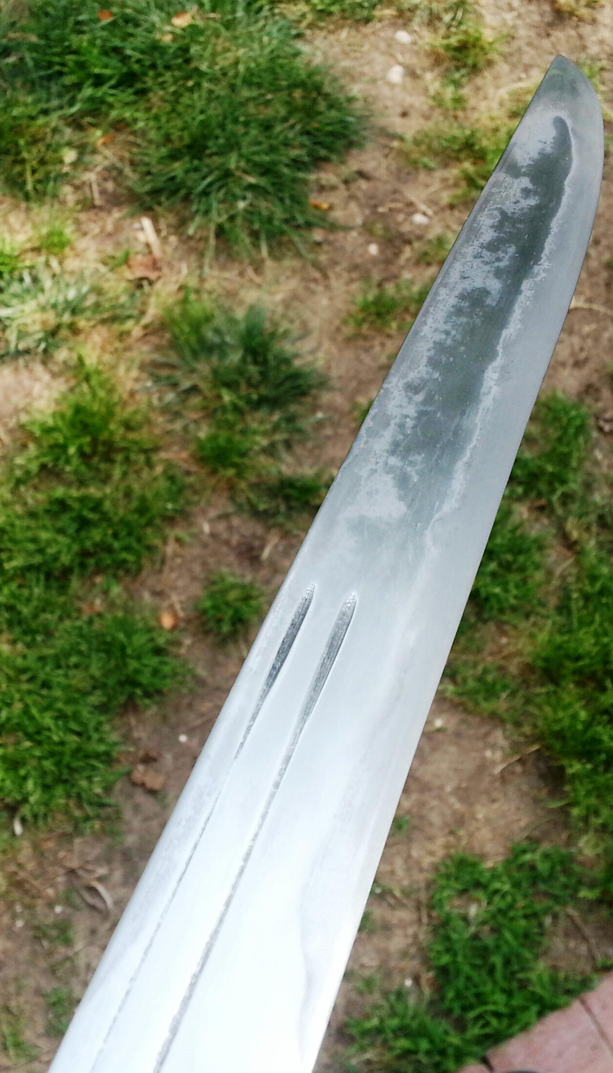

Japanese style. I have only a small farriers forge and no way to smelt iron ore to make Tamahagane. Happy for now to do stock removal on both 01 tool steel as well as 1080, the latter giving me some kind of hamon, but nothing to write home about, and now, I was not going for all that mune-yaki. ;0
Here is a pic of a recent tanto like object (TLO). The high were done in haste with angle grinder. Now trying to use a scraper approach using a lathe bit in a guide.
Regards

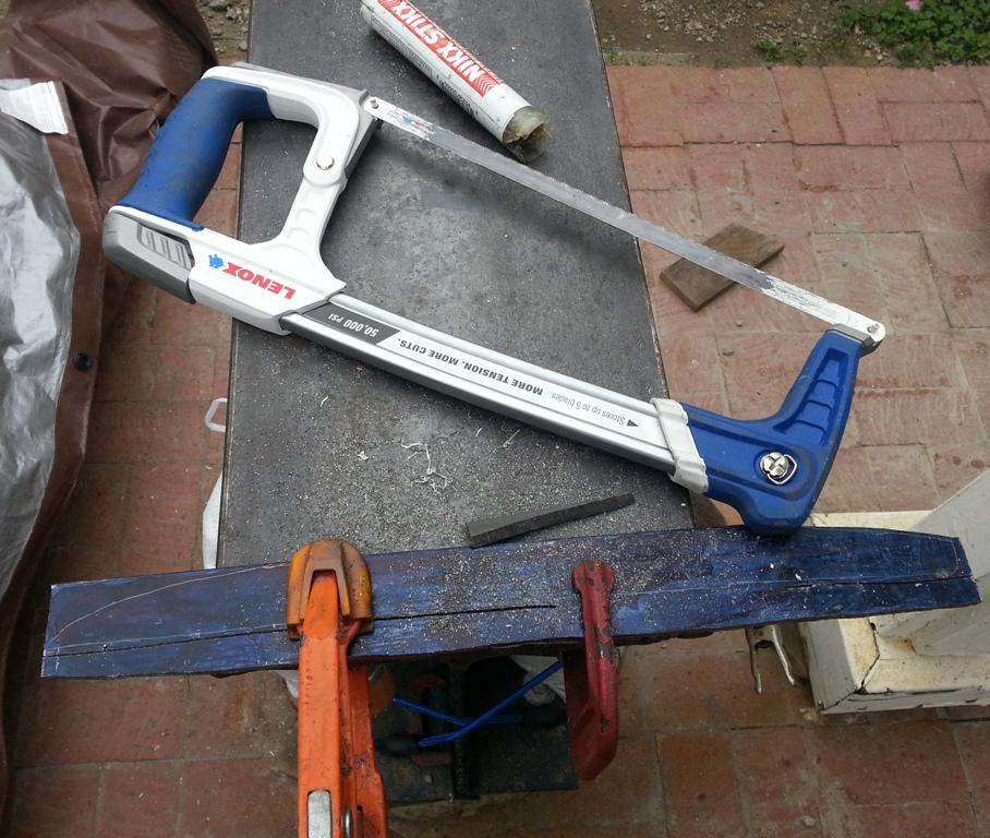

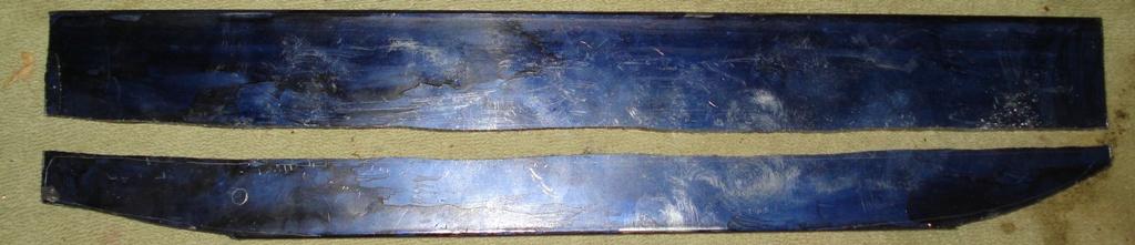

Added some more pics so you can see the "bear skin and stone knife" (added geek points if you get the reference) tech I work with. Only recently got a cheap belt sander. This all done with files and angle grinder. Hoping to get a Sherline lathe soon and try to step this up.
Hack saw to rough out the 1/4" blank, clay, and forge. Hope admins don't mind the pics. I know this is not a blade forum, of which there are plenty; its just showing some of my more recent work and stronger passions.

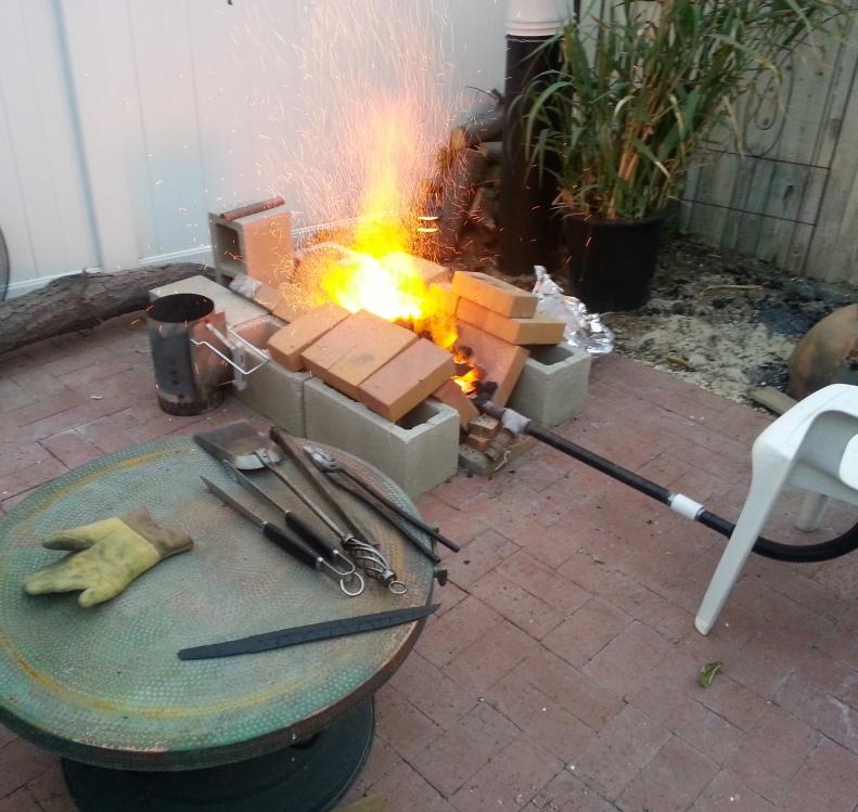

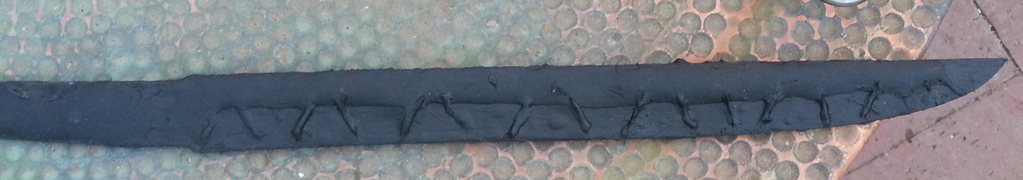

To be clear, I do stock removal, but have a small forge to play with. The brick forge was needed for heat treat and could handle up to 30" blade, but so far the longest I have attempted was a wak at ~ 26"
I quench into both water and/or oil depending on the steel and if I want a temper line/hamon. For 01 tool steel I use tranny fluid (canola oil would be better, as would parks 50 or such, but I try to work cheap and got used atf at a local shop as I needed about 10 gallons). For 1080/w2 I have used just water but had cracks, so now do an interrupted/hybrid approach that has the blade first go into warm/hot water (with some salt added) for 3 seconds and then into oil until cool that seems to help.
The hybrid quench gives the initial fast cooling needed to beat the "nose" in the phase diagram and thus get martensite on the thinner sections/unclayed areas, while then giving it a gentler finish to help ease stresses. Oddly, seems that the cracking tends to occur 5-7 seconds into pure water quench long after the hamon has formed. I tend to unclay the spine as well to help avoid added sabering/sori/curve. Thus I shape in the curve during stock removal which has its own limitations.
I then use a hybrid polish of files, sand paper, acid etch, polish. I did try using Japanese water stones but too expensive and gave me arthritis in the hands. ;)
