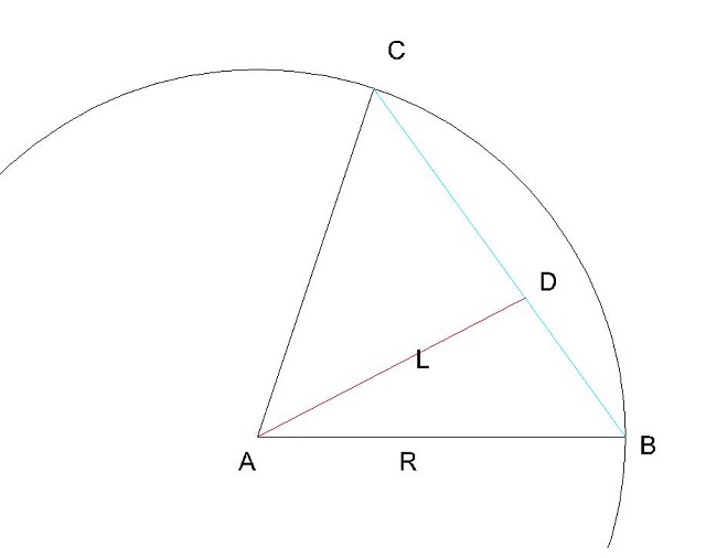

In the attached drawing I need to calculate the length 'L' (line A-D) that runs from the centre of circle radius R to intercept chord B-C, where the chord subtends angle B-A-C and the unknown line is at angle B-A-D. Note I need this for any angle B-A-D, not just for the line intercepting at right angles :(
Why do I need this? Think Traub CNC Lathe : The circle represents a part in the chuck in the main spindle. The line L is in the direction of the X axis of the lathe - ie tool in or out, and the tool will be a milling cutter rotating with its axis parallel to the main spindle. The main spindle will progress round the circle using it's precision 'C' axis for positioning, and the X axis will move in and out producing a flat on the work represented by the chord B-C.
I want to produce a general purpose algorithm for work of varying diameter and varying chord lengths.
Any help from the less mathematically challenged than I would be much appreciated  :thumbup:

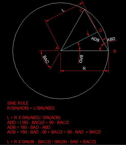

angle ABC = (180 - BAC)/2
angle ADB = 180 - ABC - BAD
Then:
L/sin(ABD) = R/sin(ADB)
so:
L = R*sin(ABD)/sin(ADB)

« Reply #6 on: January 31, 2015, 11:25:40 AM »
Andrew,
Maths was always my favourite subject and it's nice for someone to set such a brainteaser.
Try:
L = (R x sin(90-BAC/2))/(sin(90+BAC/2-BAD))
My first effort had one too many "/2" in. I have now checked it with a spreadsheet and an Autocad drawing.
Hope that's what you needed.

Andrew -- Is there a reason yoiu cannot make the line "AD" perpendicular to the chord "BC"?  If you are coming in with an endmill to mill that face, would it not need to be perpendicular to cut the chord line smoothly?
If that is the case, then angle "BAD" = angle "CAD" and the only "issue" is deciding the subtended angle "BAC."

« Reply #13 on: January 31, 2015, 12:27:56 PM »
Thanks Phil,
You are working on the lines I need - no pun intended  :thumbup:
Andrew - I thought a diagram might help. Phil

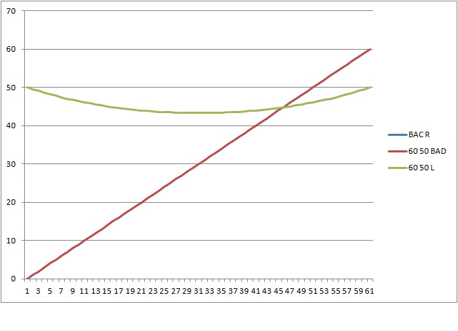

Re: Trigonometry Homework for the Maths Gurus: Please help :)
« Reply #15 on: January 31, 2015, 02:42:06 PM »
Phil you've come up trumps again, many thanks  :bow:
Phil sent me his spread sheet, and sure enough when plotted, running the rotation angle against motion ie length 'L', it plots out as the segment of a circle as I expected.
Many thanks for all the support that you all have given me  :thumbup:
