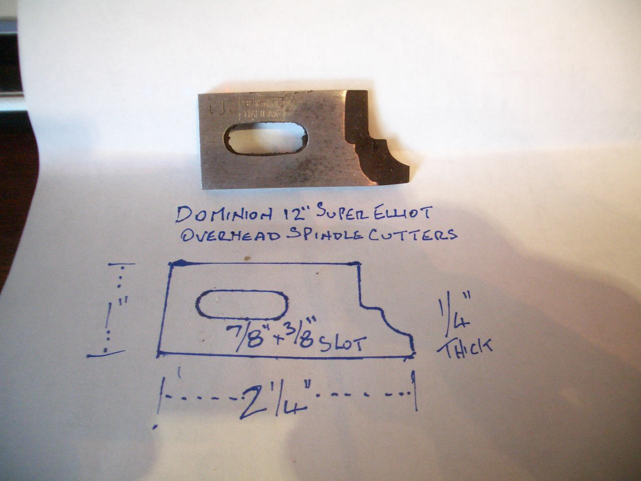

Where can I buy cutter blades for the overhead spindle on my Dominion 12" Super Elliot woodworker.
A web search has failed to tell me where I can buy these items, perhaps I am describing them wrong.
I attach a pic showing one of the pair of cutters I have at this moment, it has a 'Dominion Halifax' stamp on it.

I've never found a source since I've had my machine. A machine did turn up on ebay with a full set but it sold for surprisingly good money. I think manufacture from flatstock is the only real answer as all others I've found have a different retaining shape :(

I know that these are not exactly what you're looking for, but when I saw your pic I instantly thought that it looked very like Spindle Moulder Tooling, and I remembered that Axminster used to offer custom cutter profiles http://www.axminster.co.uk/special-profile-knives seems like they still do.
May be of no use, but perhaps there are other companies who will/can make up what you're looking for.

What a shame they are not 25mm wide, they would have been perfect.
But perhaps they are the closest I am going to get.

I would have thought that axminster specified that outline to suit the spindle moulders they sell.
I am sure they then send them off to a tool maker to make them. Said toolmakers could make anysize cutters I am sure!
Suggest you talk to Axminster and see if they would accept a different profile or at least give you the contact details of their tool maker.
If not find a tool maker near ou!
HTH Will

I would have thoght any good machine shop with a decent CNC set-up could produce what ever you want  :scratch:

It's been a 'back burner' project for me to cut them out on my Fanuc wire EDM machine - they could be cut to profile in the hardened and tempered state just needing final grinding.

What a nice toy to have. I made some form tools from gauge plate for machining some multi tooth pinion cutters. With a wire eroder they could have been in HSS and I could make much smaller ones than I could make with a 0.8mm end mill.
Going back to the original post and Cutters from Axminster - I suspect that 15mm isn't the total width of the cutter - only the width of the cutter that can have a profile cut into it.
