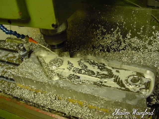

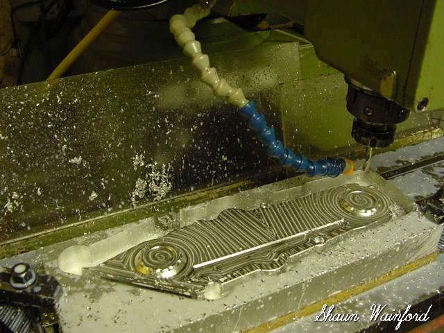

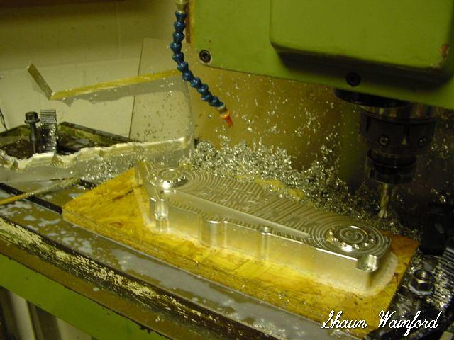

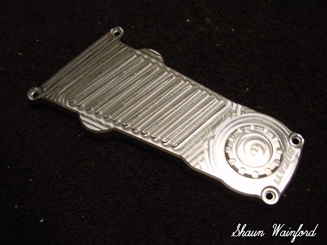

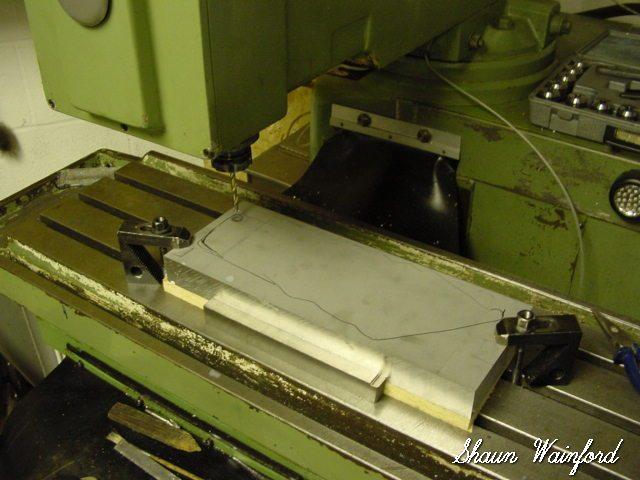

Its been a while since I posted anything, my excuse is I've been moving house and consequently workshop, I'm making these as a test piece, these are for a mate's Ducati 900ss, he's turning into a Café Racer, should be a nice bike when its all finished, these are the first things made with the CNC miller at the new house, its been an absolute nightmare moving all my equipment, however at least its all up an running now.
This one is the smaller of the two and is made from 5083 20mm Aluminium plate the other part is quite a bit bigger and will be made from 38mm plate.....
I converted this miller to PC control back in 2004, it now runs Mach 3 and or LinuxCNC depending on mood and what I'm machining........
Any questions or comments welcome.

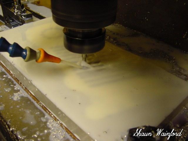

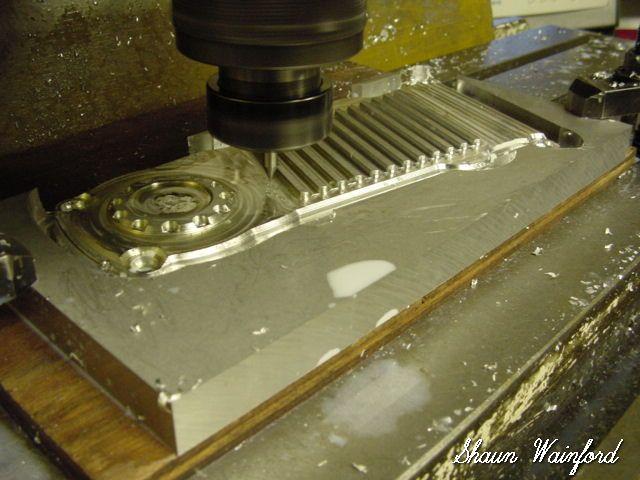

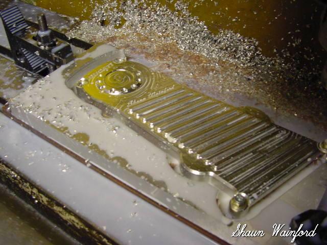

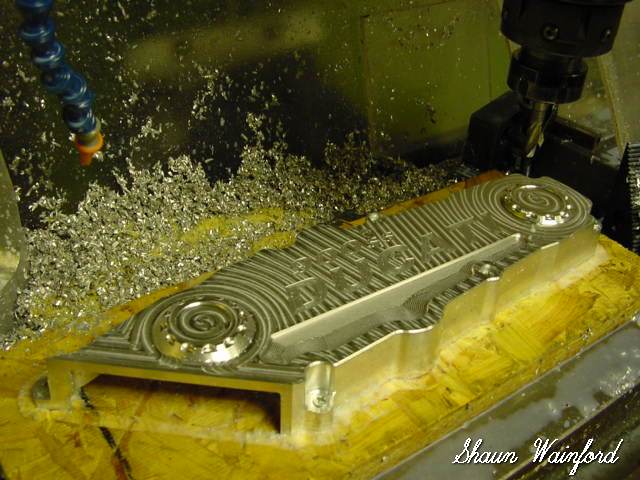

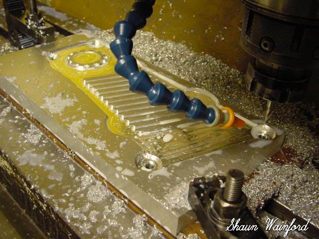

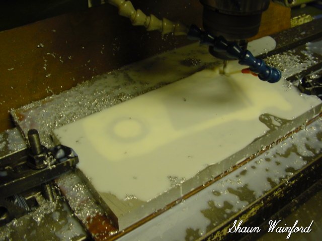

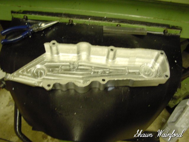

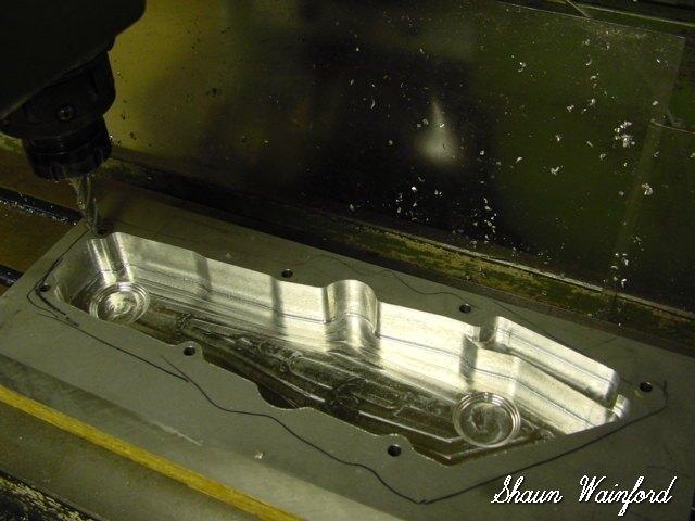

This is the second part of the belt Ducati covers, in fact this is the main section, machined from 38mm 5083 billet plate, its taken approx 3 hrs. machining time, 90% of the machining was carried out with a 3/8th x 1 LS tip radius cutter, the machining lines although visible are pretty much undetectable by touch, which sort of feels a bit spooky......

If you bead blast it, no one will know you cheated and failed to cast it :)
Really nice design you made there. Please post a picture once it is installed.

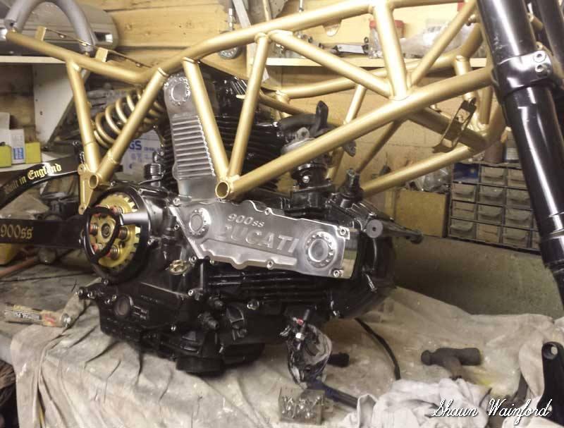

« Reply #6 on: January 19, 2015, 11:49:57 AM »
Test fit picture added above
