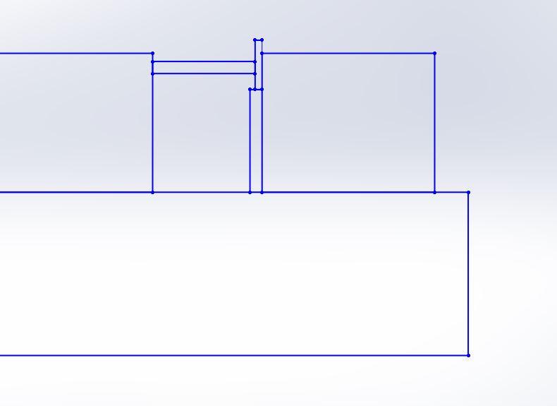

This one seems so obvious that I'm sure there are a number of you guys out there that use it already.  But remember that few things are obvious the first time around.
The problem is how you hold a very thin part on edge for machining, when your parallel is thicker than the part.  The solution?  Use another parallel (or anything else lying around) as packing between the part and the moveable jaw.  Of course, keep the part as low in the vice as possible and cut so that the force from cutting doesn't twist the part out of shape.  If extremely thin, you'll need to reduce your depth of cut accordingly so as not to damage the part.

Another aspect on this that I have a set of blocks that are thinner than my usual suspect parallel used to clamp the "top" of the part that are tapped 3 places in a "V" pattern.  Fit into those tapped holes are hex head cap screws that I turned the top face to a (convex) spherical shape that will support my parallel.  This reduces the need for as many arms as Shiva when making the set-up and supports the clamping parallel if I have to trim more than a single part!

It sounds good, as the setup is admittedly hard to hold.  Pictures would help though, as I can't quite envision what you're describing.
Sparky -- My vise & parallels are 6 inches long.  My widest parallel is 1.500 inches.  So, I take a piece of bar that is (say) .750 X 1.250 X 6.00 long and drill and tap three (call them) .1900-32UNF (#10-32) holes such that two are .200 from one longitudinal edge spaced at 5 inches centrally symmetrical and the third .200 from the other longitudinal edge on the centerline.  I fit #10-32 hex head cap screws that have had their heads turned to a slightly spherical radius (call it SR2.00 inches).  I now have an adjustable "tripod" that my 1.500 X 6 inch parallel can sit on whilst I have hands free to adjust and "fit" the part I am cutting off.
