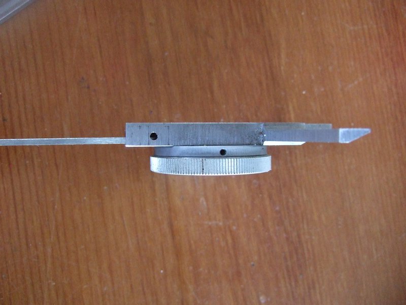

Bob, I have a cheap Chinese dial caliper that I've owned since the start of my metal working. So it's got sentimental value. Also it continues to work when my cheap digital calipers stop working, which they do for any of a hundred reasons. In fact it always works, and always seems accurate. It even works with no glass. It's easy to read in low light (white dial). I don't even know why I bother with the others.
The crystal broke (not my fault - gravity forced the wrench I was holding to fall out of my hand onto it......). So I thought I'd try your method of making a new plastic lens.
But I can't figure out how to get the bezel off!

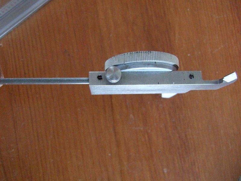

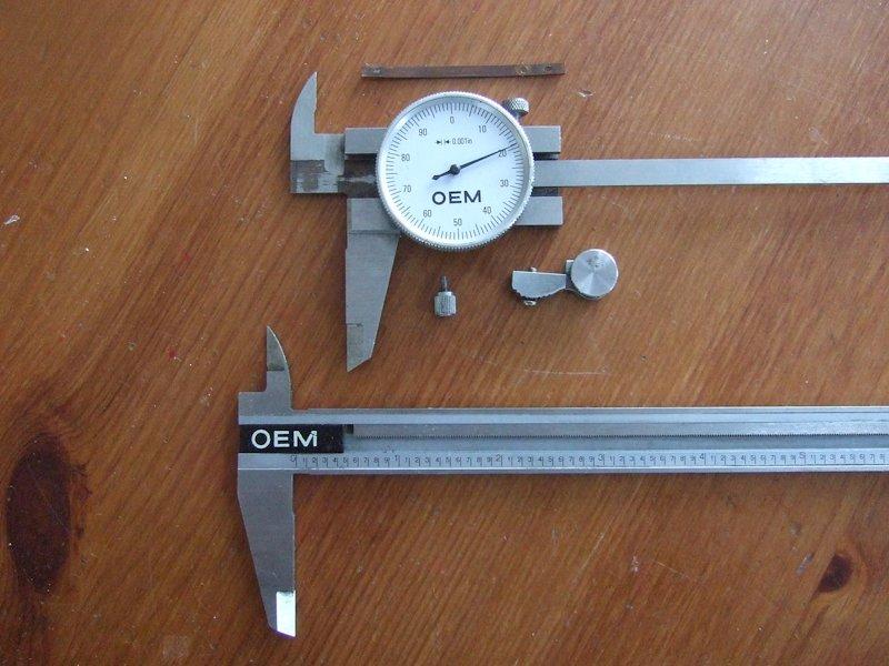

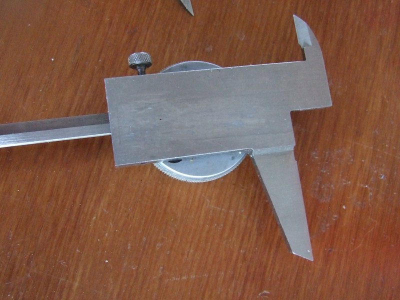

Woohoo I finally got it -- but not before a long trip to the underworld and back!
If Bob, if you see this, I'm sure you're gonna see those pics and say, Uh oh, why did you take that slide out of the caliper! :doh:
Well I stupidly thought that maybe there would be a clue to getting the bezel off hidden in the works.
But taking the slide out of a caliper is a no-no. Y'see there's these little pinion gears that engage with the rack on the slide, and they are 2 in number on this caliper, and the reason for 2 is, it's an anti-backlash setup, naturally. Backlash in a caliper would make it useless.
So the 2 gears are tensioned against each other with a spring mechanism, set to just the right tension. And when you take the slide out, you release that tension. so now your caliper returns to maybe zero, or maybe sometimes minus two thou, or maybe plus 5 thou, depending on how hard you close the jaws. So now the problem isn't just a broken crystal, but a plus or minus 5 thou caliper.
And the bezel? Well it turns out you just pry it off. No hidden circlip or spring, no hole to stick a paperclip down. Just insert a flat head screwdriver and pry it off -- on this caliper, only.  Don't try it on yours......
Okay I've got the bezel off, and the dial and hand are still on, and I figure out something is amiss because of inconsistent readings when I put the slide back in. So, dig deeper.
I pry up on the hand, and, pop, naturally it flies across the room. It's about the size of a pin, and it's somewhere on the wooden living room floor. I stop all traffic. And crawl around the floor on hands and knees where I thought I heard it land. Luckily it wasn't carpeted, as I'd have had no idea in which direction to search. After a couple minutes I spied it right where I had heard the pin drop.
Okay put that on a white piece of paper and look at the brass case under the dial. I can see a little U shaped cut in the case that reveals a gear, and another smaller hole opposite that reveals part of a second gear. Nothing else of note. 3 screws hold the case in place.
Those come out, I flip over the movement case and I see for the first time the 2 pinions mentioned earlier. Gee, why two, I think. Gradually the anti-backlash idea begins to form. I fiddle with the two gears an see that they aren't directly connected, you can move one in relation to the other, but there does seem to be tension between the two if you wind one while holding the other still -- so they are spring connected. Okay I get it.
So now the problem is, how do I restore the anti-backlash tension? I do some research online, but while there is talk of Starrett and Mitutoyo calipers, I'm coming up blank with my cheapo "OEM" brand calpers. However, some of the other brands have you insert a pin somewhere while winding another gear, and I try that in the two gear openings I see.
No-go. Those gears are directly connected  to each other, not spring loaded. I puzzle all this out trying different things for a half hour. Eventually I realize both gears directly train to one of the pinions, and the other one is spring loaded to that whole train. So I think, what if I pin the train, reinsert the case in the caliper, but twist it slightly, so the spring gear engages with the rack, but the train gear does not, and then just slide the caliper a tiny bit to wind the spring, and then carefully twist back to engage the other pinion. If I don't breathe and hold everything together with one hand, I can maybe reach each one of the 3 attachment screws, and a screwdriver with the other hand, and ease those babies in.
And it worked!!!! :ddb:
I was used to reassembling things by now having taken them apart about a dozen times already -- you see, you can't test the anti-backlash without screwing the case back, adding the dial and hand to check it. Anyway, it went back together quick this last time, and no visible backlash!
Also I was able to set the hand to 12 o'clock with the jaws closed. It hadn't held that position for 10 years, I think! It was always a few degrees off to the right, which is bothersome, even though you can correct the zero position wth the bezel.
And now the calipers are as smooth as silk again after cleaning and adjustment. Very very happy -- I thought I'd wrecked it.

this post has come in handier than you realise.
some time ago I got a second hand mitutoyu dial caliper from fleabay and when it arrived it had 5 thou float on the needle.
I contacted the seller and he sent me another one so I had this useless one kicking around and, like you, I couldn't get into the damn thing.
after reading this I thought ' I cant mess it up any more ' so I attacked it with a screwdriver and BINGO the bezel popped off.
after removing the needle ( no I didn't lose it, forewarned is forearmed ) I got to the inside.
there was only one gear but it had a groove about one third from the end and a springy brass piece with a notch that pressed the gear against the rack.
it seemed that over time the steel spindle had worn the brass down a bit and the pressure had been reduced so I put a slight curve in the strip, reassembled it and wonder of wonders it now works perfectly.
I cleaned all the pieces in isopropanol first and you would'nt believe the cr*p that came out.
so thanks for trailblazing cos otherwise I wouldn't have attempted it.
