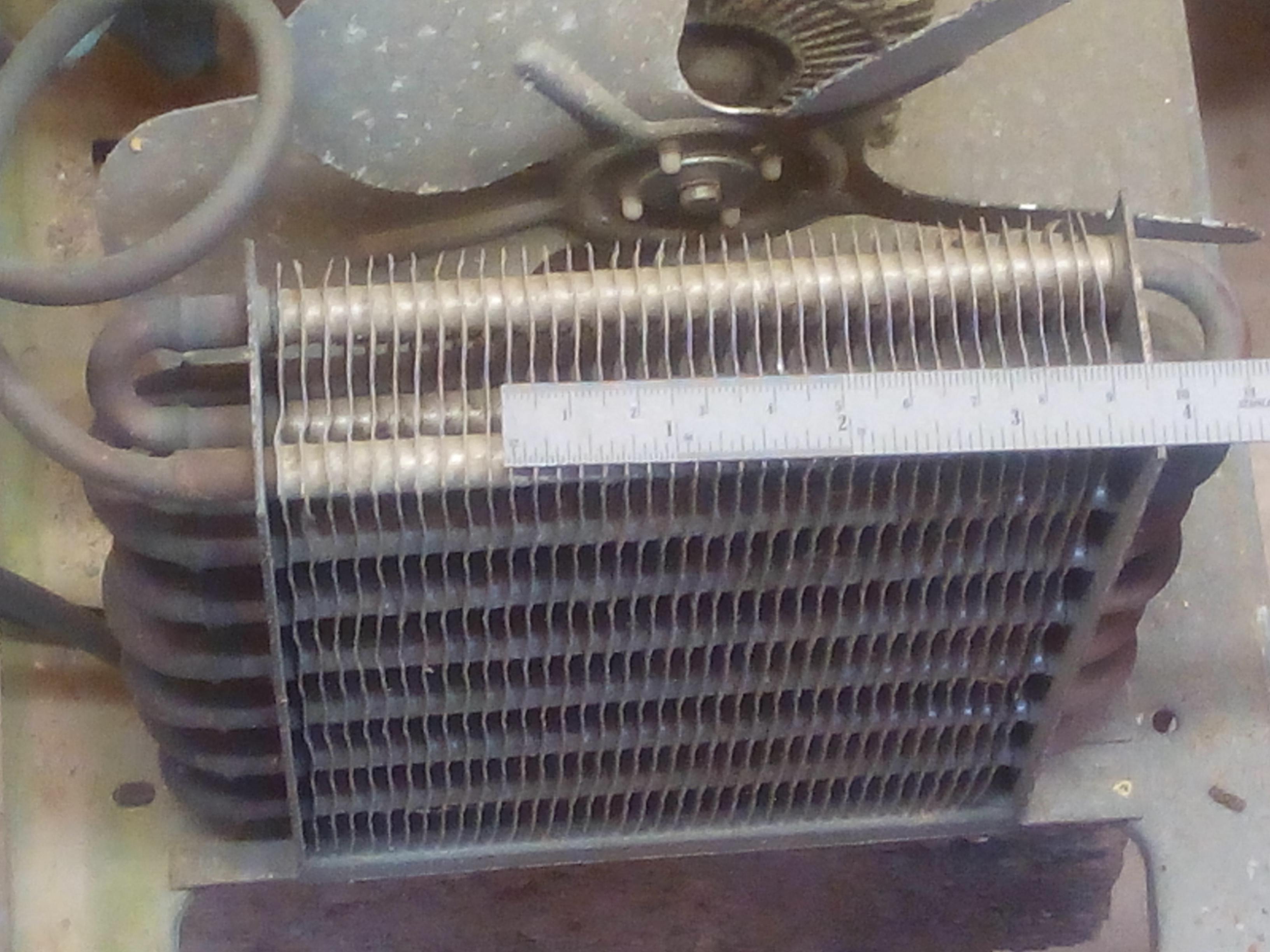

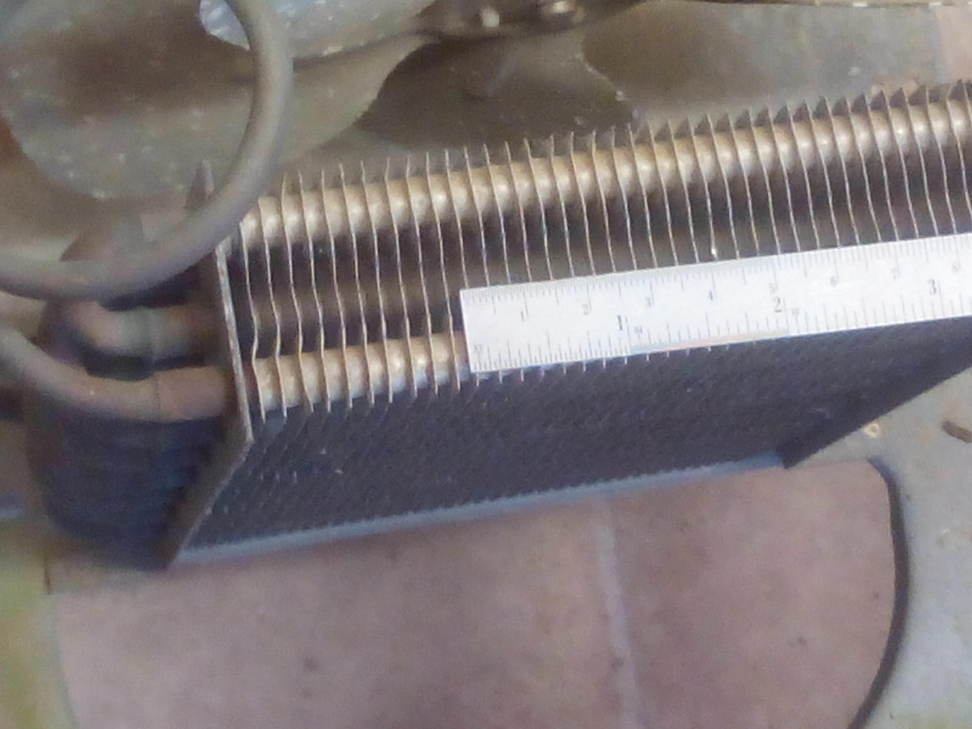

A picture of the philips will be on its way when I get to my workshop tomorrow. To clarify, a 10mm necked hole is made in the copper plate through which a copper pipe is fitted. The neck of the hole on the philips example is about 4mm above the plate surface, giving a large contact are and low thermal resistance. The pipe is an interference fit. I wish to make some tooling to emulate this.

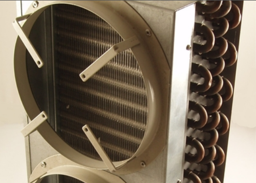

Have found a picture of a larger one although the swaged neck is not clearly shown, however its the same type of construct.
Hope this helps
Best Regards
Picclock

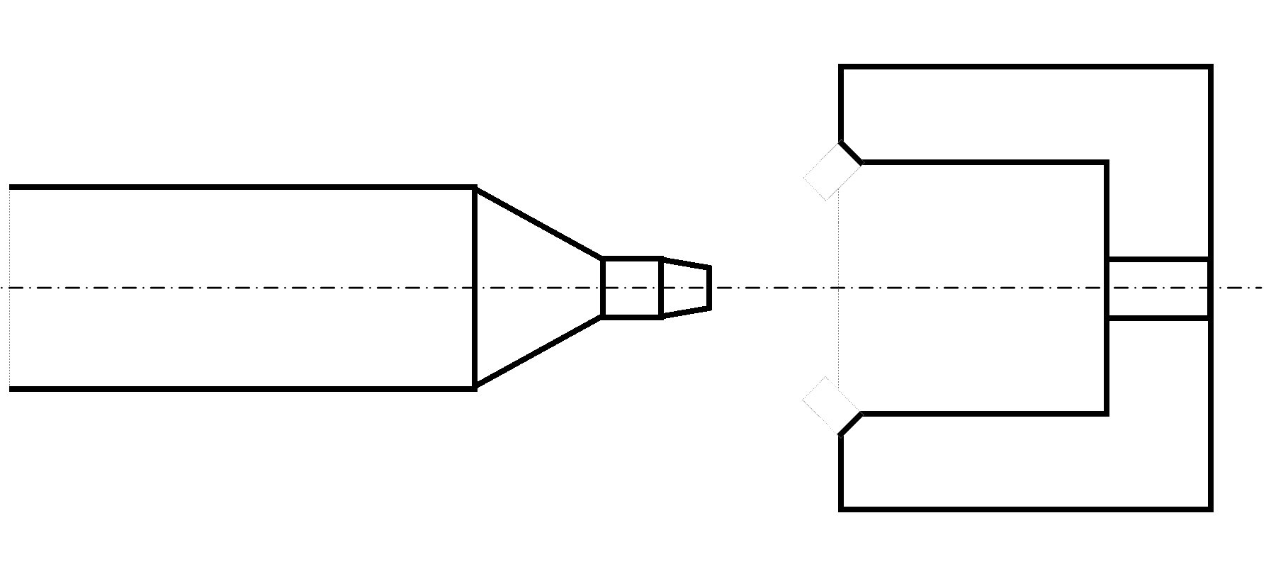

Pictures as promised. I'm thinking a 3mm hole in the sheet metal. The tooling (forming tool)with a 3mm slightly tapered end then a 30 degree taper to the final size (9.7mm). Not sure what to use as a outside support. sort of guess 11mm hole with 1mm radius edge (sheet 1mm thick). See Drawing. figure I could use silver steel and harden it for the forming part, and just mild steel for the female part.
All new to me so any advice welcome
Best Regards
picclock
Re: How do I make a tool for swaging copper plate ?
« Reply #5 on: December 31, 2014, 05:13:50 AM »
Your female part or Anvil will neen to be the dia of the pipe plus the thicknes of the copper by 2 , plus a litle bit of clearance or you may get them apart .

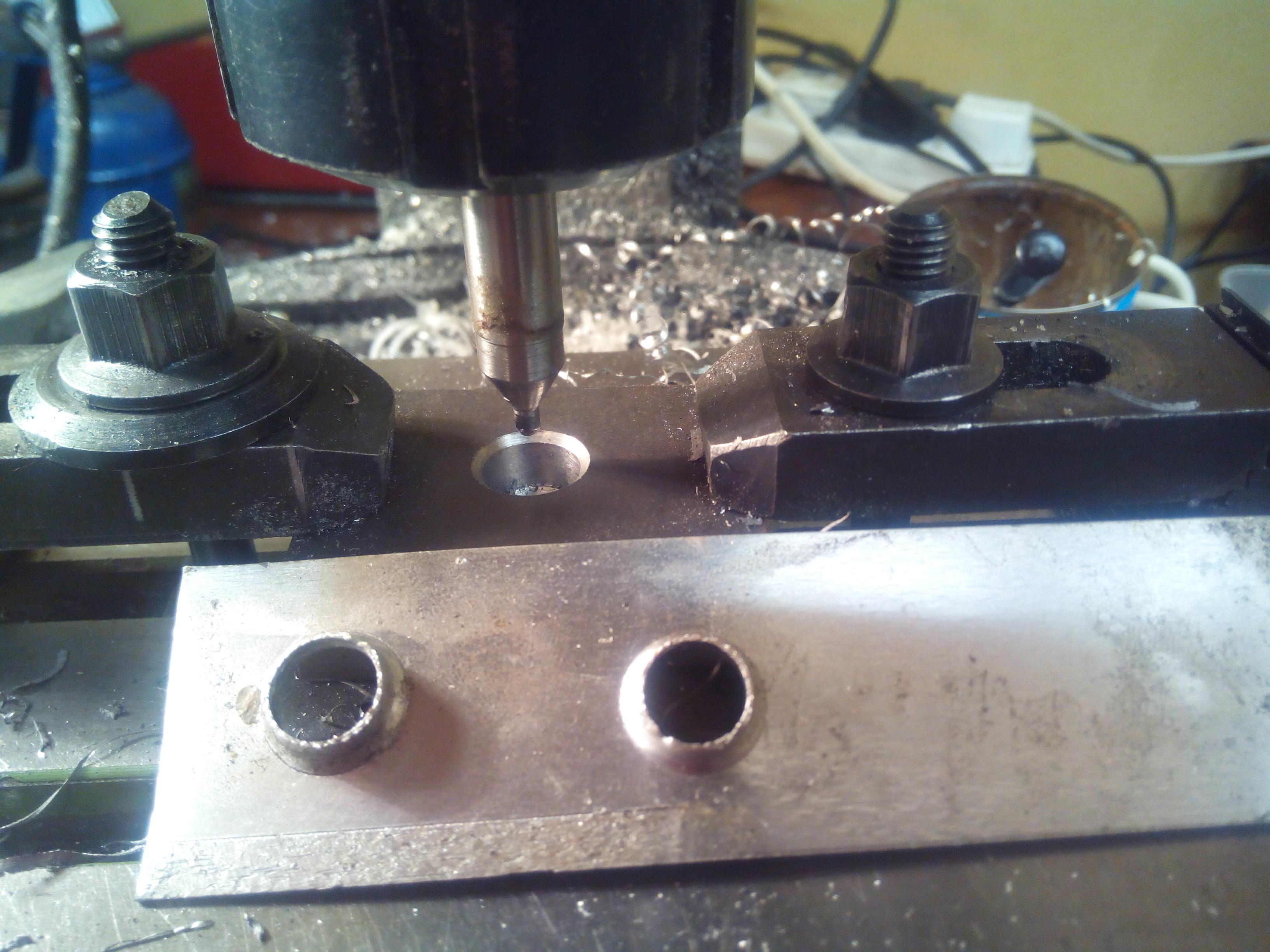

« Reply #6 on: January 02, 2015, 03:59:25 AM »

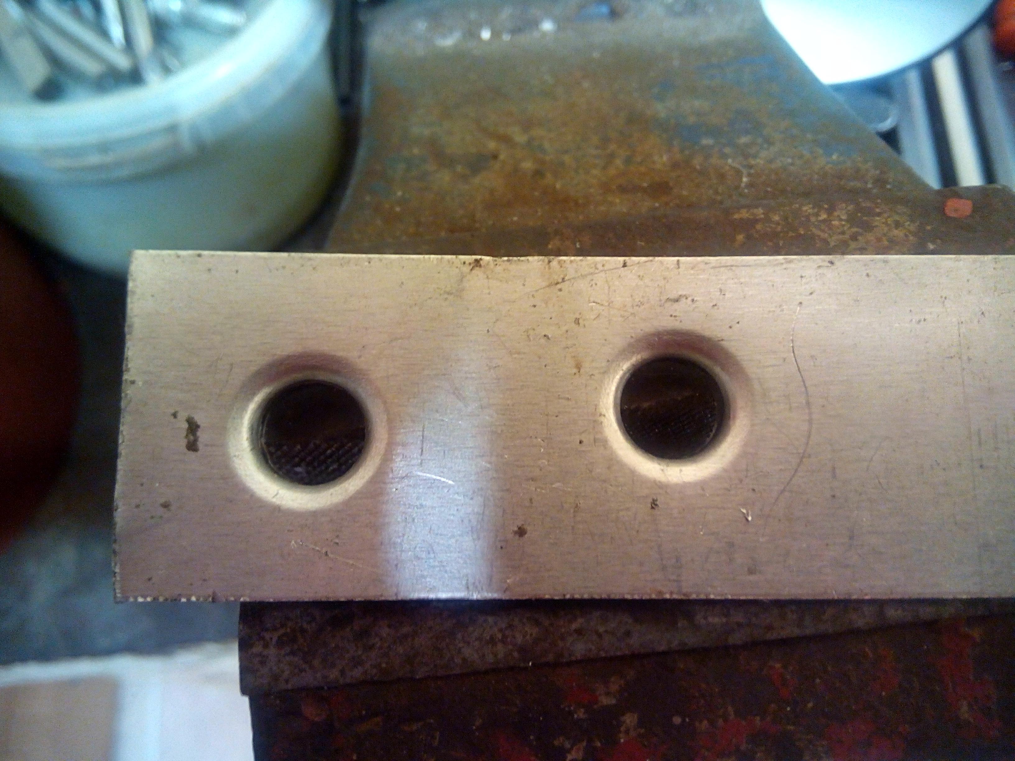

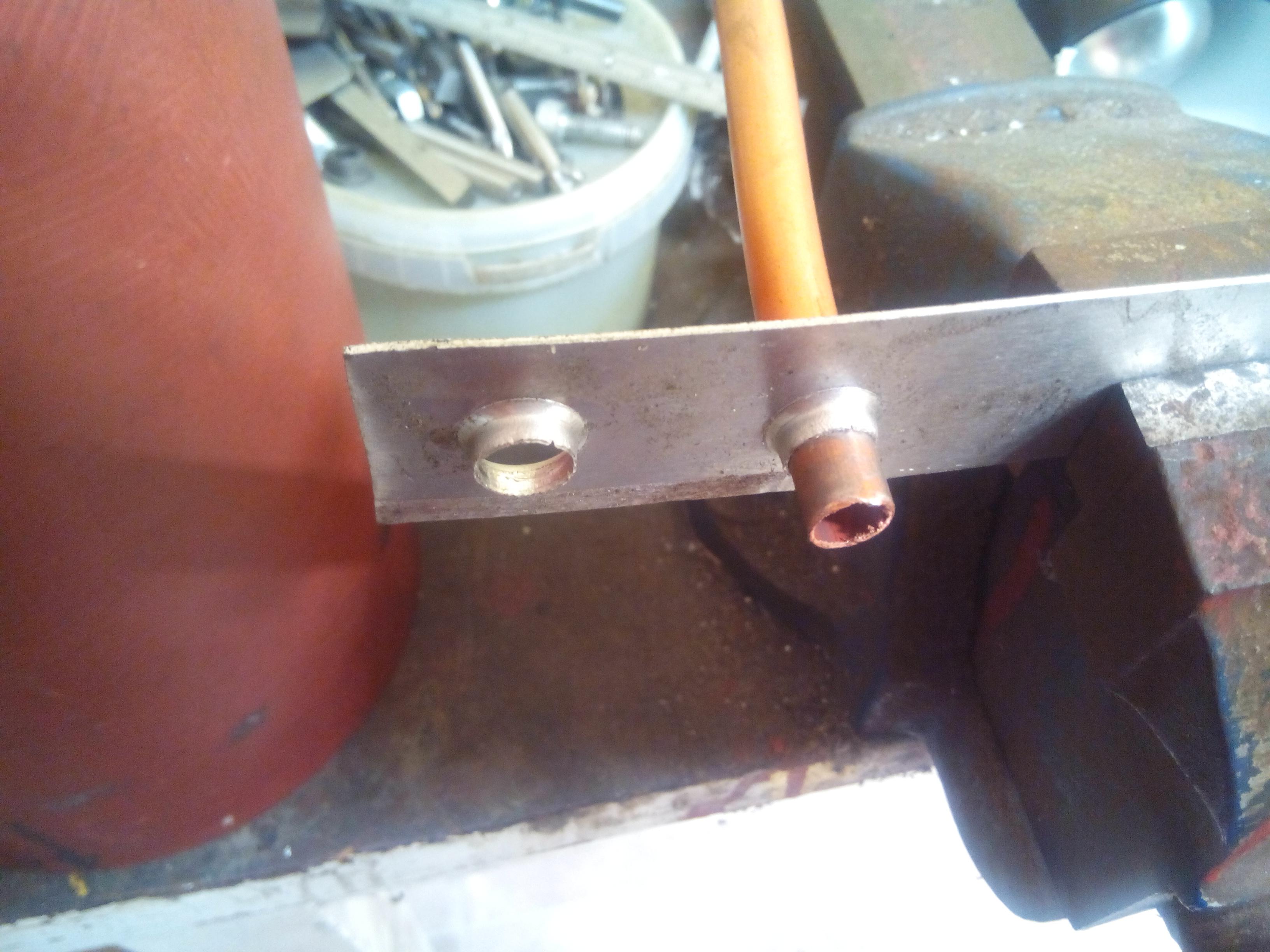

I have only tried this on Aluminium plate but it seems to work very well. Tool is as per earlier sketch. Raised area is 4mm which fits into recess of adjacent fin so that when compressed the fins clamp tightly to the tubing. Surprisingly low force levels needed to deform the metal - I just used my mill. Now need to arrange a second overdraft for the cost of the copper sheet :bugeye:
Best Regards
picclock

« Reply #9 on: January 03, 2015, 09:08:00 AM »
I had to do exactly this job in steel sheet to make an exhaust system for a project. I went through a box of old hex sockets, found two, one with the right external diameter for the hole, and a larger one it would just fit inside, put them on some threaded rod, and pulled the small socket through the hole into the big one by tightening the nuts, worked like a charm and left the perfect swaged hole. I suppose finding the correct sizes was lucky, but it worked for me! If you have a press and can turn up the tooling, git er done!
  • Posts: 819
« Reply #10 on: January 03, 2015, 09:12:16 AM »
Just to add, you need sufficient clearance between the two sockets for the swaged material to fit in to and we all know that a bit of clearance never hurt anyone!
