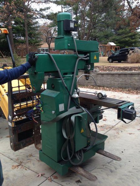

I recently purchased a Grizzly G3617 mill from an estate. The same mill is sold as an HM-52 down under. It had been retrofitted to 3 axis CNC with three Nema 42 stepper motors along with a 3 axis motor control unit. There was also an older computer that had some control software installed. The question I have is what else do I need to get this thing on line. There appears to be a missing link between the computer and the motor controllers.

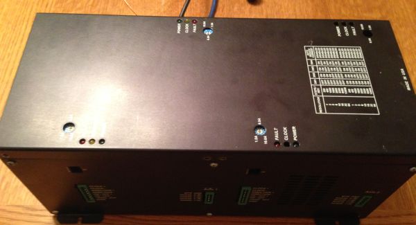

We need photos of the controller box you mention

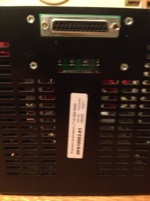

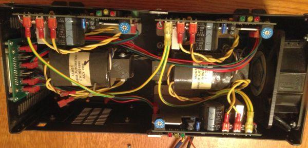

Here are the pictures John. Appears to just be three discrete controllers, a couple of power supplies and a 25 pin parallel port to tie them all together. The software is by Flashcut CNC and refers to a signal generator to allow Windows to run the program.  That is why I think something is missing.

Offline Swarfing
  • Posts: 417
Re: Help Needed From the CNC Guys
« Reply #4 on: December 23, 2014, 07:47:12 PM »
Assuming the machine is using steppers and not servos, then that looks like just three drivers and a BOB. If this is the case then you have everything you need. Go load up linuxcnc or the trial version of Mach3 and give it all ago. I say that simply but you will need to find a few things out like what pins are connected to what and that can be done with a simple volt meter or small bulb.
Going to need a few more detailed pictures of the boards especially of the connections and any labels of those pins. I can't read the labels in the pics so get as close as possible.

Offline Swarfing
  • Posts: 417
« Reply #5 on: December 23, 2014, 07:49:05 PM »
That empty space by the way looks like space for another driver (4th axis)?

Mind you with the size of those steppers at least 8 amp drivers will be needed and don't ditch the power supplies. I'm not familiar with flashcut so don't know about any special setup with the hardware. It's still worth a try while no money has to be spent? should also get 75plus familiar with the setup at the same time.

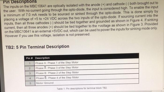

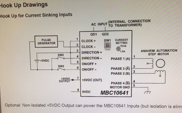

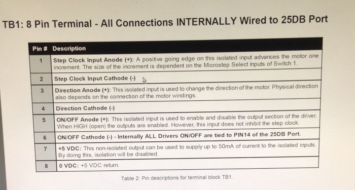

« Reply #12 on: December 23, 2014, 11:07:56 PM »
75Plus, maybe you have an intact Flashcut system after all.

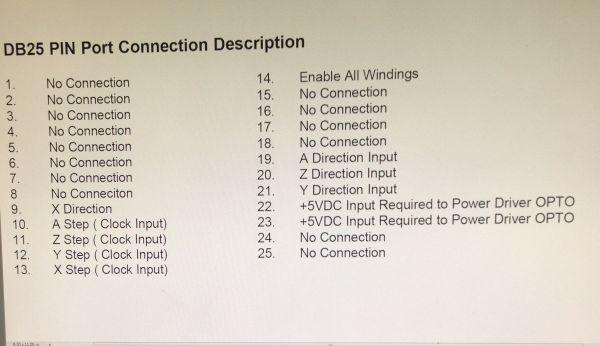

Check to see if you have anything connected between pins 2 and 6 of the MBC10641's -- that would be the pulse generator. Doesn't seem like it would be a very complicated circuit -- it's just a clock.

« Reply #13 on: December 24, 2014, 06:26:59 AM »
These really do look like typical drivers, the latest ones according to the site are mains input. The clock generator they refer to i believe is just what the resolution (microsteps) are set to, this would be done from Switch one and stepper current from the VR. The parallel connector is just standard bi directional setup so would just plug in and give one of the freebies a go. Nothing to lose and would give a starting point to work from.

Sorry just noticed that you do have the MBC10641 just without the covers on. The full doc has this in the introduction say may need the hardware clock
'The clock input is set to receive
either positive or negative edge clocks with a maximum frequency of 400KHz.'
Might be easier to sell this control unit and replace with new BOB and drivers?
« Reply #19 on: December 24, 2014, 02:54:48 PM »
75Plus was there anything connected internally between Pins 2 and 6 of the three MBC10641s?
I don't think you need a new set of controllers even if you don't have the pulse generator. I think that can probably be supplied by your computer via the parallel port (usually through a parallel port break-out board) to each of your three MBC10641controllers by newer software than Flashcut. Or you could hard-wire it without a break-out board, if you know what you're doing.
I think the "clock" pulse is probably just the step pulse that most CNC software now outputs. And that can be positive going or negative going as set by software and/or your connection to the controller. And you can set the max step rate to suit the 400 kHz requirement in software.
You won't be able to use the old version of Flashcut, but you can probably use TurboCNC (free), Mach (free demo), or LinuxCNC (free). All of these provide the step pulse through the parallel port.
« Reply #20 on: December 24, 2014, 03:27:09 PM »
If you substitute the words "STEP signal" for the words "Pulse Generator" on the schematic, hook the appropriate pins of the parallel cable to it, change software to a newer CNC program, and follow the the software setup procedure, I think you're good to go.
« Reply #21 on: December 24, 2014, 04:14:55 PM »
Just found a mention on the web about converting a Flashcut system to a mach system (same would apply to LinuxCNC or TurboCNC. This one does not make modifications to the Flashcut Signal Generator driver box. It simply makes up a new parallel port converter cable that attaches to the Generator box jacks and brings them together to a new parallel printer plug for the computer. These jacks probably just pass the driver signals through to the cable that connects the Pulse Generator box to the Driver box.
While you don't have the Signal Generator box, it does seem that you can directly drive the stepper drivers by just using a parallel cable, and using alternative software, bypassing the whole Flashcut system.

Offline Swarfing
  • Posts: 417
« Reply #22 on: December 24, 2014, 04:22:50 PM »
Vsteam you are totally right. There is a lot of conflicting info out there about the need for the pulse generator but looking further with other people using linuxcnc, they seem to be using it fine without it, so back to my original thought....hook it up and give it a whirl 75Plus
