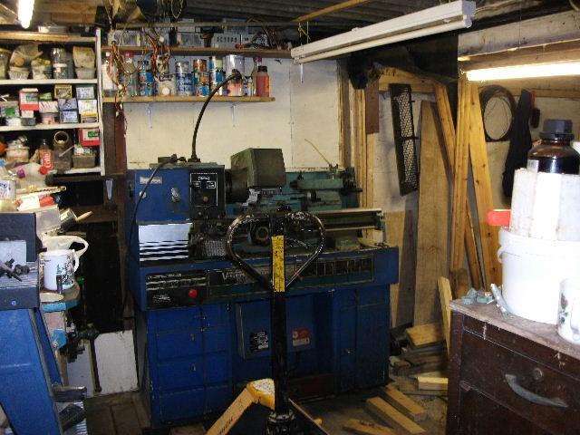

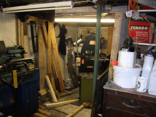

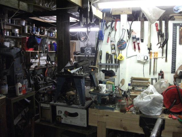

Thought I post a few pictures of my ongoing shed shuffle.
I will give me an incentive to press on and finish the job.
All this is to allow me to get my Denfod lathe across into it's final position. And,  maybe more importantly to get the BMW inside to work on it.
Basically I ad to just move everything to one end and pile it up so I had enough room to get the (borrowed0 pallet truck under the lathe and move it from the 'annex' into the main shed.
Now the real work begins.

I wish I could afford to get a container.  Mind you,  there is nowhere to put it.  As for the visible floor space,  I need to make a lot more as the BMW has to come in as well, The Lathe will be moved further inside  to the back wall; not visible on the pics but behind the partition with all the bits hanging from it.
While it is quite cosy,  it is actually bigger than it looks on the photos.
 A hint I will pass on is that when you make a shed,  make as much as possible as 'bolt-on' panels. Then you can remove a panel or two if you need to gain access for the entry of machines etc.  There is a bolt on wall between the end of the lathe and the bandsaw. Only fixed with eight twelve mil bolts. It really helps being able to remove it. Also the end wall facing the drive can be taken out the same way.
I'm going to have to build a further extension to take a lot of the 'stuff' or my floor will become cluttered again. But at least I can move around to use the saws etc.
I would have preferred to place the lathe (after cleaning,  it is in 'as bought' condition at the moment') in the small warm outhouse,  but it won't fit.

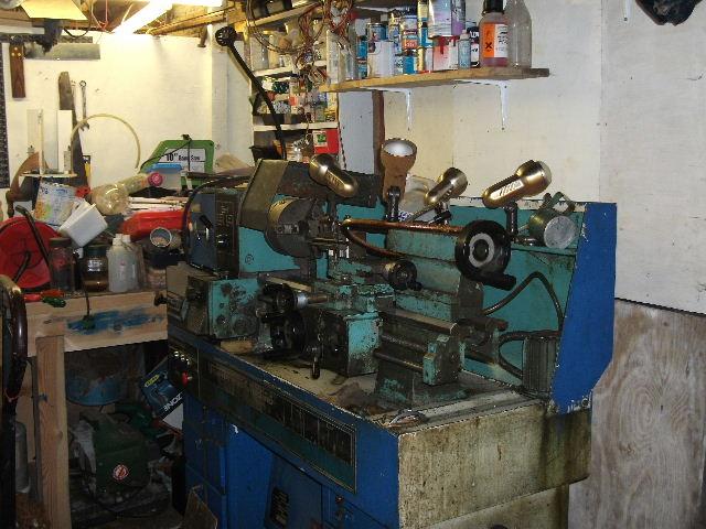

Managed to move the Denford lathe across the shed to the other side. As it is very heavy (for a small lathe) and it now has the EMCO milling attachments fitted, which makes it a bit unstable, I pondered for a while on how to do it.  In the end I cut eight six inch lengths of pipe and used them as rollers.  My wife was not happy about having to keep placing them strategically,  but I was the one with the crow bar. Never happy, women.
I now have a similar problem to Andrew in that the headstock end is only a couple of inch from the wall.  So I can't open the gear train cover or pass a bar through the headstock mandrel.  But the plan is to move that particular wall a yard or so.
