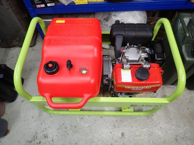

Looks like I can't have the cake and eat it too!

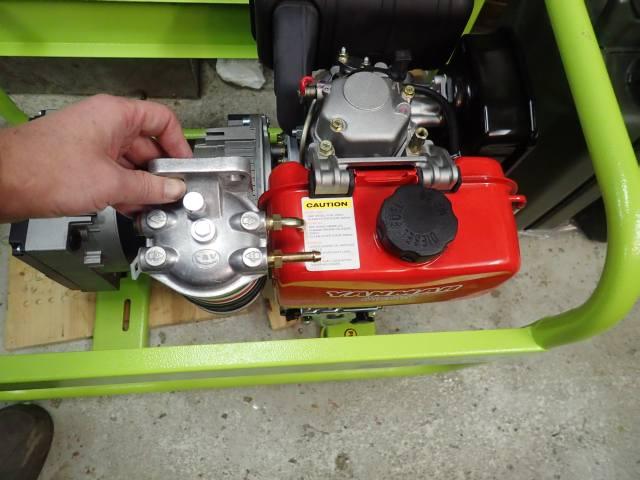

Originally I bought the big filter to fit it where the small fuel tank is located now. See first picture. I was thinkking to use the clamps and rubber grommets to hold aluminium or steel plate that would allow me to mount the filter unit for a good access.
I was trying to find a gravity feed tank which I could mount traditionally and dispense with prinming pumps and all that. It just looks that to find 10-20 litre tank of proper size and half decent price is hard. It should be just a tad shorter than 20l traditional Jerry can.
I'm that desperate that I'm even looking the old stanless kichen sink as possible base material for the fuel tank. :lol: I prefer one mounted tank over puzzle.
Plan B is to put a shelf on top of the generator and bungee hooks for a boat spare tank, fit a bulb pump between the fuel line and filter. Tank itself needs a minimum of modifivations and almost fits inside of the generator frame. See second picture.
Plan C is to find a smaller filter (possibly with a priming pump) and retain the old tank, rout the line trough new filter and put a aux fuel line disconnect to filter input side. Problem is that the only free place for this large filter comes within 2" of the generator cooling exit.

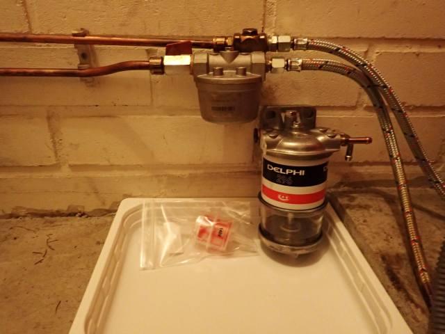

Third picture illustrates difference of the diesel oil filer, heating oil filter and inline filter size.

I took a day off from this problem/chanlenge and started to think that here opposite of good might be prefect.
I'm thinkking of rigging a fuel tank gravity feed and keep everything simple - if it ever is.
I'm thinking of using a normal spare tank and keeping it almost empty when in storage. When put to proper use: bleeding all bad fuel out, fueling it, fitting tank, and it should start with first pull.
I have few options, each has it't own set of compromise.
1) Tank venting:
* breather filter???
* Valve to reduce condensation, fuel aging, and leakage when generator is tranported or moved about.
2) Fuel outlet:
* On top of tank. Won't leak when in store or in use, but needs a fuel tube inside the tank and priming pump.
* Bottom of the fuel tank more simple on every account, might leak if used improperly, although I have no intention.
I'm pretty confident I'll get it working in any case.

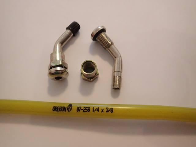

Interesting thing is that I was trying to buy today diesel proof fuel tubing and the shop had only Gates rubber hose, one type inside the tank and the other outside the tank.
I walked trough all the selves and on chainsaws they had vinyt tubing:
https://www.oregonpartsstore.com/07-258.html
I have allways avoided using vinyl on any fuel, but apparentyly there is a type that will take least gasoline. But will this particular one (Oregon 07-258) behave well with diesel? Will it work only outside of the tank or can it be immersed?

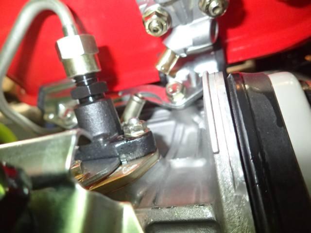

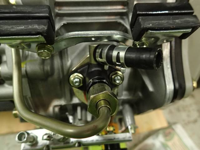

OK, some progress
VT and some others might be interested on this concept of fuel line unions to fuel tank:
* Use on truck/tractor tubeless tire valve assembly
See first picture, standard item has pretty much correct stem to popular 1/4" tubing, the thread part on the tip is about 7,6 mm, a tad small for standard 8 mm tubing.
Good news is that they are readily available, pretty cheap (I walkked in first tire shop and they sold two 3€ apiece) and when the air valve is taken out it is all smooth bore. They had straigh stems, 90 degree, short ones, long ones, but I liked this small angle model.
The interesting thing is that I just might be able to have the cake and eat it too, very soft fuel line might allow me to fit original tank and a quick fuel disconnect. Threre is only about 50 mm of linear distance of two fuel lines to snuggle. Rubber hose would not make that tight bend, but this Oregon fuel line just might. Only thing is that I need a bigger one than this 1/4" I have.
See  pictures two/three.

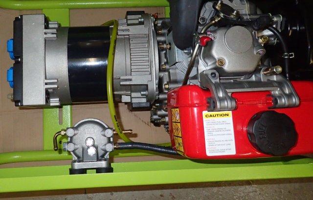

Another complication is that I can't fit very well the filter assembly I have, it is just few centimetres too tall to maintain and use it properly. Darn. I don't want to tilt it, nor mount it to protrude out of the pipe frame at all and thre should be enough space around it when maintained in dark, rain, blizard or -30C and windy.
On the other hand I want it as big as possible in filter area, because this has no transfer pump.
I'll try to fit the original tank and injection pump with new diverted fuel lines and see if it looks doable, if it does, then I'll hook them up to an external filter that has aux fuel line disconnect. That would give me max. flexibility and if I get the filter height right, there should be no problem when bleeding it.
It all would be a whole lot easier if I had fuel rubber line T with short end of 50 mm stump, I have seen them on car cooling systems, but never on fuel lines.
Plan B is to take the original tank out and make a good use of the space where that orginal tank is. For this option an fixed tank would be great. I googled last night ready made tanks and there seems to be many possible  ones in USA, but not that many in Europe.

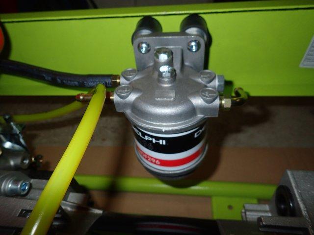

I ordered some stuff from UK:
http://www.ssldieselparts.co.uk/
I bolted on some hoses and parts to find out if all would fit right places and easy to access for maintenance.
No hose clamps/clips yet. To keep the original tank necessitates fairly thin walled hoses. The hose from the injection pump is normal Gates NBR hose and from the tank is Tycon type PVC hose. That particular hose is 1/4" OD, but I really would need 5/16" (8 mm) ID type. But it bends pretty well. I could not use two standard NBR hoses, they simply would not fit past to each others.
