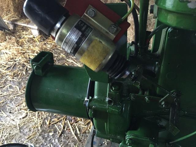

As Pekka says, the fuel rack is pulled out to run and returns by spring to stop. My big new generator has a large solenoid doing exactly this, but is 12v off the starting system. I'm advocating a solenoid rated at whatever Steve's Lister clone provides (110?) so no extras bits other than the solenoid.
This has the advantage that the system is 'tested' each time you start, so if the bi-metallic strip contacts have oxidised you know. If you rely on something working only in a (hopefully rare) fault situation it may or may not work ! I suppose it's my background supporting critical systems that makes me think this way  :ddb:

Photo attached of the fuel solenoid arrangement on my Lister. Steve's won't have the solenoid, but the arrangement of spring loaded fuel rack will be similar I suspect

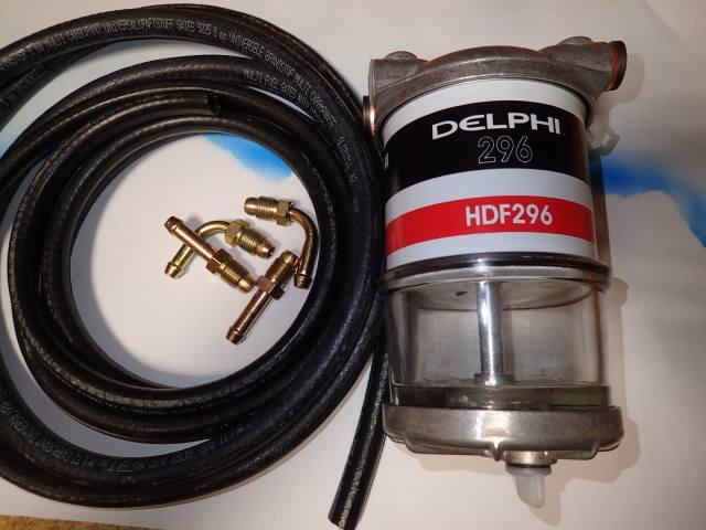

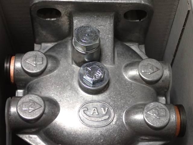

Got CAV single fileter unit.
It has four unions I wonder what are the alternative ways of using them and which one would work best?

That's the exactly the same filter as fitted to my 3 cylinder Lister generator  :ddb:

I suspect the four ports are to give you the option of connecting the supply/discharge to either side (depending on your pipework) without having to bend the pipes back on themselves.  You just blank off the ports you don't need.
But I may be wrong.

Yes I can confirm that is the case

Sounds leggit. Thank you. It has two blanks fitted. Never really paid antention of the fiter fittings, other than put incoming and outgoing ports right way. I tought that there may be some other clever options. Like there is a "one-pipe" system for oil furnace burner here. It has one pipe from the tank, but there is filter and water/air separator unit that has in/out ports for the burner.
I'm thinkking of mounting this fuelfiler unit such way that bleed screw becomes highest point of the pipe work. All in line of the fuel feed line straight to the injection pump. Then one continous return line from the injector back to the tank.
I have been reading that there is available two different type of filter for this one "red" 30 micron and "blue" 10 micron, which former seems to be often used for gravity fed system. I have seen some talk about even finer and more specialized filters....I don't think I need to venture there with this engine.

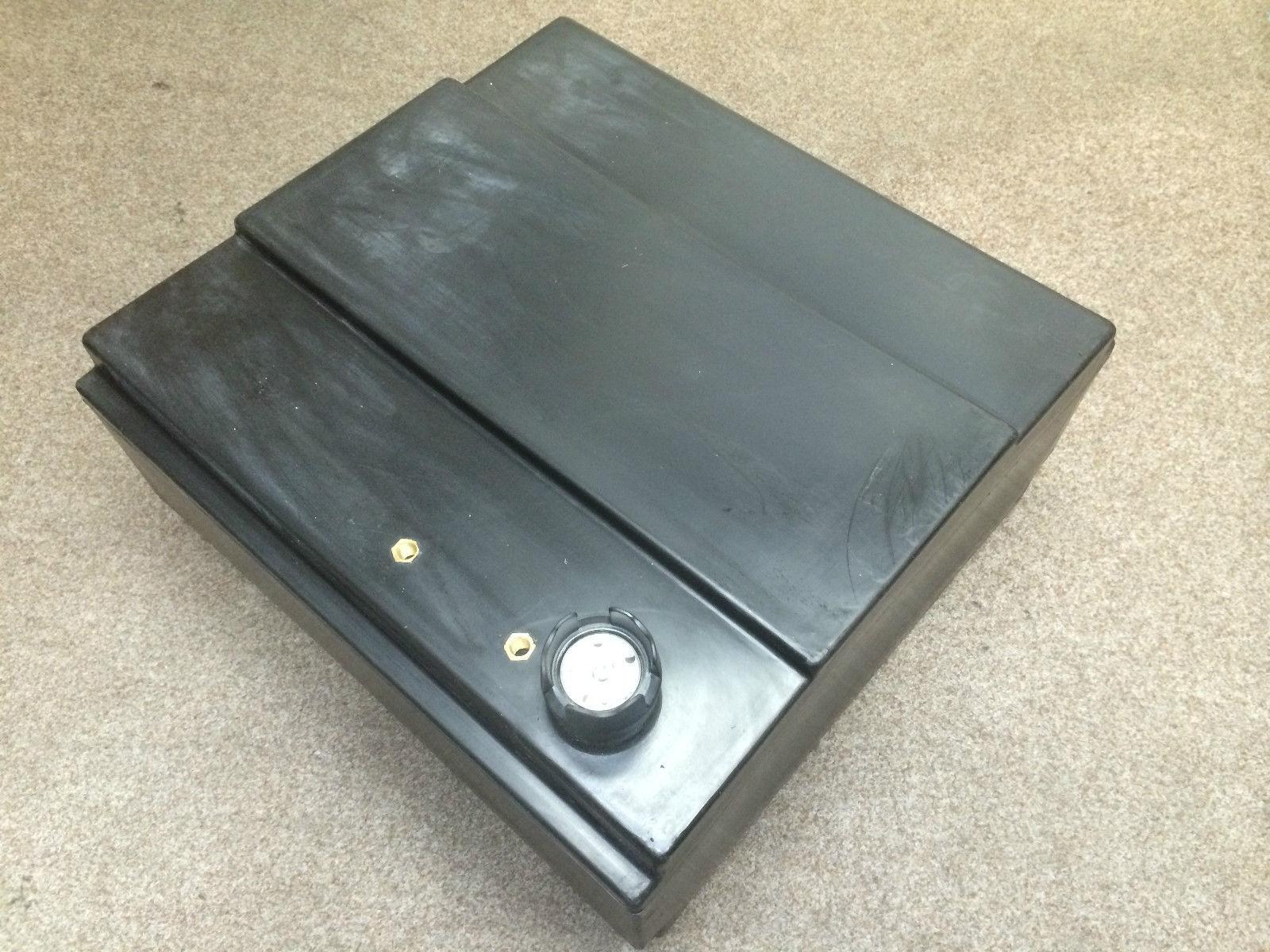

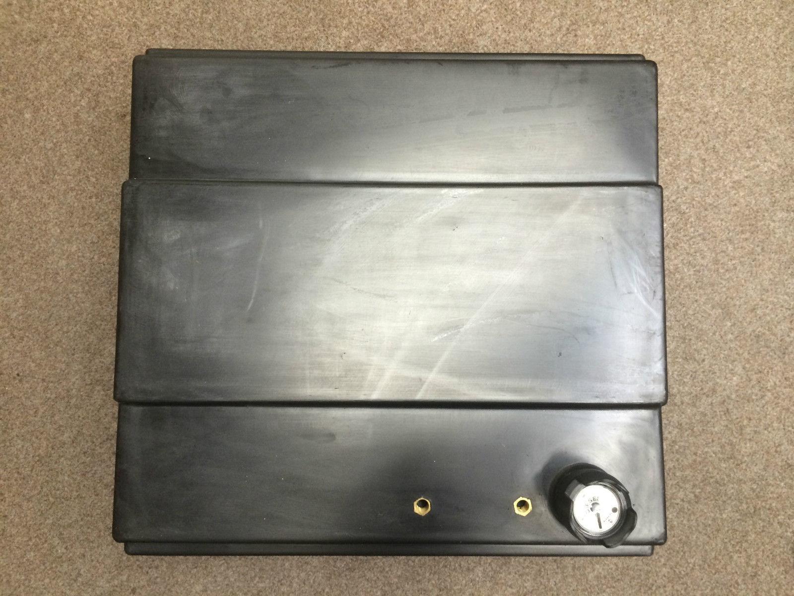

« Reply #39 on: December 21, 2014, 01:19:38 PM »

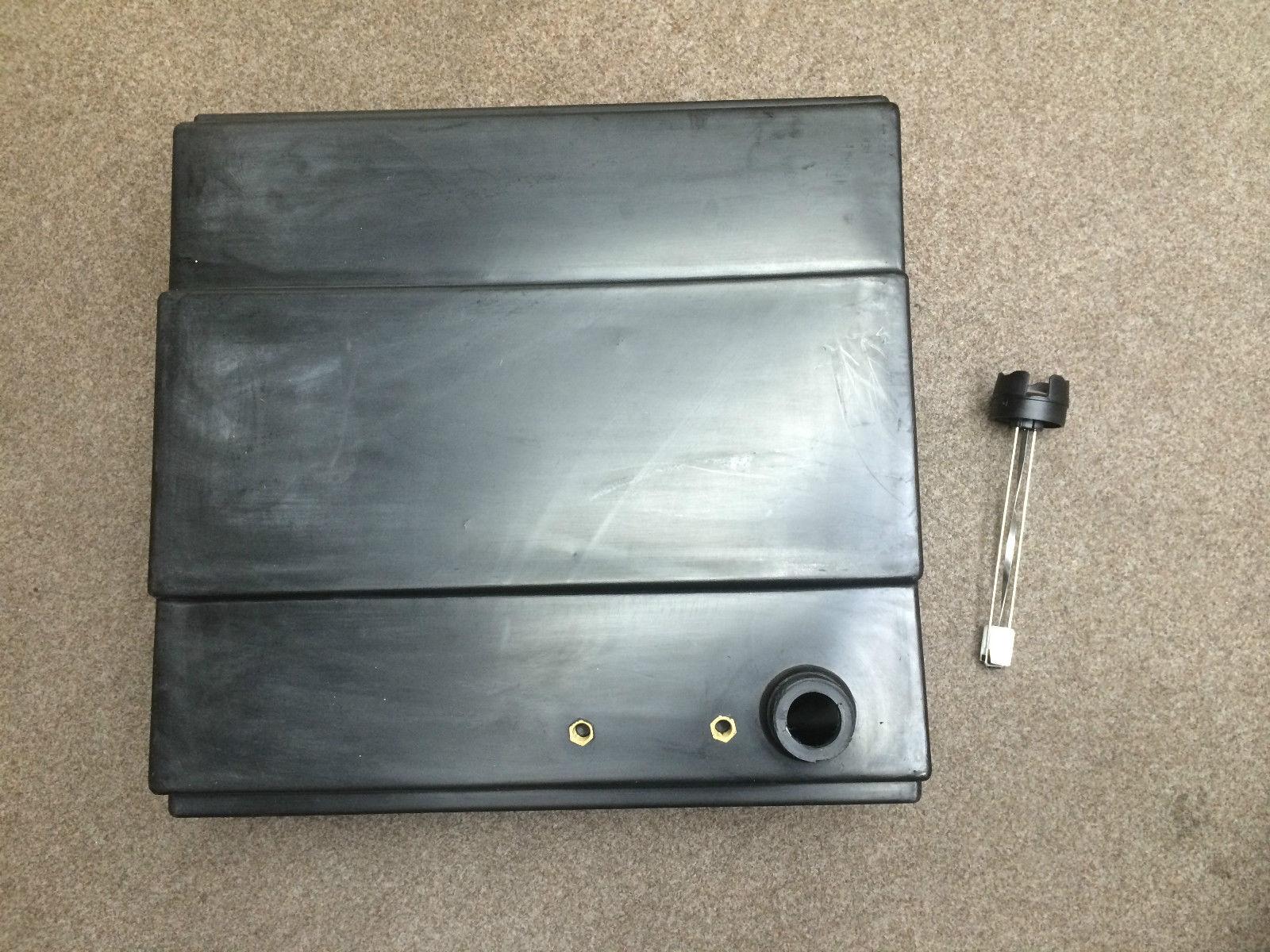

I bought a tank off ebay that is rotationally moulded black HDPE with fittings moulded in. Surplus from a stand by generator manufacturer who has changed his design / layout. 60 litres so roughly 2 foot square and a foot tall.
Chap has several and accepted a lower offer than his asking price :)
  • Posts: 6835
Re: Fight against annoying power cuts!
« Reply #40 on: December 21, 2014, 03:24:17 PM »
Tank looks good, Andrew.
« Reply #41 on: December 22, 2014, 01:24:47 AM »
That tank looks good. It is a about size of my generator :lol:
VT. Than you, that's what I thought. And apparently it is very reliable.
