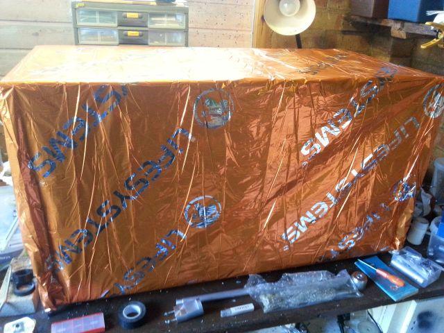

I only have a work area at the end of brick built garage, which means in winter it gets cold and damp.
To protect my mini-lathe from the dreaded rust I cam up with a cunning plan - build a heated greenhouse for it.
I had a few lengths of aluminum tube left over from a fruit-cage build, and these were used to create a frame just big enough to drop over the top. A space blanket from Milletts folded over the top (looks just like an early Christmas present) gives a cheap heat retaining skin.

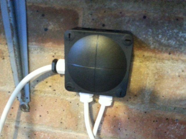

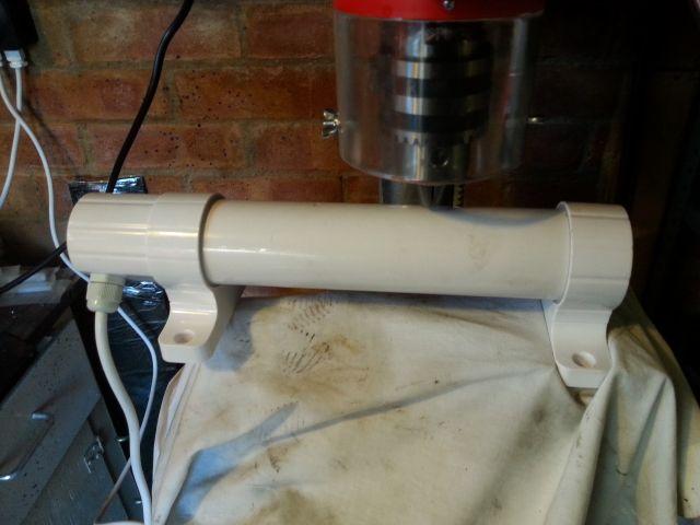

But how to provide some heat? The smallest greenhouse heater that I could find was 40 Watts, and that would be more than necessary for rust warding off and cost a pretty penny to run. The cunning bit was to wire two 40 Watt heaters in series. Wiring the two in series meant that each would only consume 10 watts, and I could use one to protect my lathe and one to protect the pillar-drill. A 10 Watt heater is only warm to the touch, so no fear of damage.
The two heaters are wired together in a junction-box with suitable glands and plug into a mains supply with the usual protections. Those few Watts are just enough to keep the greenhouse a couple of degrees above the surroundings. Voila.

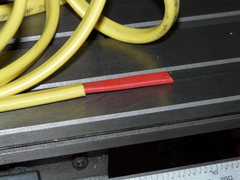

The UK supply of trace heating cable is 3\4 of a mile from me , a chat with the boss man he said that iff the end caps were fitted corectly and sealed with silicon rubber it can be used under water but not permonantly , there is two types of cable self regulating and non regulating which needs a thermastat , I have it taped to the under side of my mill oil tray with a layer of insulation under , and a stat on top it comes on at 9 degrees celcius and it has to be realy cold to stay on very long usualy on for ten minutes and off for five .
