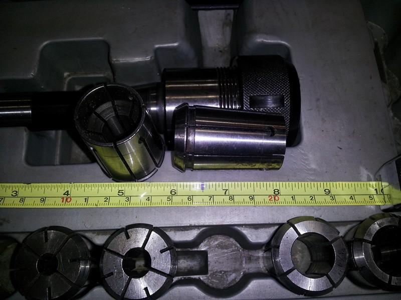

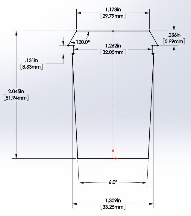

I'm beginning to think that the set I have isn't actually ER32.  A quick search online wasn't able to clear up what I actually have though.
They look like ER32 but seem to be a lot longer (2.045" overall).  I was thinking maybe ER40 but the dimensions didn't match up to that either.  Any suggestions or sites that may help in the ID?
Unless I can figure out what they are and find an MT3 chuck they fit, my options are to a) shelve it until I have a machine with R8 spindle, or b) sell the collets and chuck as a set.

It should be written or stamped around the rim what size and type it is. Sounds like a need for pic of all the components next to each other.
Yes, definitely time for some pictures.  I squinted at the old chuck for a while and wasn't able to locate any identifying marks.

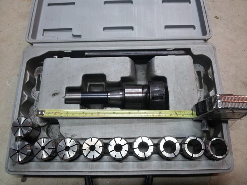

Picture 2.
They look like DIN collets to me not ER's

Def not ER collets they are to long

Picture 2.
I think you may have it.  Very little information out there on DIN collets compared to ER,  though I did find a few charts showing dimensions close to what I measured.

Yes they are DIN 6388 collets, i have one of those hiding away somewhere?

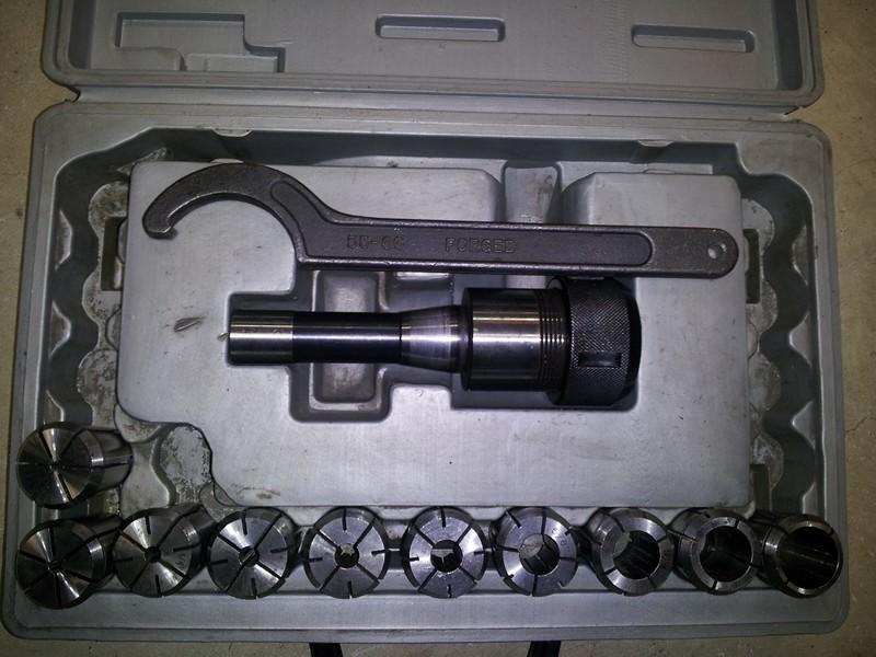

They look like TG collets to me

Quick tip!  A lot of the collets that look like ER type and are not have less slots in the collet.
