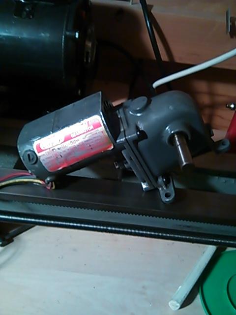

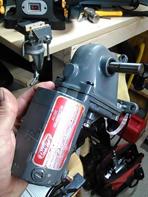

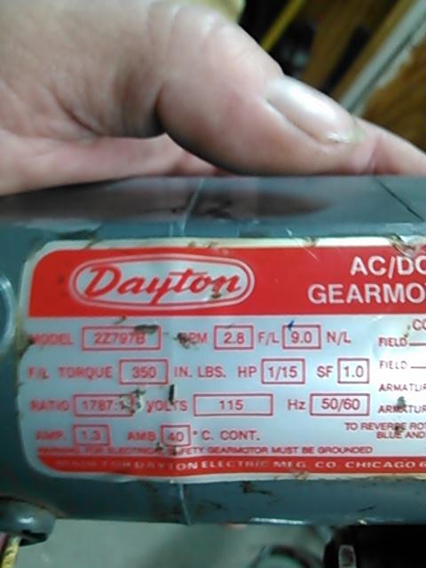

Hello Gentlemen,   I'm trying to build a transmission for a table feed on my small mill. I have the basic rough design in my head , I have this gear motor that I want to use the problem is it only turns 9 rpm  with no load. I understand gear ratios so may bee i can overcome this . My question is what would be a good max rpm to end with? I plan on using a speed controller to turn rpms down from max. I will also incorporate a neutral and reverse in trans might be easier than reversing current since I have to have a neutral any way. Am I going about this wrong? Should I scrap the idea and do it another way? I was just trying to use what I have. Below are pics of gear motor and the end of my mill table. Any input would be helpful thanx in advance

just happen to have a bridgeport powerfeed in for repair, it has a range from 15-875 mm/min (1/2 - 34 inches/min), plus rapid motion
Its motor must be the better part of 1/2hp (375w),  your 1/15hp (50w) may limit your maximum speed somewhat!

Thank you Gentlemen for taking the time to steer me straight.  Lew,  I'm not sure of the tpi on the lead screw , however you are right it is .100 per revolution. My table has 16 inches travel stop to stop, total of 160 revolutions. I was allready thinking of 10:1 gear ratio but may bee I should up that to 15 or 20 to one so that i can achieve the speeds I need.
Bill you may be right I didn't realize the feed motor on the bridge port at work had that much power. I did some checking today and I do most of my machining at 80 rpm but that screw is .200 per rev. so I think that would be the same as 160 rpm on mine with no load of course.

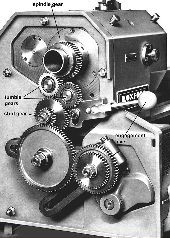

« Reply #5 on: November 25, 2014, 04:21:51 AM »
Tumbler reverse is described nicely here:
http://www.lathes.co.uk/latheparts/page16.html

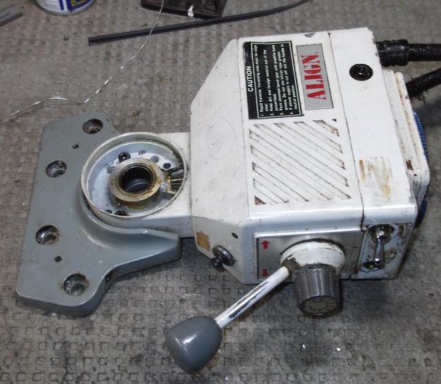

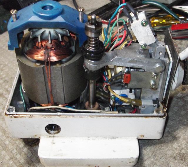

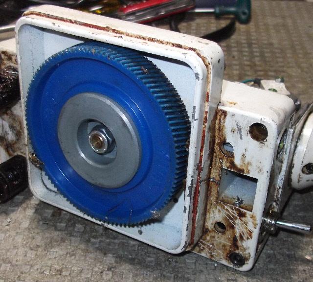

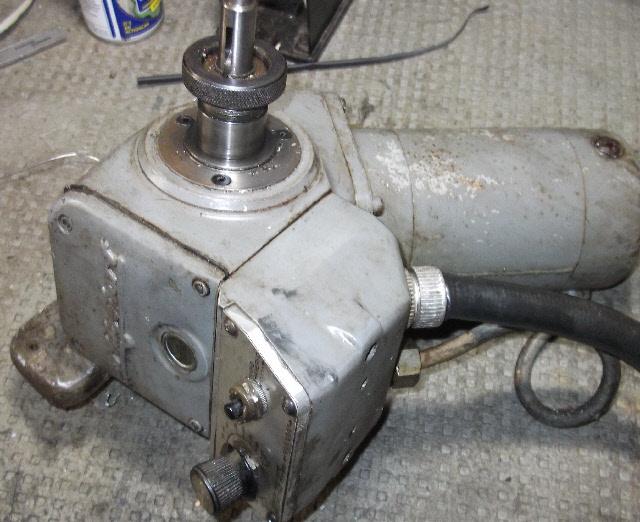

I thought you might like to look inside a couple of commercial units:
This one is an Align (pretty much the same as the Servo Units)
The DC motor is 110v @ ~3A max  it uses a electrical reverse and a simple dog clutch
  • Posts: 1185
Re: Transmission for table feed
« Reply #7 on: November 25, 2014, 06:26:23 AM »

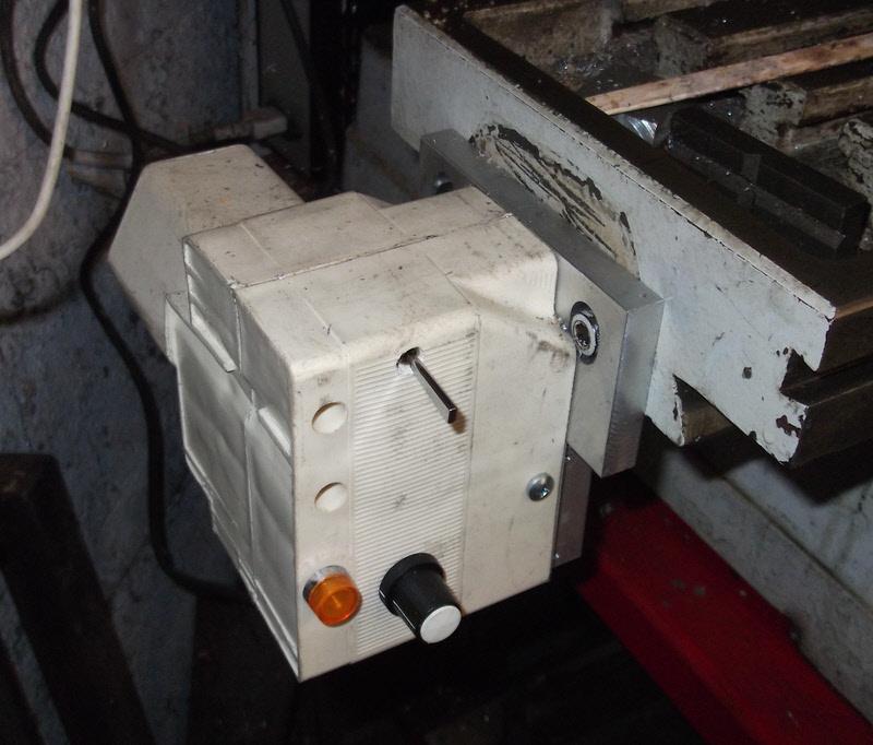

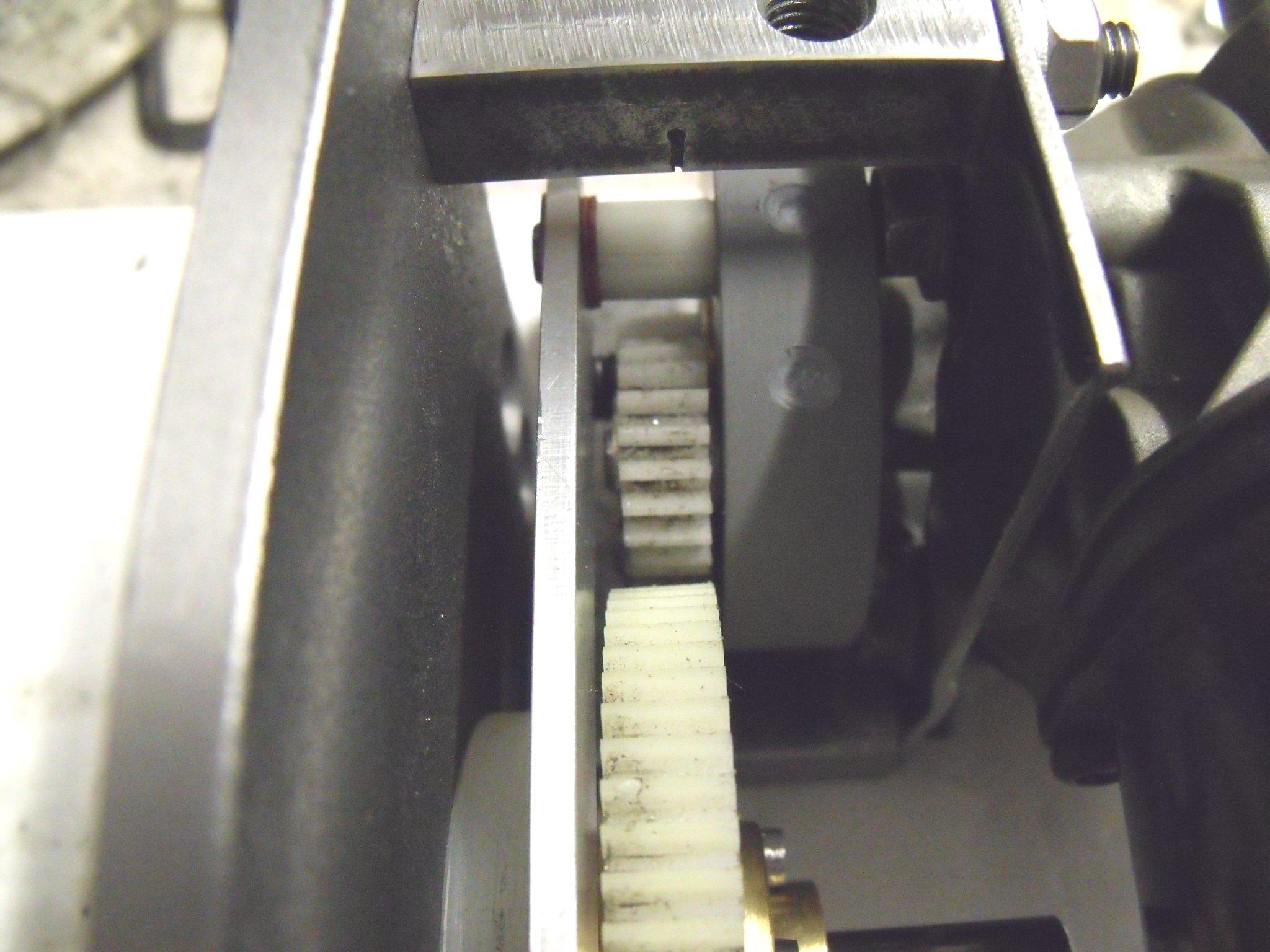

This one is a Bridgeport:
The motor plate is knackered but judging from size it looks to be about 1/2hp.
Inside is a bevel gear  and a dog clutch. The clutch is engaged by a spring on the shaft. it is held off by the lever (with the bent axle!)  and spring (left). The operating rod (centre vertical) has a cam that releases the lever.
Reverse is electrical.

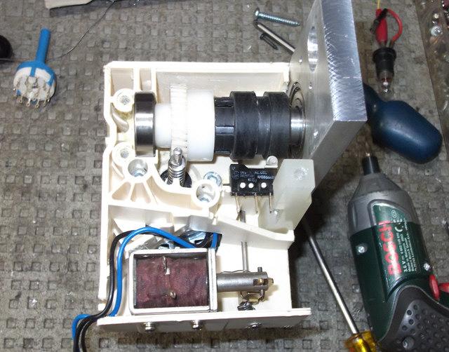

And this is one I made for my Drill/Mill :
The thing started life as a bed lift mechanism.
The dog-clutch is engaged with a solenoid. Reverse is electronic. Power is limited to about 75w, No rapid. (my mill has roller nuts, so there is very little friction on the X axis lead-screw)

Andrew , that is what i thought tumblers were thank you for the pic.  Bill, you have been more than help full nice pics , and again thank you for your time it really helps me. John you are right, most of the speeds i use are slow any way. I think mid to slow speed is better than no speed, I was thinking last night it's only a 16 inch table stop to stop. How often would I be machining stop to stop ? Probably not very often , more like 4 to 8 inches at the most. I am used to using the 48 inch table at work and I use the rapid a lot. I guess I was comparing apples to oranges and probably shouldn't have. Any way I will continue on with the project and i will post picks and keep you posted. Thanx again Gentlemen.

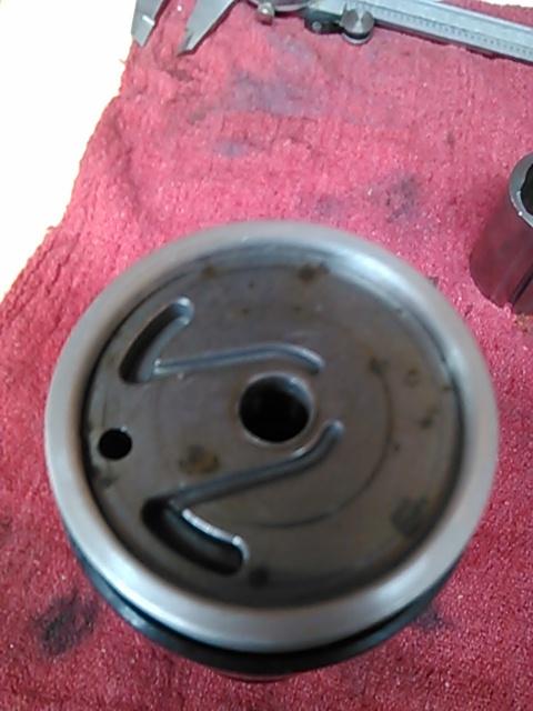

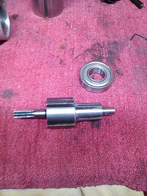

 here's another idea you might concider...
how about an automatic clutch so all that is required to operate it is a simple switch?
The video show an anti reversing mechanism
     Two-way anti-reverse transmission 1b:
by connecting the leadscrew to the green shaft,  the handle to the red shaft and power feed to the blue ring (currently fixed) any motion of the blue ring will drive the green shaft but motion of the red shaft will not try to drive the blue ring.

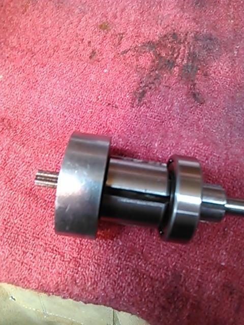

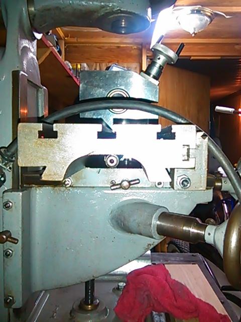

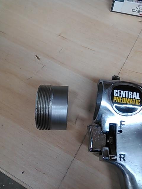

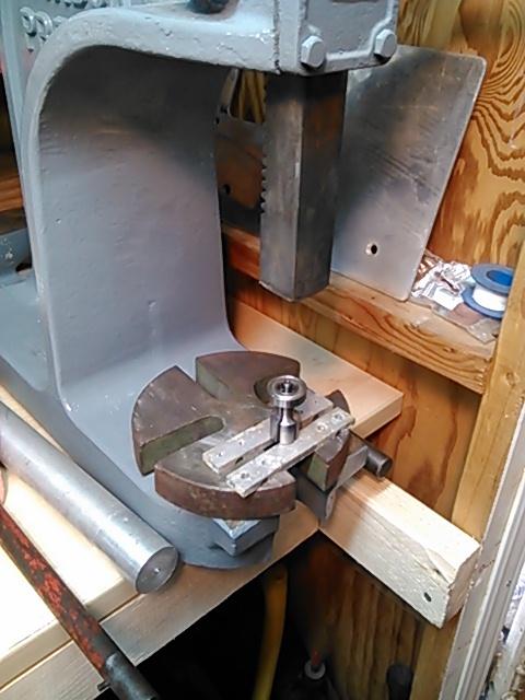

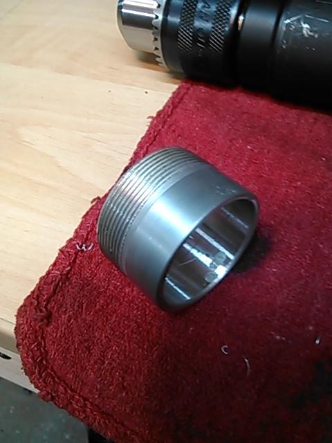

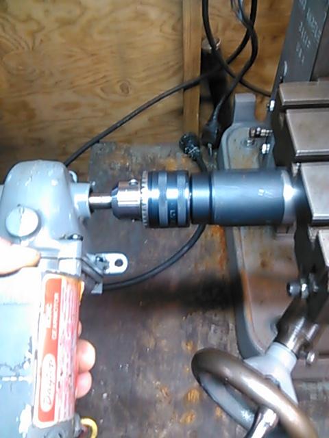

Hello , This is my first build log so bear with me please. I had some time to go out in the shop today to start on   my transmission project. If you remember I decided to use a  1/2 drill planetary set to speed up motor rpm. After I took it apart I cut the end of drill case with the band saw and put in lathe to square the end, with this screwed into the planetary end of the drill it supports the rear ring gear.  Then I machined the air vein rotor to accept a new press on bearing and pressed it on. This will be the end that  gets the coupler for the lead screw. Next will be the supports to mount the assembly to a plate that the motor will be mounted too. I'll keep you posted thanx for looking.

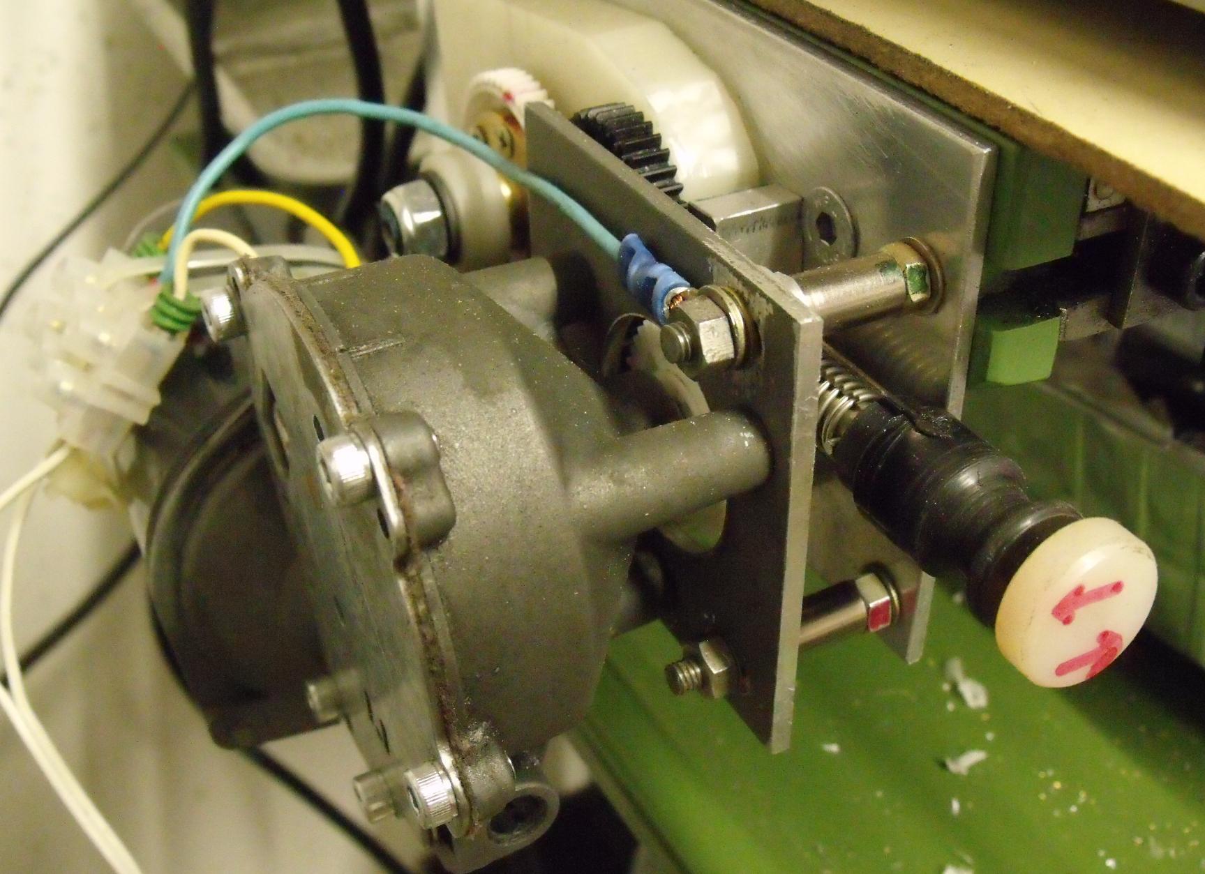

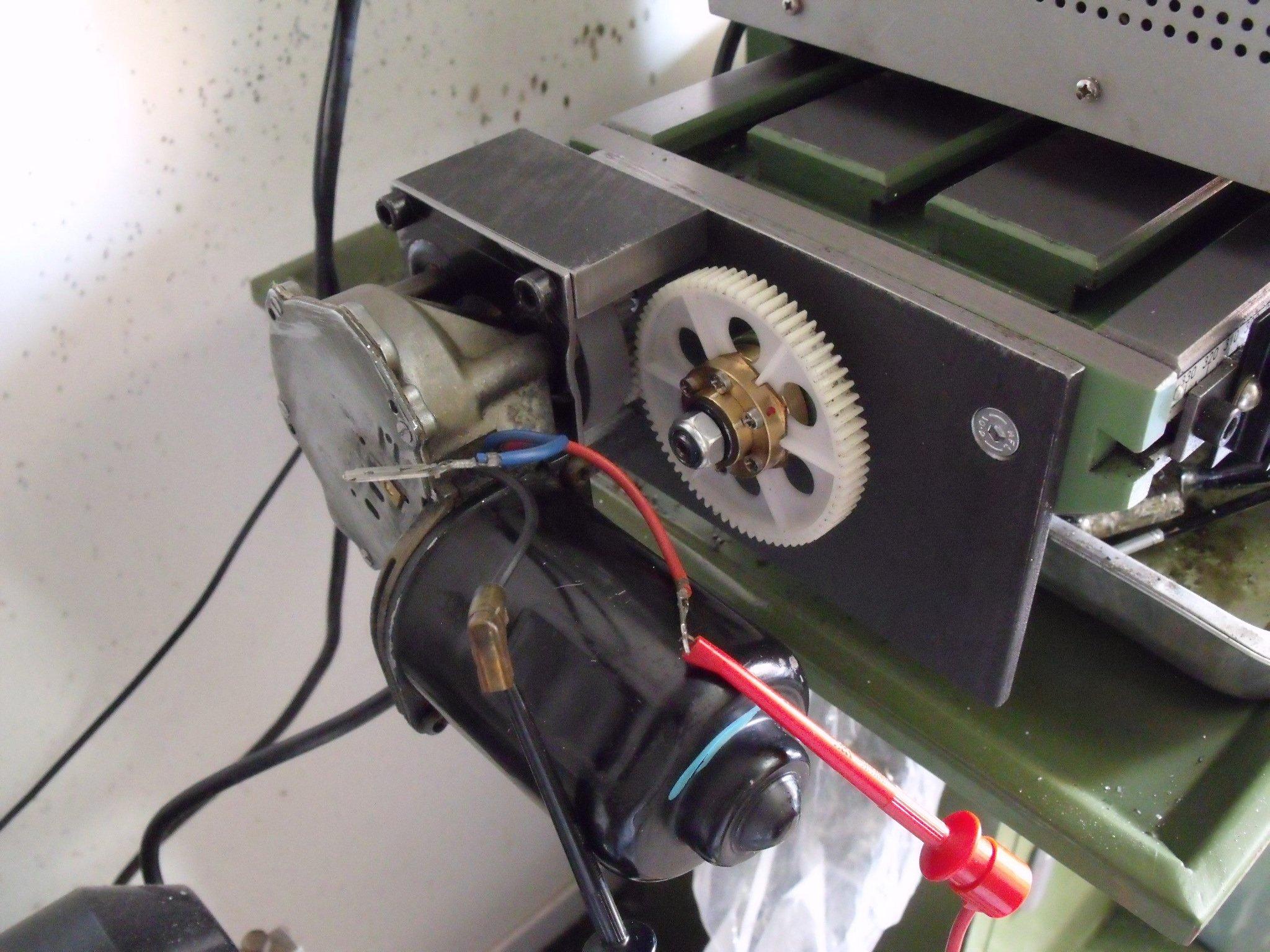

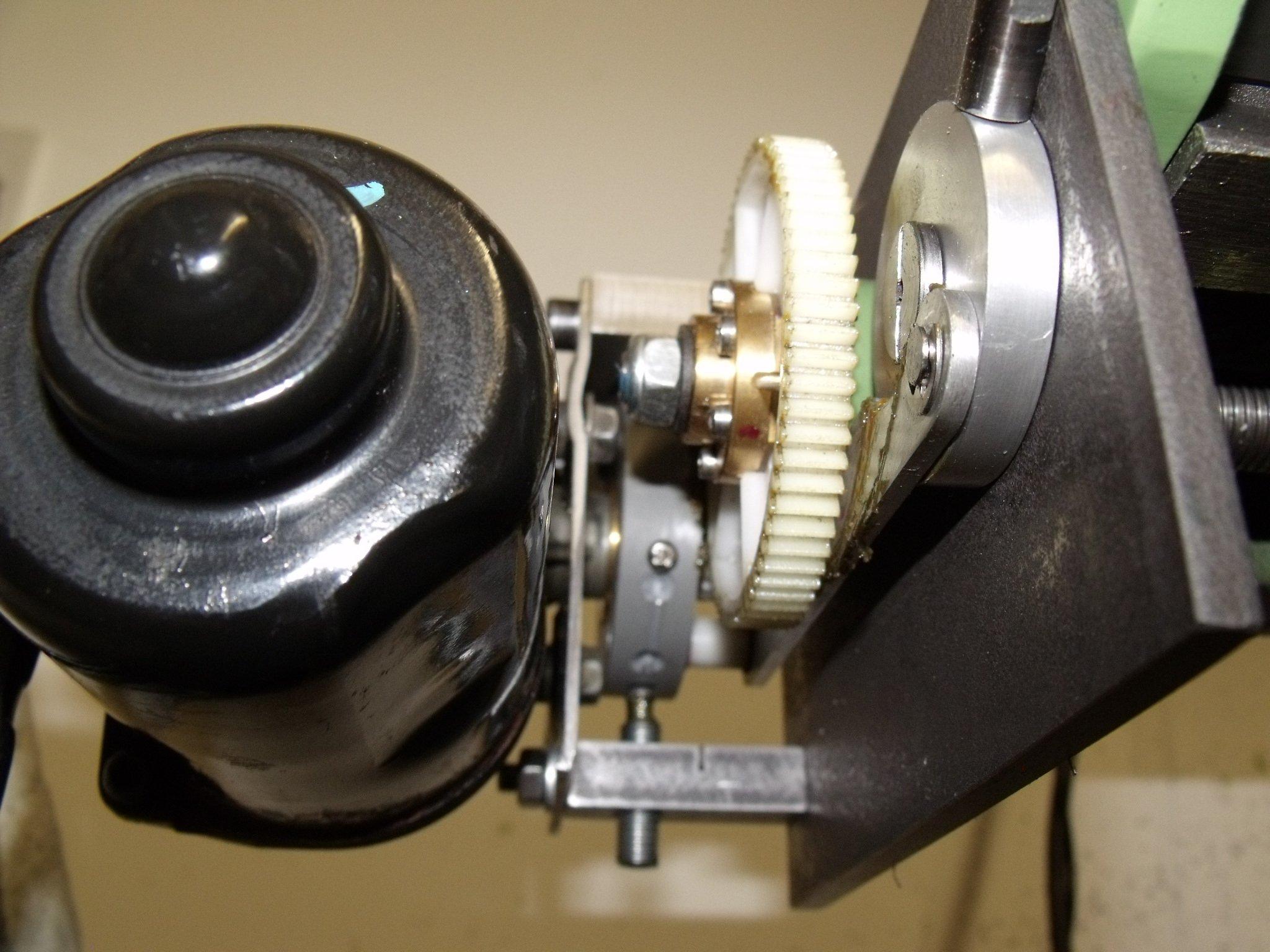

« Reply #14 on: December 24, 2014, 12:40:33 PM »
Hi Dave,

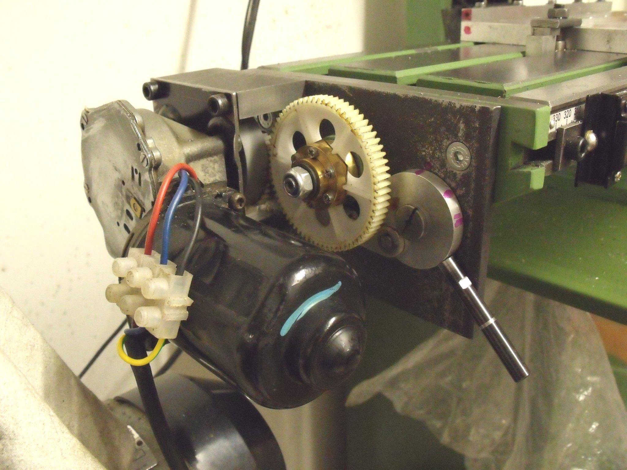

I used a car wiper motor for my mill table feed.  I used a tumbler mechanism to reverse the drive direction and a variable voltage power supply to get variable feed rates.
Best Regards:

« Reply #16 on: December 25, 2014, 12:27:22 AM »

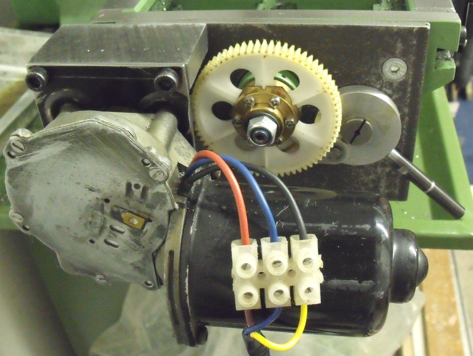

Hi Dave,
This is actually the second version that I built, the first being a little slow because the gears were too large.  This one also has the motor and output shaft on the opposite side.
In use I find that anywhere between 6 and 18 volts covers the range of speeds that are most useful.  I can bump up the voltage to 30, but this is really only a medium traverse speed, about 5 meters a minute.
If you want more details let me know.

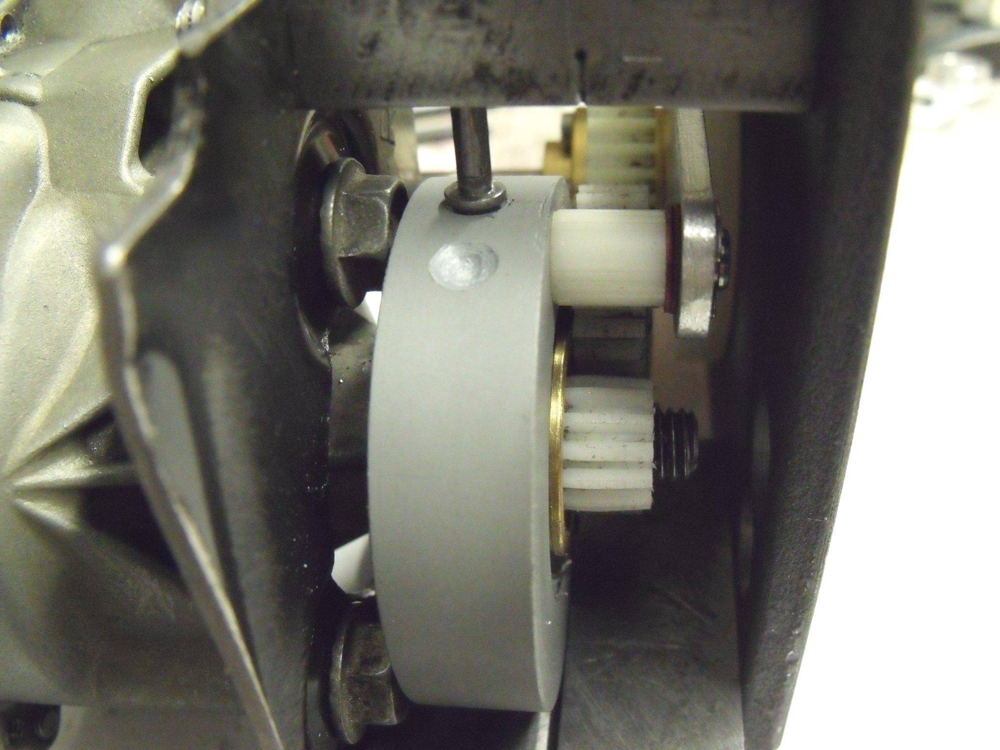

Hi Dave,
The first two pictures are general shots of the drive taken whilst testing and making the tumbler lever.  The next two pictures are from underneath showing the indent mechanism to provide positive positions for the tumbler.  There is a strong spring (not shown) used to press the long boiler rivet head into the indent, placed over the rivet shaft.  The bottom picture was taken whilst testing that it actually worked to drive the mill table as desired.
