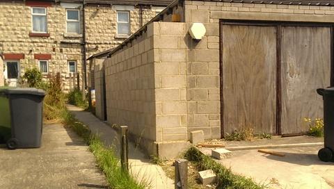

Any one interested in seeing my workshop extension? long term project nearly done.
Built this 18 years ago, cheesed me off that I had to chop 2 foot off the width and got talked out of a pitched roof, the lesson to be learned is build it as BIG as you can.

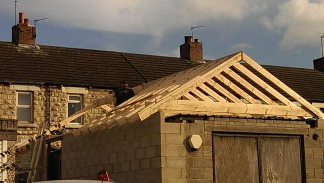

So I got the joiner to get the wall finished and build the roof structure, now we are about two weeks off tiling the roof.

Started in late July, delayed by planning app snag, any way slow progress as I've never laid a brick or a block before, a mate built this when we  were young(er)
The idea is to build a wall with piers returning at both ends they are attached to the wall with wall starter kits there are pillars every 6 courses along and a portal frame for the doorway.
The existing wall will stay up until the roof is finished, once it's all watertight I intend to drop the now internal wall leaving nibs of the old wall up as support
The roof is made up of 6" rafters 9" joists should get some storage space up there !

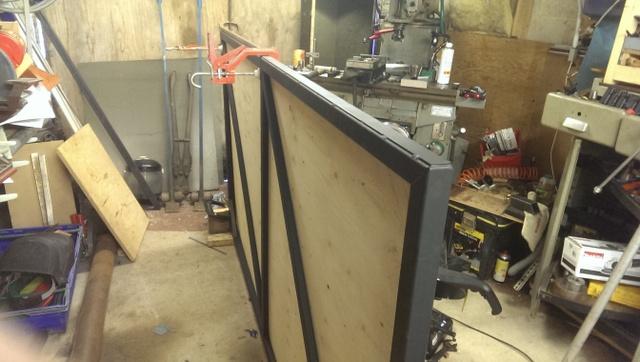

Made this a while back as the doors need doing as well
