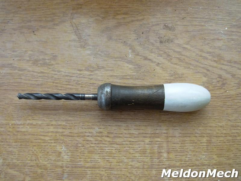

Hi Guys
              This is a little deburring tool a made up from a drill and file handle which I have found to be so useful for many years. The handle is painted white to stand out from all the other tools that have file handles.  The drill on this tool is 1/4inch and is the one I use most frequently.
                                                    Cheers David

I can see that working ok on right angle edges?
Apart from straight edges I prefer to use my 20yr old knife far better than those Noga types and 8 times quicker.

Hi  :wave:
I use something similar only it being a spare HSS 60* countersink bit fitted into a file handle  :thumbup:
George.
