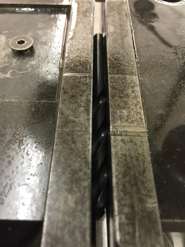

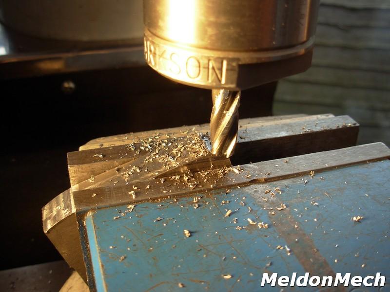

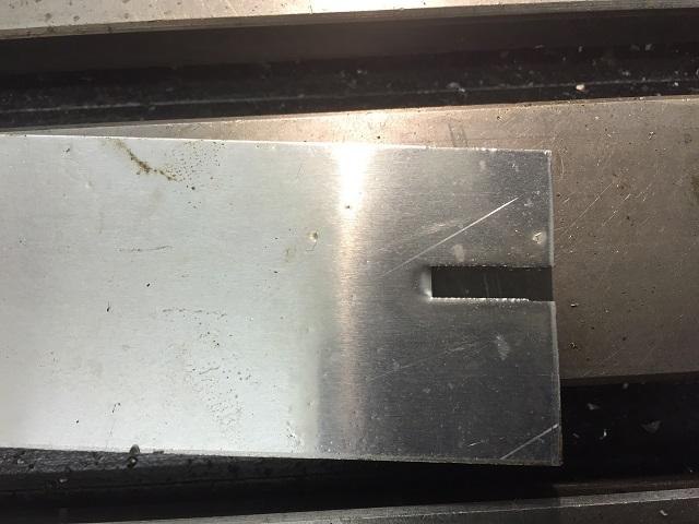

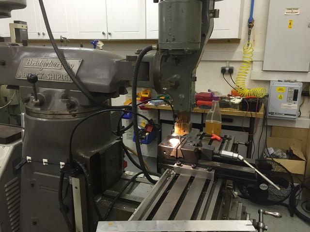

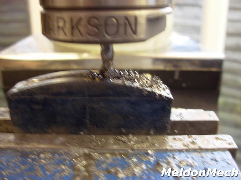

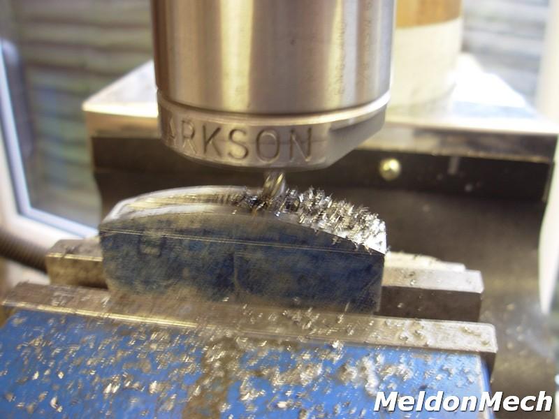

First results are very encouraging  :ddb:

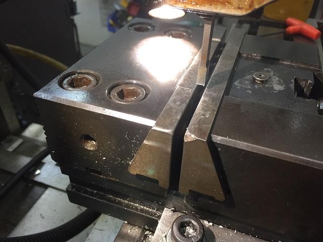

Not having a suitable punch and die to hand, I reached for a 5 mm slotting tool that I already had for the slotting head - but what to use as a die  :scratch: For a rough and ready test, just really to see if there was enough ooomph in the system to slot 2 mm aluminium I hit on the idea of setting the vice jaws slightly over 5 mm and using them as the die. OK no shear action at the front and back, only on the sides. But this is just 'proof of concept' not full implementation  :lol:
How do we space the jaws - suspend a 5.2 mm drill on a parallel, screw the vice tight and see what happens. Turned out far better than I'd expected, and certainly worth developing as an idea. Only issue was the lack of a stripper plate to stop the victim aluminium sheet being lifted by the punch as it withdraws. But for a first attempt I'm very pleased.

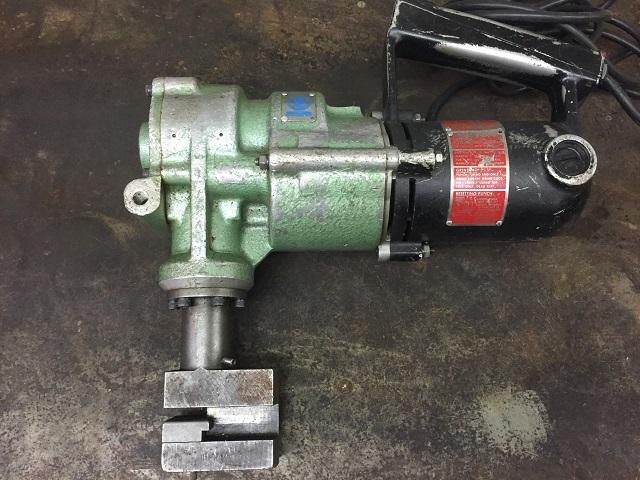

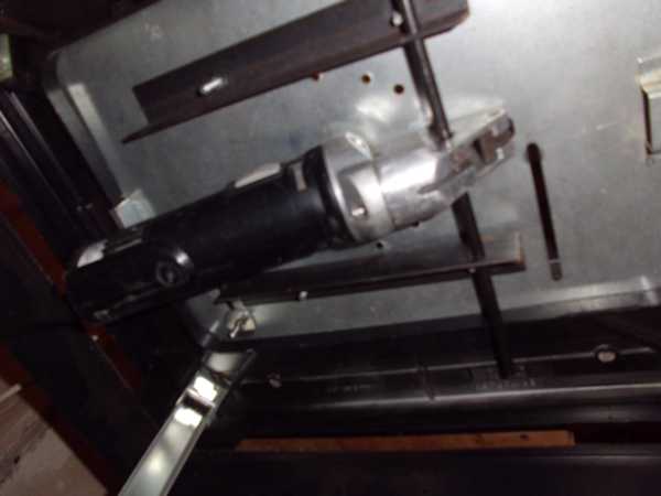

Bridgeport had to be turned back into a mill today so I had to break down the trial set up. I'm coming round to the idea of a conventional nibbler arrangement set into some form of fixed table. I have several nibblers ranging from the air one mentioned, up to a monster that will cut through 6 mm mild steel and scares the wits out of me when I use it :bugeye: I may investigate mounting the big scary one in a table and see how I get on !

Wow a 6mm cut with a nibbler. Think I'd be cautious of that too.

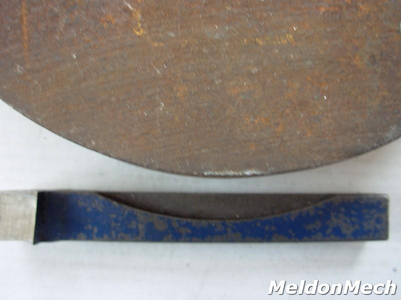

Re: Using a Bridgeport Slotting Head as a nibbler ???
« Reply #12 on: November 06, 2014, 03:33:29 AM »

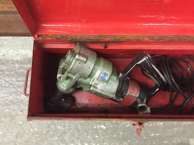

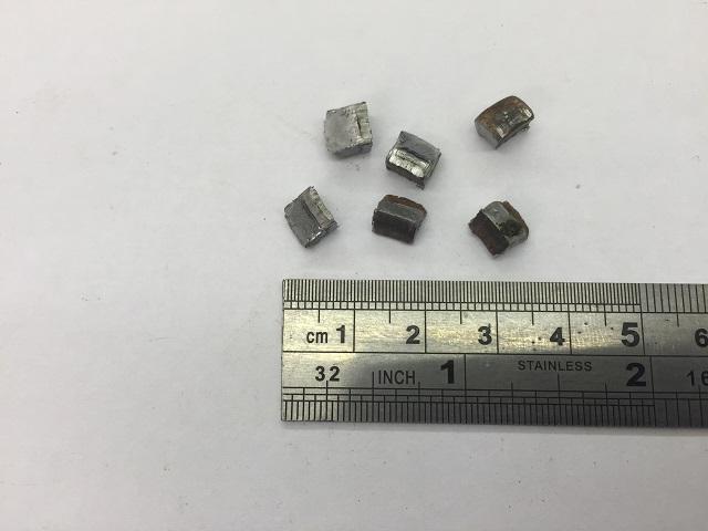

It spits out 6 mm cubes of mild steel at a great rate of knots  :bugeye: It's also pretty heavy to hold. I took a few pictures - it eats through 6 mm plate at an alarming rate !!!
