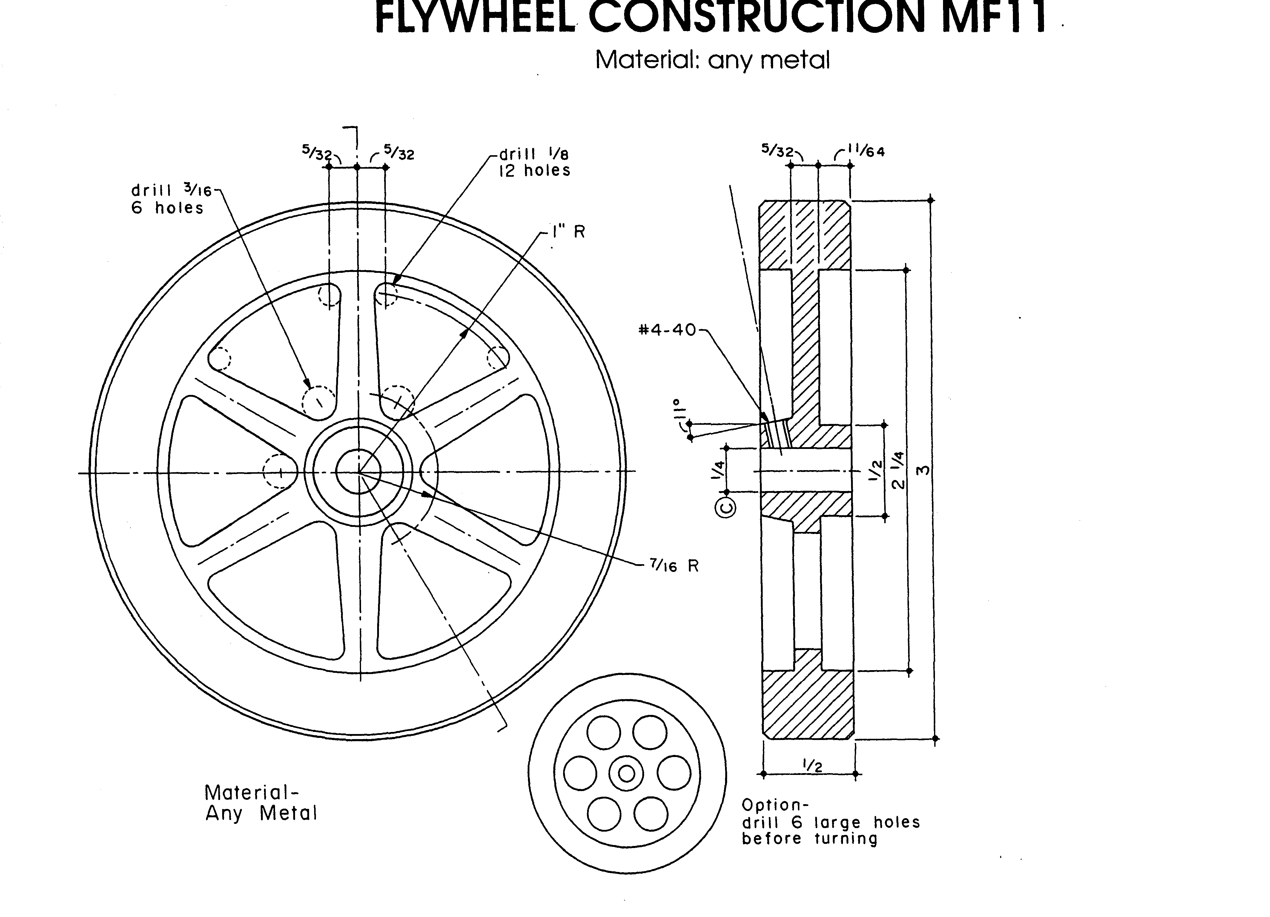

 I am researching making patterns to cast al flywheels. I found a drawing from Elmer Verberg’s info at the Jon-Tom website. How do I machine the tapered spokes,  shown in the drawing below, on a rotary table? I can understand the setup for drilling the corner holes for the cutouts, but how do I offset  for the taper of the spokes?
