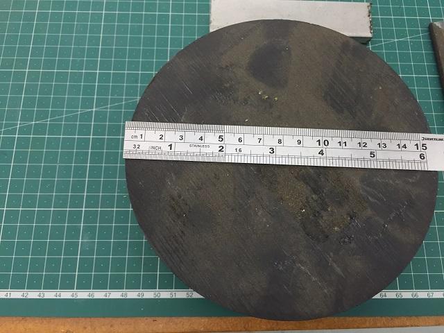

Anyone know, where I can source 35mm dia graphite in the UK. At sensible cost?   :scratch:

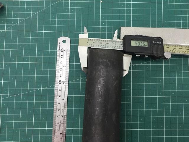

David,
The attached pictures may be of interest - it's Poco brand EDM graphite from my stash of things potentially (Pun intended  :ddb: ) to make electrodes from. POCO is a very fine grade of graphite for fine details
Re: Scott Vacuum Engine......
« Reply #16 on: November 15, 2014, 09:54:22 AM »
By, 'ek, Andy!  :bugeye:
Yer've got me attention, now!   :D
Switch to pm's, I think.......  :thumbup:
« Reply #17 on: November 15, 2014, 09:59:00 AM »
David,
Tell me how much you want sawed off the (presumably) 2" piece, PM me an address and give Eric a donation in my name to the running of the site for what you think it's worth to you.
I ain't turning it down to 35 mm for you - my lathe is reasonably clean  :lol:
