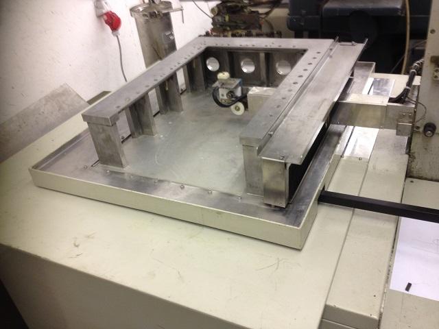

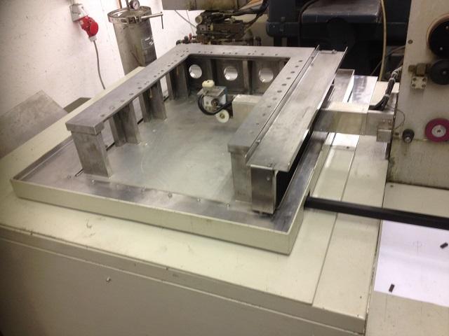

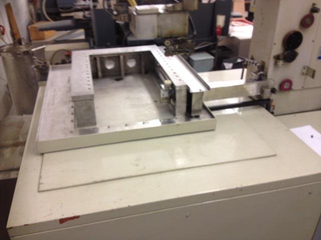

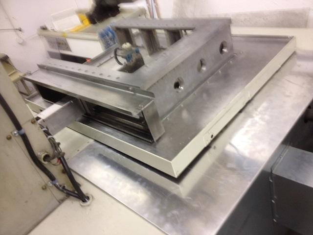

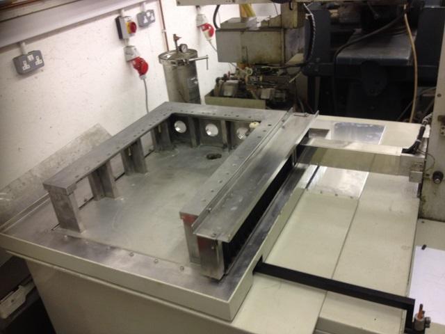

Well I went ahead and tapped the holes. Horrible in soft aluminium.
On assembly amusingly it became obvious that one of the 'inner' holes (ie nearest the table) actually isn't accessable in any position of the table to put a screw in  :scratch: (See picture 'Bottom-Left') Anyway I went ahead using some stock 6 mm pan head screws packed with washers so that they don't project below.
It basically works - I did have one nasty moment when moving the table about and it caught - one screw was sticking down ever so slightly - had that been on automatic programmed movement it would have torn the cover apart I suspect.
Here are some pictures showing the limits of travel to illustrate how the cover is pulled about over the base of the machine

Now the cover rectangular hole is larger than the bit of the machine that pushes it about so there is deliberate 'lost motion' (or back lash if you like) - to illustrate this I've centred the table then show the cover able to slide a fair way back and forth - (same looseness is there side to side) :

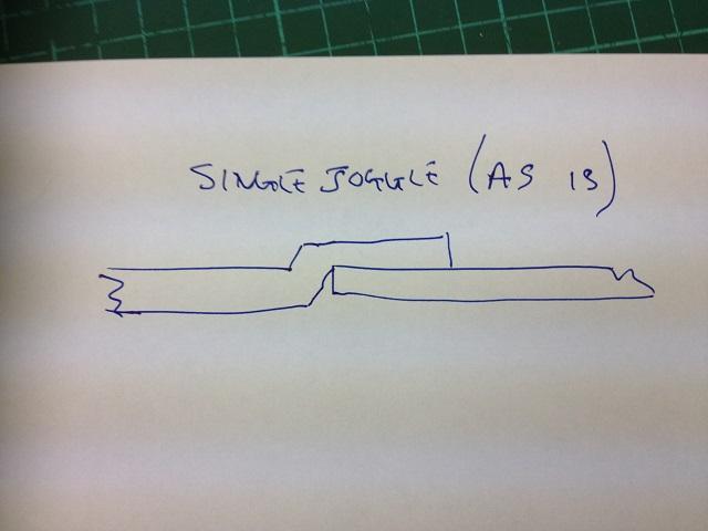

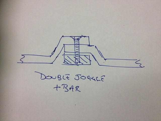

Now I don't think that this method of joining the two halves is a satisfactory design. Currently there is a single joggle allowing the original half cover to rise over my new one. It must have been the top element evidenced by the counter sunk holes in it.
However I believe that a 'double joggle' so that the top cover is offset 4 mm and the lower one by 2 mm allowing a 2 mm stainless steel strip to take the threads would be a far better design.
I'll see how she goes 'as is' as forming joggles accurately isn't something I've done before.
Crap-O-Cad drawings depicted below

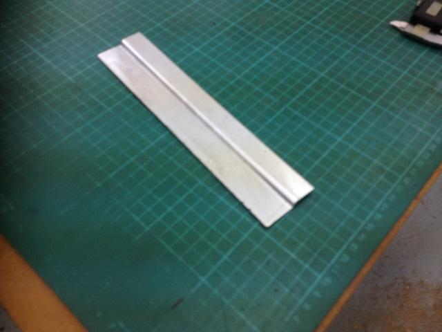

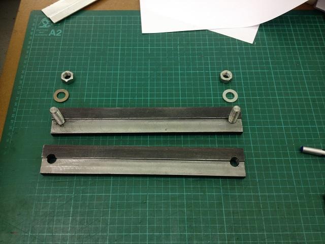

« Reply #78 on: October 10, 2014, 10:42:47 AM »

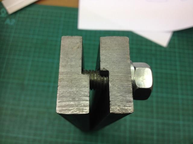

So what do you do if you've never joggled, haven't got a joggler, and want to joggle  :scratch:
Well you do a bit of googling  :coffee: then set to and make one - obvious really  :ddb:
I need to joggle about 8" wide in 2 mm aluminium plate and have a 2x material (ie 4 mm offset) on the joggle. Finding a 22" length of hot rolled bar I halved it, then milled suitable steps in it to form the offset. Really the corners should be rounded, especially if the bent component is stressed, but this isn't and I didn't  :ddb:
Then I drilled and tapped for a pair of 12 mm studs, so the joggler could be clamped in place while the (rather large) part is manoeuvred into place on the press.

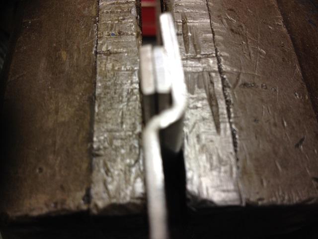

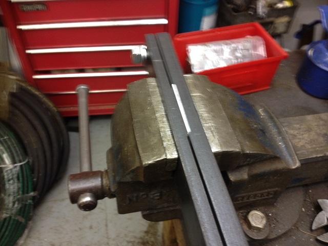

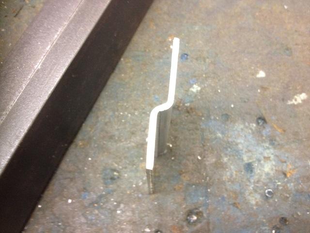

Then we need to try it out. First a small offcut in the vice, and check the offset is correct

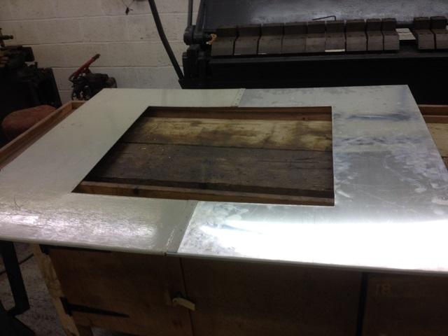

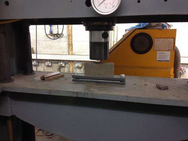

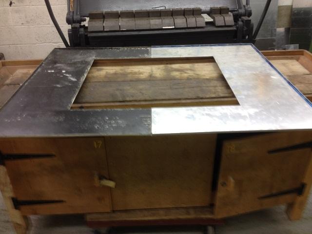

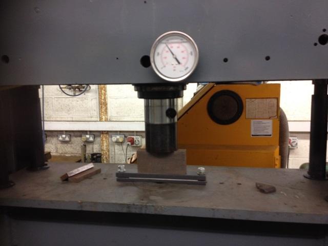

OK that was painless - now we need to do a full width test - actually this bit is a bit wider than the cover bits that I need to joggle.
Too big for the vice I think so lets use the workshop press
« Last Edit: October 10, 2014, 11:17:46 AM by awemawson »
  • Posts: 9051
Re: Titivating a Wire EDM Machine
« Reply #81 on: October 10, 2014, 10:48:18 AM »
That was about 25 tons - probably a bit enthusiastic as the mill scale marks came through on the aluminium  :ddb:
Anyway it seemed to work ok
« Last Edit: October 10, 2014, 11:20:42 AM by awemawson »

So now I need to pluck up courage to do the actual bits on the cover, but first I need to convince myself that I can afford to lose the length from the cover that the joggle will gobble up - need to take some measurements

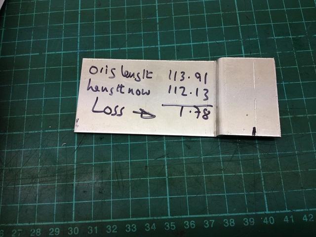

Tests & measurements completed here are the results.
Total loss of length having joggled a piece of 2 mm aluminium = 1.78 mm
Extra free movement available = about 5 or 6 mm - phew !
The length loss at 1.78 mm is far less than I'd expected - odd things happen when you bend sheet metal !
The cover slides in the  (say ) Y axis and is limited by its down turned flange coming against the 'kerb' on the machine base, the cover needs to be able to move for the full axis travel plus a bit of leeway - that is where the 5 or 6 mm comes from and to increase it would mean less overlap of the joggles - the joining holes are already drilled but one cover could easily have elongated slots if things are tight. I can imagine that the cover arrangement is not perfectly square so leeway may need to be increased.
Doing this exercise reminds me that one kerb is still missing - bar stock not yet arrived !

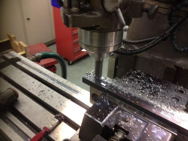

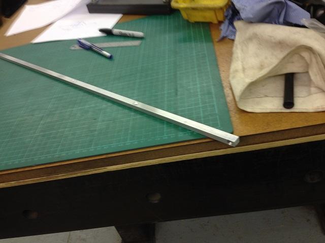

Unusual to have a metal delivery on a Saturday, but I'm glad to say the aluminium flat to make the missing 'kerb' arrived this morning in a torrential downpour.
Simple matter of cutting to length and accurately drilling and countersinking six 4 mm holes to match the exiting tapped holes in the machine - one of those 'easy' jobs that sometimes go horribly wrong, but today the gods were smiling down on me and it all fitted perfectly  :ddb:

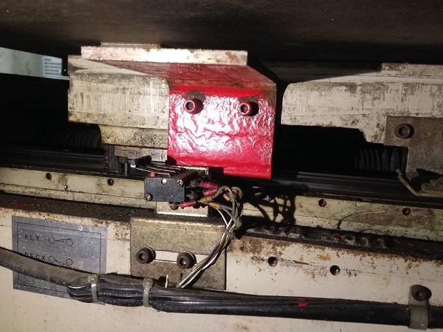

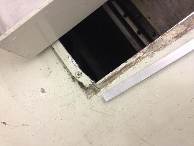

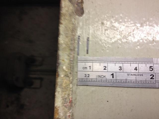

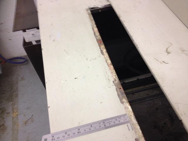

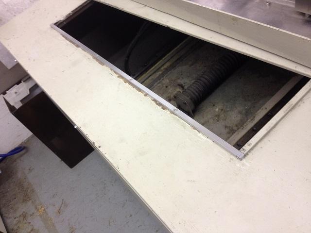

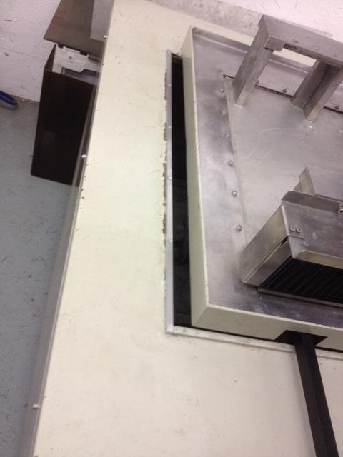

Well that was a very short lived feeling of satisfaction  :bang: :bang: :bang:
Investigating the cover joggle I moved the table to the sound of graunchings and this was what I found
  • Posts: 9051
« Reply #86 on: October 11, 2014, 09:17:42 AM »
The new kerb has been totally mangled in pretty much exactly the same way as the original was when I got it. But what is causing it  :scratch: :scratch:
Access is very difficult in the small gap between the upper stationary surface of the machine, and the lower moving surface of the table, but by using mirrors and a flexy light I found that one half of a shipping clamp was screwed to the table  :bang:
This is a short bit of angle iron, one web of which has been intent on removing that kerb when anyone fits it. Ah well at least now I know, and I can remake another kerb, but first I need to find a way to get at the shipping clamp to take it off. A very long allen key is called for. That angle web must have just cleared the machine upper surface.
.... off to order some more aluminium  :ddb:

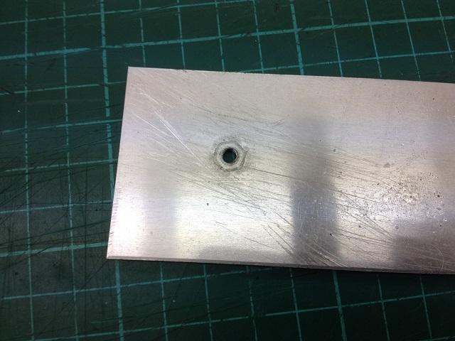

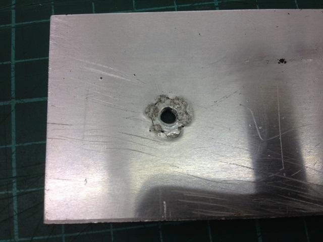

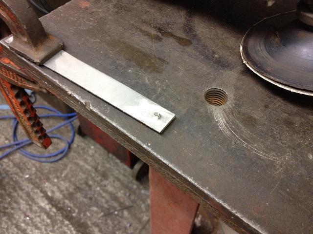

Having made the joggler, that works splendidly, I've decided to jump another way  :ddb: I wasn't happy with the extra height created, as it would leave barely 2 mm clearance above to to the machine table.
So on the suggestion of a member of the MIG Welding Forum, I've been experimenting pressing nuts into the thickness of the 2 mm aluminium sheet to make a re-inforced thread, and it seems to work really well
  • Posts: 9051
« Reply #90 on: October 12, 2014, 07:31:04 AM »

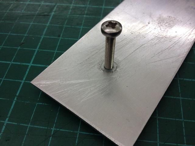

On the actual cover I will use half nuts pressed from below to leave a ledge for strength - that was a full nut that started as 3 mm thick but got squashed to 2.3 mm > Needless to say I had to re-thread it !
I will need some M4 x 4 mm csk screws that I cannot find commercially so I shortened some 6 mm ones using a springy clamp made from two bits of 1 mm stainless and an angle grinder !

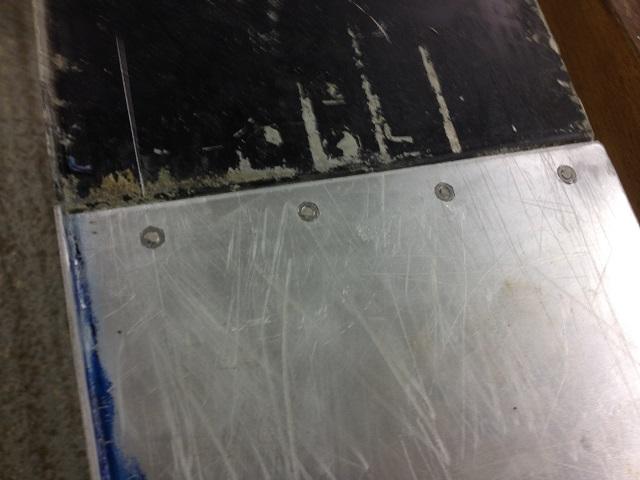

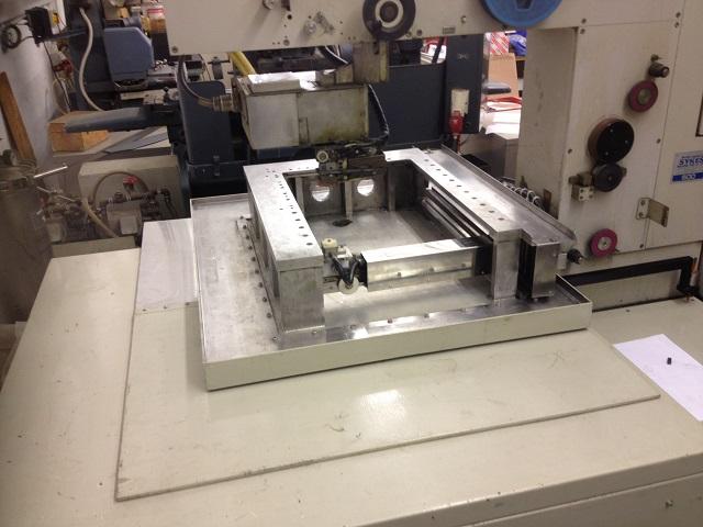

At long last I think I've sorted the sliding cover fixing.
The pressed in nuts seem to work a treat, and I ended up pressing in 'half nuts' which in M4 measured 2.09 mm thick - pretty well ideal for the 2 mm sheet that I'm working with. It was a bit of a fiddle balancing the cover on the press but I got there in the end.
With my truncated screws there is no projecting below the panel - so hopefully jamming will be a thing of the past.

Replacement 10 x 8 mm aluminium bar arrived today so at last I've re-made that mangled kerb, and re-fitted the sliding covers. They seems to slide nicely with no bits catching this time (fingers crossed) - I've been up to the axis limits in all directions.
It's taken a while for two reasons - firstly deciding on the cover joining method and experimenting with it, and secondly waiting for the bar stock and stainless M4 half nuts to arrive. Covers will have to come back off in a few weeks for painting, but I'll treat that as a separate job as several panels need painting.
