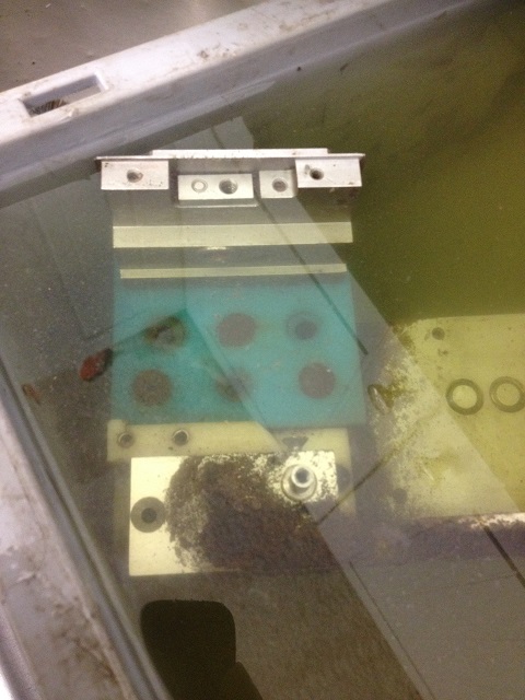

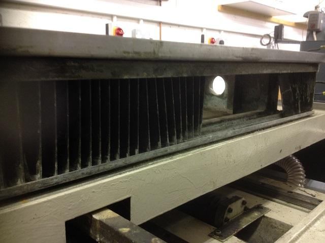

« Reply #25 on: September 25, 2014, 09:18:23 AM »
However if you contrast these two pictures you can see it is progressing

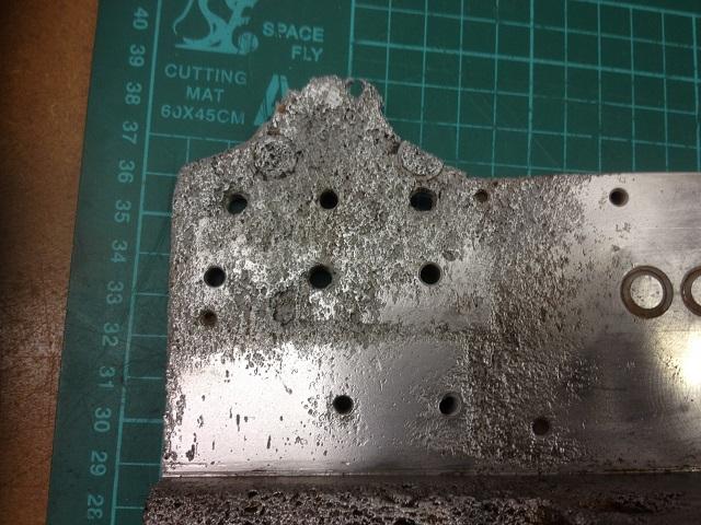

« Reply #27 on: September 25, 2014, 06:18:55 PM »
Hi Andrew , Interesting post and well explained. It looks like the acid is doing its job, good luck with the project, I will be interested to see it running, I remember seeing skips of the used wire in the scrapyard.

« Reply #28 on: September 26, 2014, 11:09:49 AM »

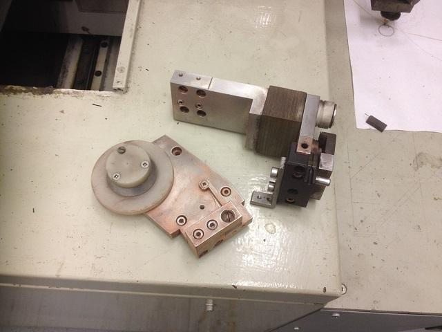

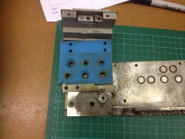

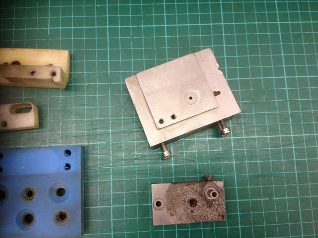

A few more hours in the citric acid bath and at last things have come up reasonably clean - certainly enough for me to be able to start dismantling with some confidence of success.
  • Posts: 9051
Re: Titivating a Wire EDM Machine
« Reply #29 on: September 26, 2014, 11:11:19 AM »

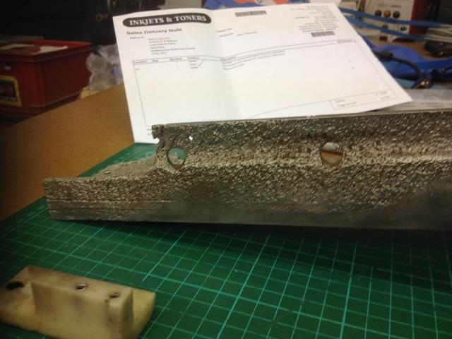

My main concern was getting the insulators off without cracking them. They are machinable ceramic, so could be re-made, but that stuff is horrendously expensive
  • Posts: 9051
« Reply #30 on: September 26, 2014, 11:12:47 AM »
The other metal bits were less of a concern. Amazingly some of the screws actually unscrewed, however several had lost too much material from their heads in the hex socket and had to be carefully drilled out
  • Posts: 9051
« Reply #31 on: September 26, 2014, 11:14:18 AM »

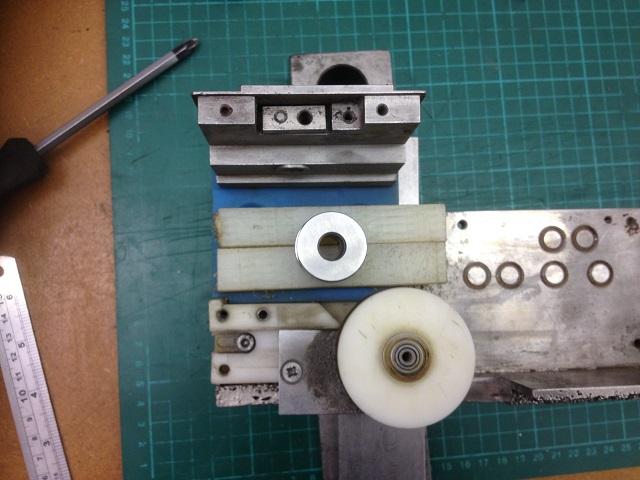

The part that holds the bearing for the lower wire pulley will need re-making as it is going to have to hold the new contact electrode as well as the pulley - this is it:
  • Posts: 9051
« Reply #32 on: September 26, 2014, 11:15:51 AM »
I seem to remember that I had to replace that shaft that sticks out of it when I re-did the bearings when I got the machine in the first place.
Now to try and remember how they all fit back together  :scratch:

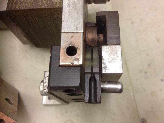

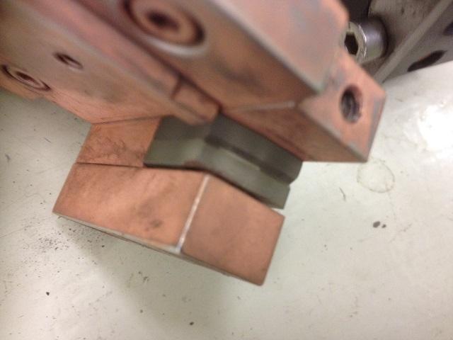

  • Posts: 9051
« Reply #33 on: September 27, 2014, 10:23:26 AM »

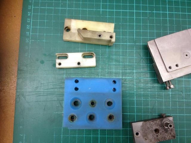

A little bit of progress today - mainly taking decisions as to which way to jump.
It would have been much easier to mount the new Tungsten Carbide contact to the outer side of the wire (ie lhs looking at it), this way I could re-use the existing pulley mounting. However it would be in the way when re-threading the wire and make an already tediously hard job harder.
So I decided to let the wire touch the contact tangentially, and  wrap it round the contact by taking the pulley nearer to the machine body - ie to the right as you look at it. However this meant slightly modifying the arm to make room for the pulley
« Last Edit: September 27, 2014, 11:30:36 AM by awemawson »
  • Posts: 9051
« Reply #34 on: September 27, 2014, 10:27:21 AM »
It was a bit like cutting hard swiss cheese - all very porous.
In the picture below, the two white nylon bars represent where I will mount a delrin insulator onto which the contact will mount using a stainless steel stubby axle. The end of this axle will take the power connection.
Slab of delrin, and a bit of stainless bar to re-make a longer pulley mount are on order, along with numerous stainless cap screws

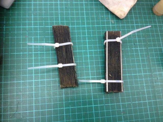

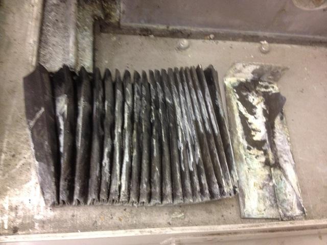

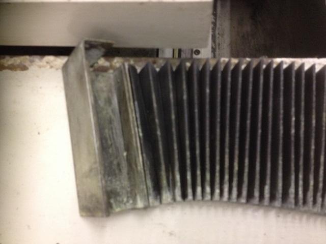

Being at that frustrating point of 'waiting for bits to arrive' I've embarked on trying to clean up and restore the concertina 'curtain' arrangement that is suposed to stop water splashing out of the working area of the machine.
When I got my machine the curtains were flapping about, the far one is torn in several places, and the sliding seal mechanism that surrounds the arm and holds the inner end of the curtains is missing
  • Posts: 9051
« Reply #36 on: September 29, 2014, 03:50:37 AM »
Now a few years ago I had the opportunity to rescue parts from a 'Model L' Fanuc Tape Cut (mine is a 'Model M') - the 'L' has a smaller operating envelope, so for instance the arm that I'm working on is a smaller cross section.
However I did manage to get the curtains, and although encrusted with detritus it turns out that they are the same size (110 mm tall) as the Model M. So after a week end soak in citric acid they've come out perfectly usable - a result  :thumbup:

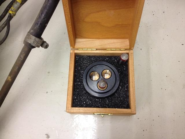

What I hadn't appreciated, when I robbed the donor machine, was that I had obtained a pair of 'grooved ditch' wire guides and their mounting. I frankly hadn't recognised them as what they are. These are a slightly less precise method of location for the wire, but vastly easier to thread. Using them will need quite a bit of adaptation - the upper one will just bolt straight on, but the lower one will need a bit of engineering, and both will need provision for flushing nozzles.
  • Posts: 9051

Note the delicate 'salmon pink' copper deposits - these were covered in crud like everything else, and a dip in the acid bath has cleaned them, but I suspect this machine had been cutting copper, and the copper oxide crud, and the acid has plated the stainless steel ! It'll come off easy enough later.
Fitting these will be another project - they'll be put to one side for now.

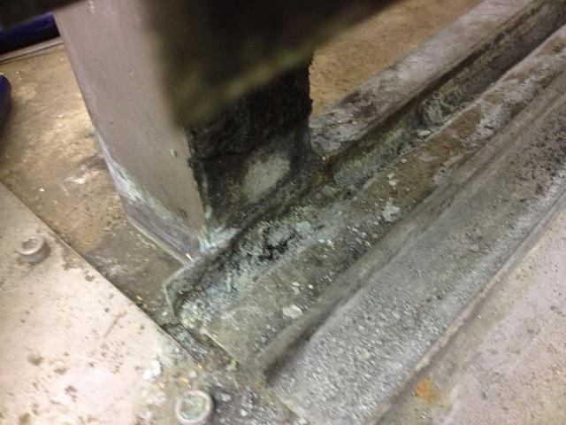

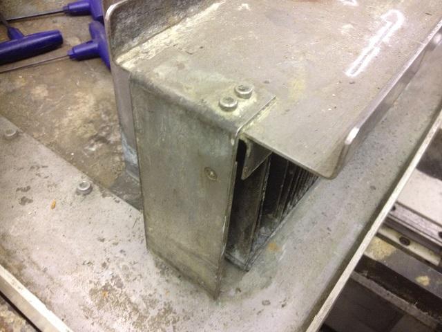

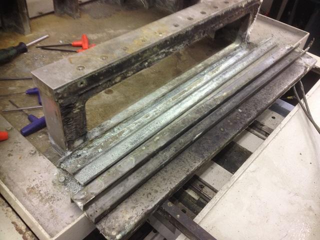

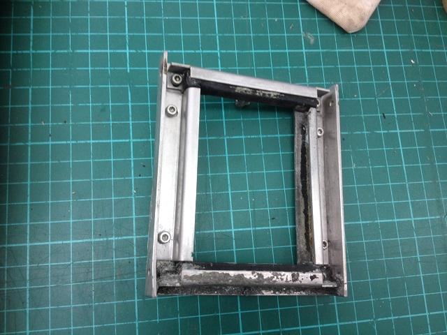

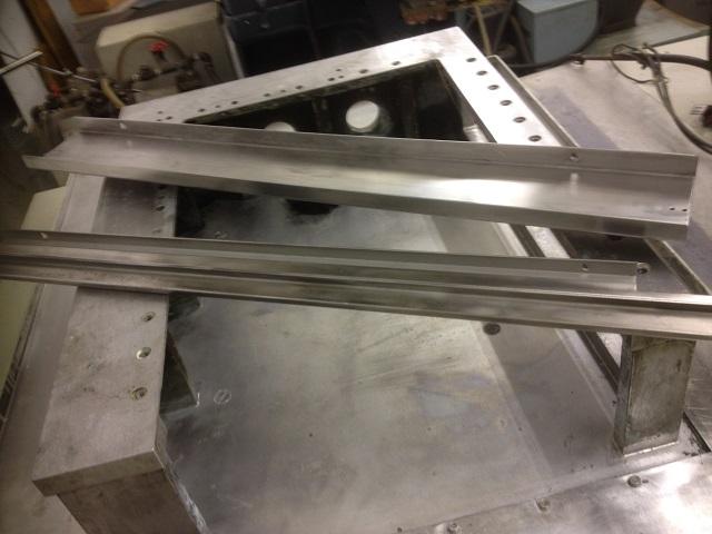

So now to start dismantling the upper and lower runners for the curtain - all pretty fouled with accumulated build up of residues, now caked rock hard.
Starting with the brackets that tether the curtains on the outer edges
  • Posts: 9051
« Reply #41 on: September 29, 2014, 12:25:37 PM »

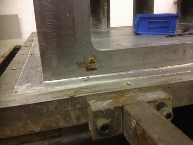

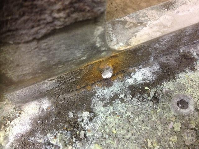

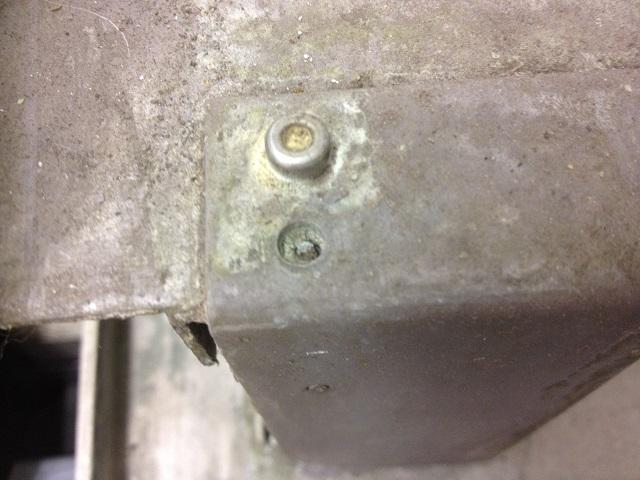

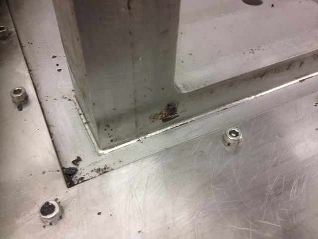

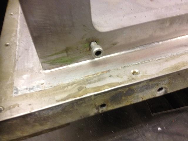

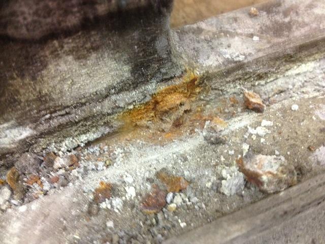

Then remove the 'upper track' - easy so far but this revealed a problem.
Some plonker in the past has mounted the lower track using ordinary HT cap screws, not stainless ones  :bugeye:

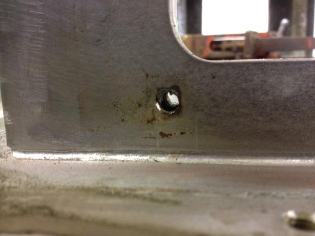

  • Posts: 9051
« Reply #42 on: September 29, 2014, 12:29:23 PM »

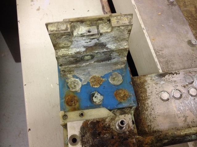

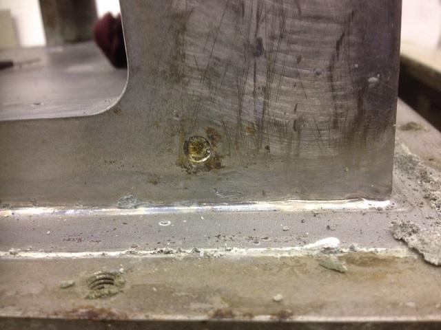

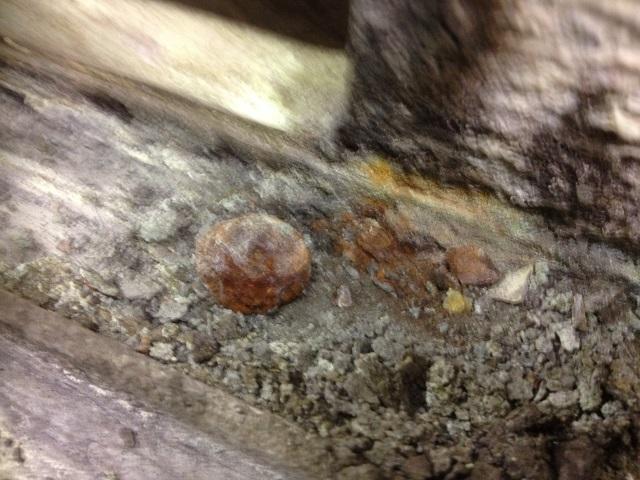

Only two rusted cap screws, but in a confoundedly awkward place. As they are so low down on the base, the tray that surrounds the work space limits access.  :bang:
The rear one had entirely rusted the head off, and the front one was so nearly completely gone that there was no chance of gripping it to unscrew, so I ended up grinding the remains away to allow removal of the lower runner

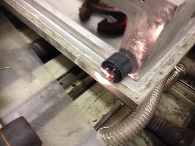

This has at least given me access to clean the work area up a bit - I'm actually amazed how well it's come up, and I'm not finished yet.
This is the result of the 'first clean'  :

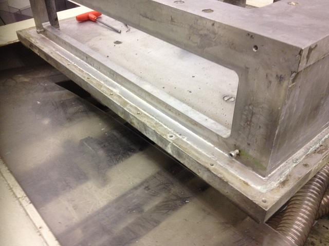

  • Posts: 9051
« Reply #44 on: September 29, 2014, 12:35:49 PM »

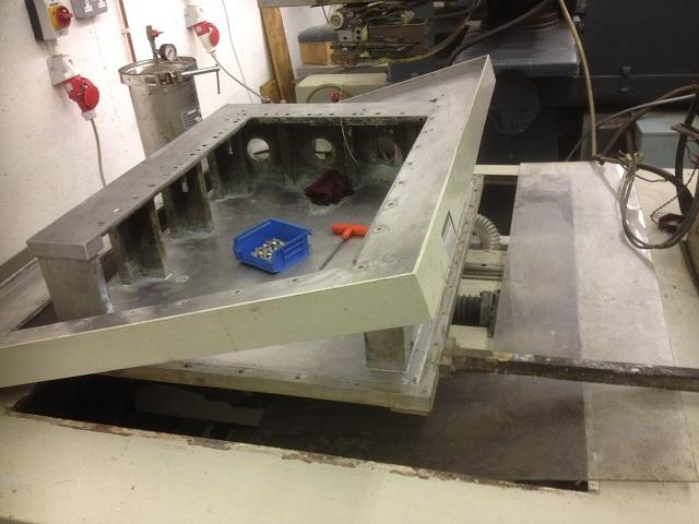

Now to get at those rusted screws I will almost certainly have to remove the stainless steel 'tray' that surrounds the work area. A pain as I didn't really want to delve in so far, and it's going to need sealing back to prevent leaks.

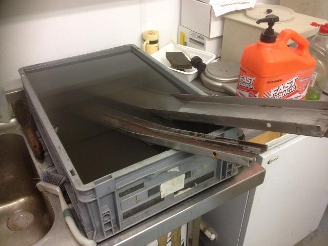

Meanwhile the runners are soaking in phosphoric acid (running short of citric !)
So how to drill out and re-tap these pesky screw  :scratch: Any suggestions welcome if they mean I don't have to remove the tray - distinct case of 'scope creep' here  :lol:

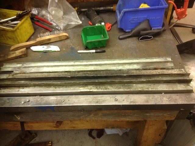

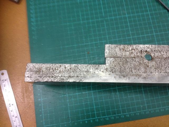

  • Posts: 9051
« Reply #45 on: September 29, 2014, 01:49:53 PM »
The 'curtain rails' have cleaned up really well. It took quite some soaking, and scraping, and certain bits were so caked I had to sand blast them, but the result is more than acceptable. Quite surprising seeing what a state they were in  :ddb:

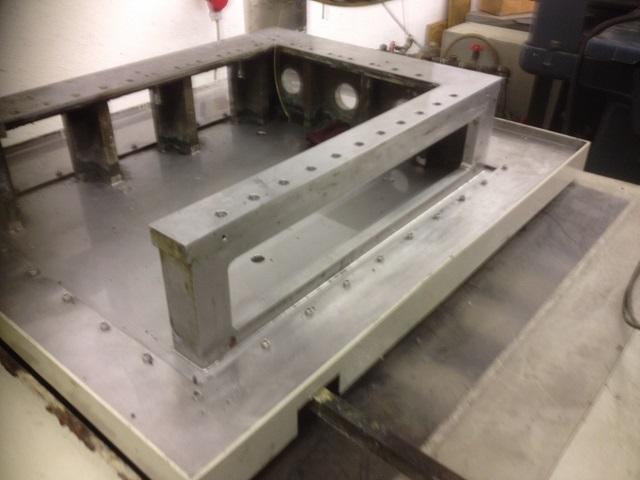

« Reply #46 on: September 30, 2014, 03:48:16 AM »

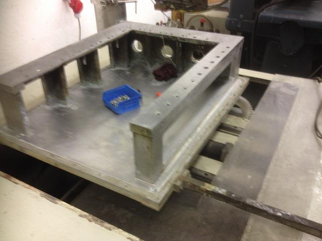

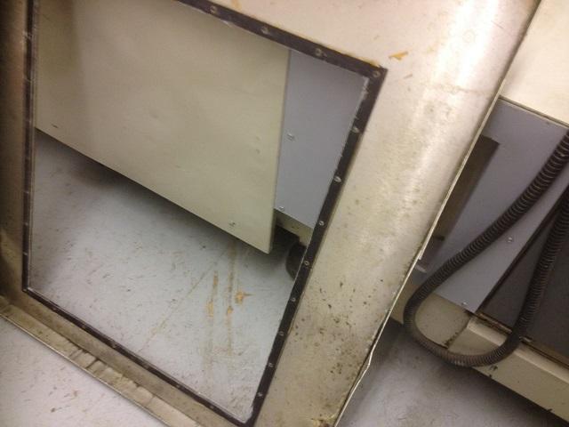

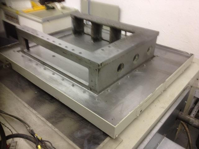

So in the absence of any other ideas I took the bull by the horns and removed the 'tray' that surrounds the work area. 32 screws later it was off giving far better access to the rusted screws
  • Posts: 9051
« Reply #47 on: September 30, 2014, 03:53:47 AM »
Fortunately the rubber gaskets that seals the tray to the main base remained stuck firmly on the tray and came away cleanly with it. There is evidence of silicone sealant having been applied previously to this joint and I will probably do the same on re-assembly.
So the next job is to fabricate some sort of drill guiding jig to clamp on to avoid boo-boos.

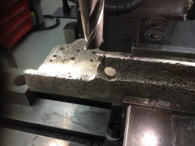

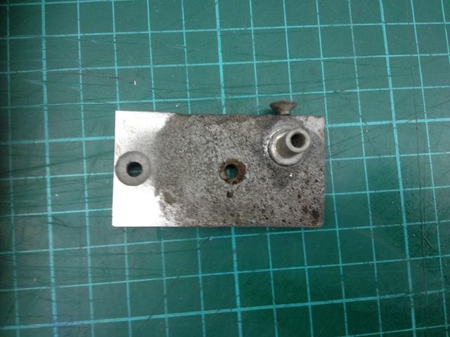

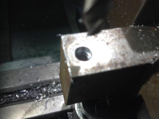

So Robert the Boar is now playing Piggy Back with Blossom and I can return to drilling out rusty screws !

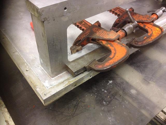

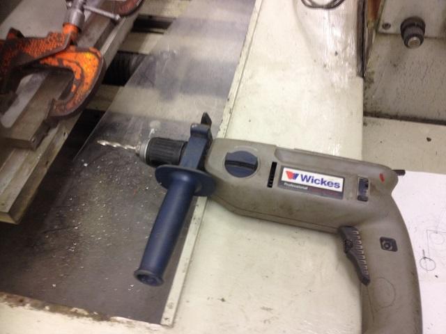

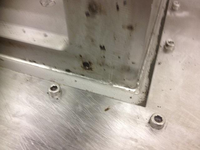

The front screw had just the slightest bit still protruding, so I could use it to centre the jig. Jig comprised a bar, through drilled 5 mm (tapping size for 6 mm) and counter bored 5.8 mm to accept the short screw stub. This I clamped on and drilled through, and eventually it came out nice and concentric,as when I was re-tapping it I could feel I was following the original thread, just clearing it.

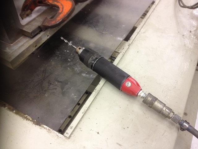

I started using my air drill, reasoning that it was more controllable in this confined space, but it didn't have enough umph and the mains electric was called in to help.
  • Posts: 9051
« Reply #49 on: September 30, 2014, 10:43:51 AM »
Now the front screw was easy to centre using the jig. Nothing protruding on the rear one, so I had to use my 'Optical Centre Punch'. Not the easiest of places to use it, especially as I had to rig a torch to get enough light into it, but it worked ok
The previous screw had drilled out happily using ordinary HSS jobber drills - not this one. Even a brand new unused drill wouldn't touch it  :bugeye: I ended up taking a trip to our nearest 'tool shop' - really just imported Chinese stuff in the main, and getting a cobalt drill. Out of stock in 5 mm, ended up drilling through at 4.5 mm and then managed to clear the last 1/2 mm with an hss drill.
Again this hole tapped out nicely following the original threads, so a success, but what a palavour just for two rusty screws  :bugeye:
Now I know what I want for Christmas - a set of cobalt drills - went through like butter  :lol:
