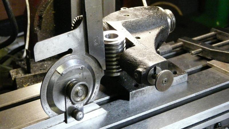

I have a small rotab. I alsko have some indexing disk 10-49 holes. They do not really fit together.
I would very much leave my rotab as it is and would like to build something different for indexing.
Next project is screaming of micrometer type dial, and I'm very tempted to try to line the dial on the lathe and index the mandrell. Probably I will construct a direct indexing feature when I will update the lathe AC motor and VFD. Meanwhile I could cobble up something at the tail end of the lathe, but would very much to use proven brass gear / steel worm construction.
So, where I could get a ready made steel worm and brass gear for indexing apparatus?
I would like to have 1:40 or 1:60 ratio to put the indexing plates into a good use.
I probably could go nonstandard ratio and use stepper motor, driver, and indexer but prefer mechanical solution here.
Any pointers? I tried to google, but found some industrial gear units and then some toys.

Straight spure gears work with a largeish worm at an angle ,the angle is related to the diamiter of the worm my one can use myford change gears up to 45 teeth , or http://www.beltingonline.com/gears-racks-366/worm-wheels-374/bronze-0-5-2-0-mod-474/ .

1. I would not rule out using plastic gears. These are cheap and light. They are not as  strong as metal gears but an indexing unit the usually has some facility to lock the spindle so the gears are under no stress during machining.
2. I would not worry to much about helix angle of the worm. As long as the  worm and gear mesh then one turn of the worm will advance the gear by one tooth. This means that you can use an ordinary spur gear for one component and make a worm to match which is a simple turning job. If you make the worm a good size then the helix angle will be small anyway.

I would go for a 90 tooth wheel gives you 4 divisions on the indexing per rev , and greater accurarcy and more divisions with youre plates .

I basically have two more immediate needs: To index few dials for lining (probably something 40-100 divisions) and simple division plate on lathe (maybe 60 or 24 division?).
If I get it right, it does not make much difference between 40/60/90 tooth wheel and and a single start worm when it comes even divisions?
I have a set of indexing plates, arms and handle for 1:40 ratio (Plate #1 has 15, 16, 17, 18, 19, and 20 holes. Plate #2 has 21, 23, 27, 29, 31, and 33 holes. Plate #3  has 37, 39, 41, 43, 47, and 49 holes). Therefore I was rushing into 1:40 division.
I have to check the divisions, but I don't think I'm missing any small divisions, no matter which 40/60/90 ratio I take.
