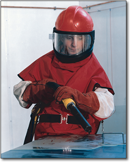

When I'm grit blasting I wear a proper Apollo air fed helmet that is supplied via it's own regulator, and a very large floor standing filter. This is Clemco's standard set up and I've never heard comments via oil in lungs (though I can see the potential problem). I presume that the element in the filter holds it back
