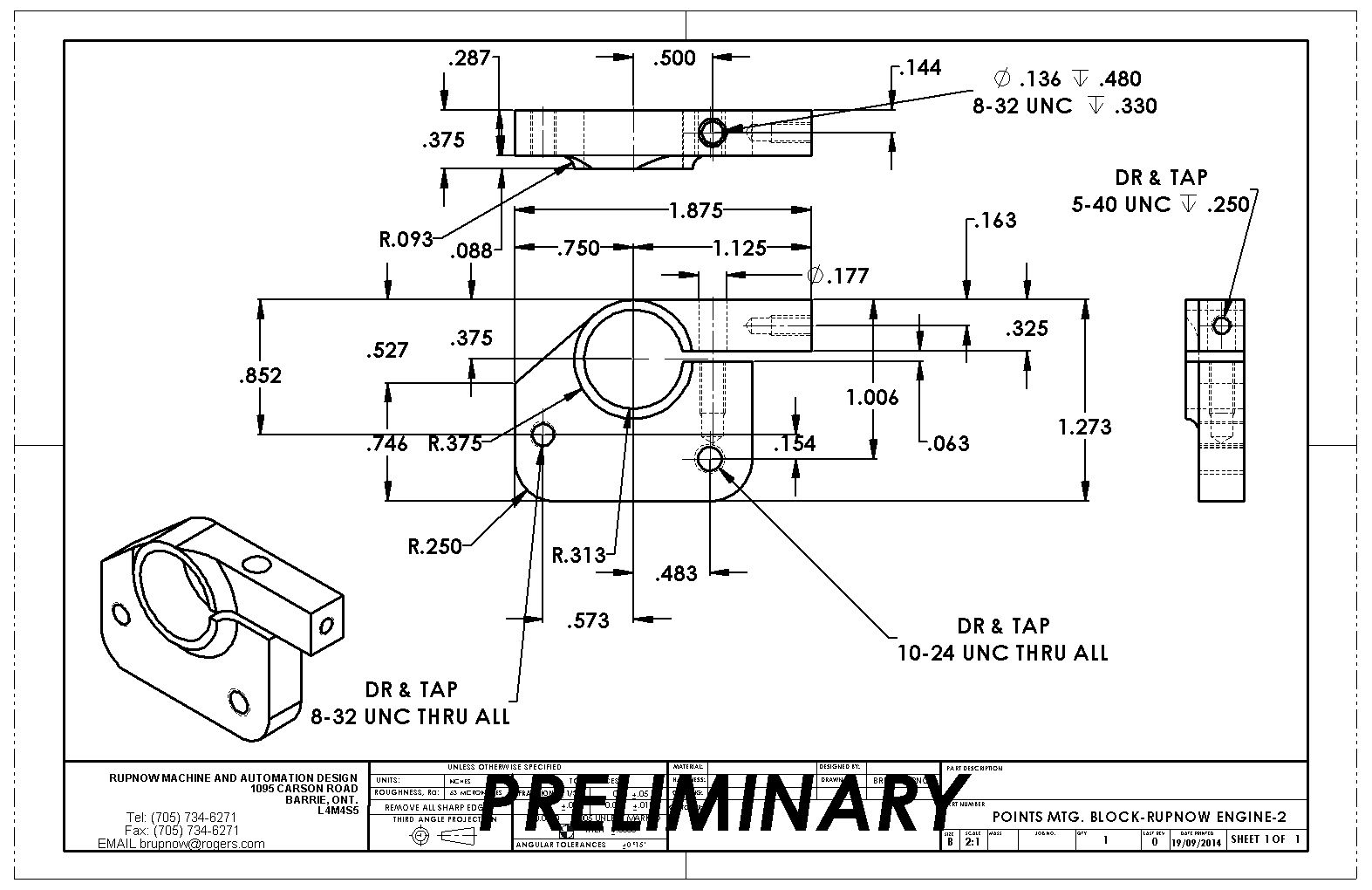

« Reply #142 on: September 19, 2014, 05:59:43 PM »
Somebody messed up, and my gasket material never got ordered. Now it's ordered and won't be here until Monday or Tuesday. This doesn't cause a huge problem, because I'm up to my armpits in "real" work right now and have no time to play machinist. This drawing is an  interesting part. I have made it before. It mounts a set of my favorite Chrysler product ignition points, and clamps onto the extended head of a crankshaft support bushing. By loosening off the clamp bolt, I can manually adjust the ignition timing while the engine is running. This is no big thing once the engine is all set up and running at its optimum timing, but it sure is a nice thing to have when first starting the engine and "setting up". I used this when I built the Odds and Ends hit and miss engine designed by Philip Duclos, and it really is a handy thing to have on the engine.
http://i307.photobucket.com/albums/nn294/BrianRupnow/BrianRupnow016/POINTSMTGBLOCK-RUPNOWENGINE-2_zpsf0d73d01.jpgSide Valve i.c. engine from Bar stock
