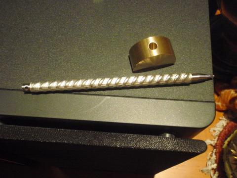

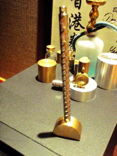

I have just finished making a pen out of 316 S/S reinforcing bar. I used HSS drill bits 2mm followed by a 3mm to drill the 6mm bar for a ballpoint refill on my 7x14 Chinese mini lathe. I plan to make a few more to give as presents, can anyone suggest a better drill bit to hollow core the bar, approx. 50mm from each side, to make the work go easer.
Cheers Mick
