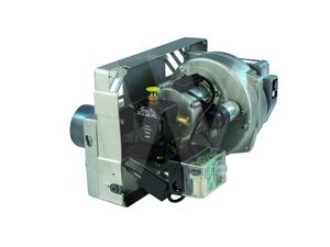

I've been poking around an oil fired central heating boiler today (one of three in our 'establishment' ) and was thinking, if I scrap it what would be useful.
Now these boilers are all pretty standard and use a burner system that atomises oil and blows it through an ignition system into the guts of the heat exchanger. Now that burner is a bolt on easily removable unit that could be reused ....
.... in a FURNACE to melt metal.  :ddb:
My furnace is sitting under tarpaulins  waiting to be re-comissioned - perhaps this would be a suitable source of lots of heat.
This particular one has an output of 25kW according to the blurb. How does this compare to the various home made burners people use?
Random web sourced picture of burner follows:

I have taken apart several of the combi type oil central heating boilers, just for the diecast parts, to remelt. I am sure the fan will be useful, the rest I think would depend on what type of oil you use. Many of the furnaces I have read about use reclaimed oil, such as that from fish and chip shops, I think this would require different jets etc. than you have in a central heating oil burner. Having said that your unit could possibly be modified. After reading and digesting vast amounts of material, I found I had to carry out experiments using differing burner designs before a satisfactory result was achieved.
                                                                                                                                        Good Luck      Cheers David

This one uses 28 second ch oil which is very similar to red diesel .... I keep a 5000 litres bowser of red for use with the tractor etc  :ddb:
Some time back I had a 'Morgan No 5' oil fired crucible furnace that I mounted in a pit for safety. Now that WAS a beast - would melt up to 1 cwt of cast iron at a time - I seem to remember calculating from its diesel consumption that it had an input power of nearly 1/2 a megawatt  :bugeye:

Sorry Andrew that I hadn't seen this when you posted it -- just found it reading up on foundry posts, as I hope to start casting again soon. Your original question was never answered, so here goes just my own experience with my waste oil burner.
The setup:
4" thick firebrick lining
chamber, about 7" diameter
homemade atomizing burner
time to melt an A6 crucible of cast iron scrap, about  1-1/2 hrs (from cold)
fuel, diesel with or without about 10% used motor oil
fuel consumed per melt, about 1-3/4 gallons (US measure) (from cold)
So say about 1.4 gallons/hr
Say 130,000 Btu/gal (US)
Fuel heat input = 182,000 Btu/hr
or 54 kW (fuel input)
You can make adjustments for efficiency of burner(s), burner actual power vs fuel potential , and efficiency of your planned furnace construction - and its size compared to mine, but at least you have a data point here.

Andrew, I use a domestic pressure jet burner in my furnace and I love it to pieces. I think the last nozzle I bought was a .6gph with a narrow cone to stop impingement on the crucible. I have no problems getting to temps for all the bronzes and it might just be on the cusp for iron although I have never tried. I have used a 1gph nozzle in the past but it's too rich for my set up as it stands.
I'm using waste motor oil cut back with a bit of domestic heating kero. I've used veg oil but although it burns well it tends to gum up the pump when the burner is left for a few months without use. The controller was scrapped and replaced by three switches: fan on; pump on and ignition. I don't use a filter for the oil but probably should and might do in the future, but as yet I've not had any problems. They are clean and easy to use and I cannot recommend enough.

Nice looking rig!  :beer:
It's similar to mine, except for the nice all-in-one burner unit.
On mine, the functions are all separate -- fan is a vacuum cleaner, pump is compressed air from compressor, and nozzle to atomize is made up from bits.
Ironman uses the simplest setup with no compressor or pump (I believe), and just the vacuum cleaner and tube drip injector. I'd like to try that at some point to see what the difference is, if any.
He preheats the furnace with propane to start on the larger furnace. This is necessary because the oil isn't atomized.
I just light with a torch because the oil is atomized. And yours has the ultimate convenience of electrical ignition plus high pressure atomiztion. Too bad it doesn't have a powerful enough fan to burn a higher gph with a neutral flame. A second smaller fan and tuyere might help if you wanted to melt iron, but then you're away from the nice all-in-one concept.
