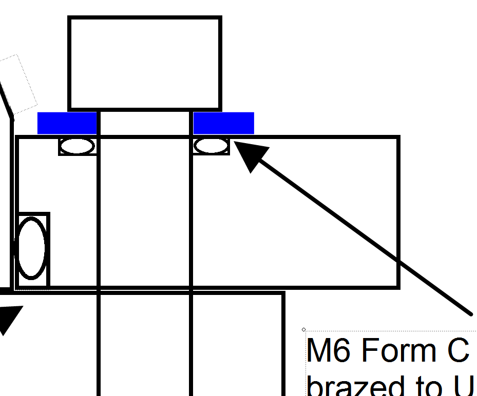

Small. nah its a good size 320x900mm, a gunmakers lathe commonly called.. but all the axles for the drivetrain internally runs in those crappy ass bearings.. The spindle bearings is 50mm id
