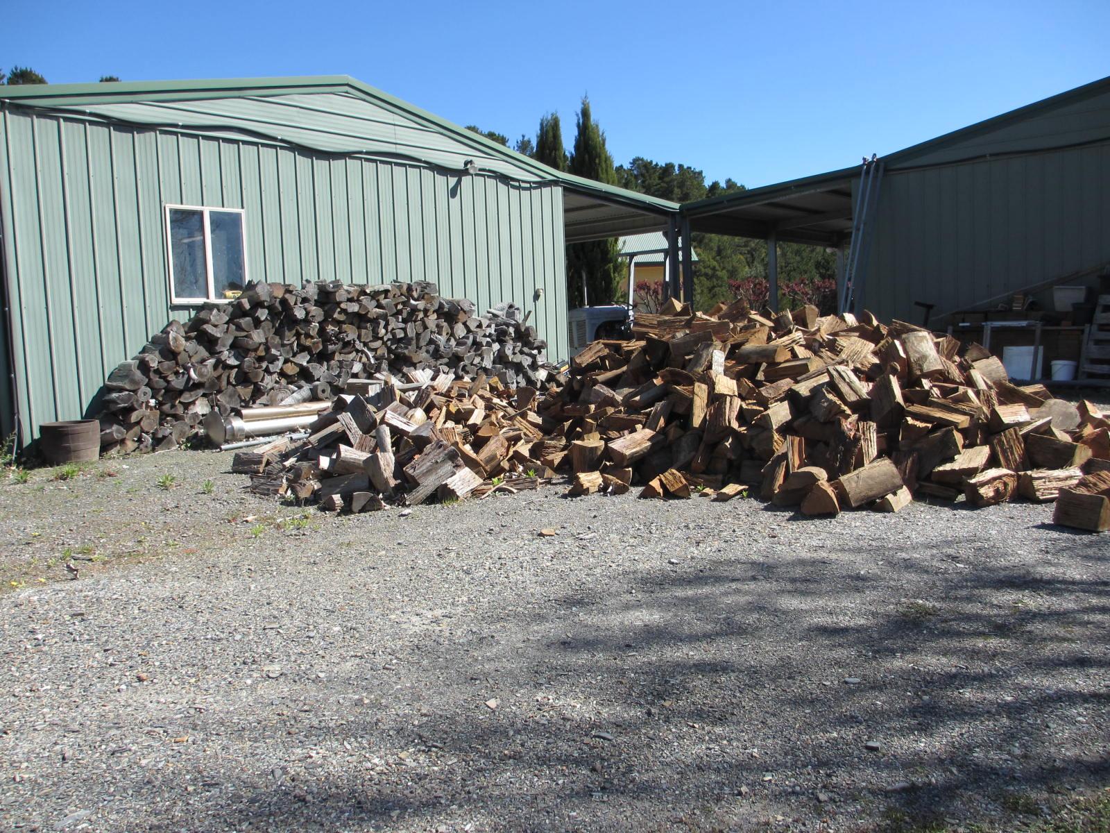

Ross,
I think it is very well made with all the proper joints and all.
Being as you have shown me yours, I show you mine  :D

Ross,
DaveH
Thanks Dave

Log stores are  bit too flash for the fringes of civilisation.
