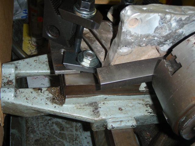

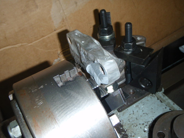

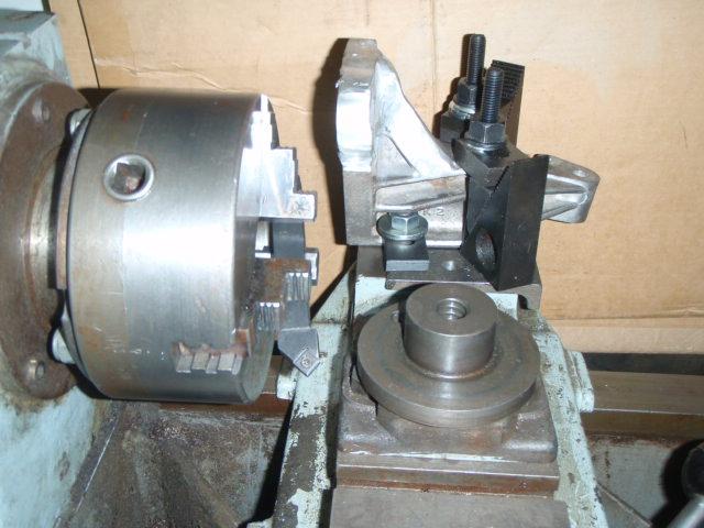

Well...yesterday I had to tidy up a bit of a engine bracet taht had a encounter with my TIG enthustiac brother and his willgness to put a for engine to audi gearbox and cram it into lotus - I think. Anyhow it was too od shape to fix easily into my milling machine...I don't have tombstones or milling boxes big enough.
Lucily I had a piece of **** half a capstan lathe holding floor in it's place. I bit of filing to get one cast parting line straight eneough to allow stable clampping on correct angle.
