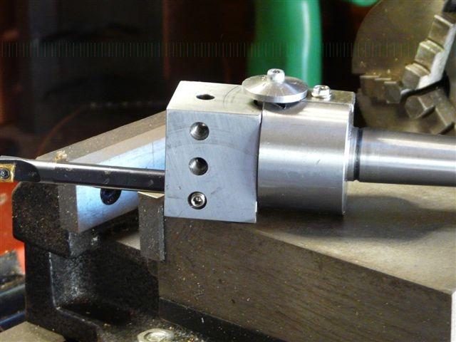

I am currently making a GHT boring head according to the drawings in his book Model Engineers Workshop Manual. I am right now waiting for an M6x0.5 mm tap and plan to screw-cut the feed screw with the mating thread. That way one turn on the dividing head makes 1 mm on the diameter of the bore. makes for simple maths I think.
http://i577.photobucket.com/albums/ss219/H0n3/Tooling/GHT-BoringHead/GHT-BoreHead-03.jpgSmall Boring head, required features
I have an SX1L mill, that is one number smaller than yours bp. Normally I have a 2MT to ER32 head in the spindle so I made a plain 12 mm stem for my boring head.
Oh yes, if you think this head is useful, a material kit is available from Hemingway in the UK.
