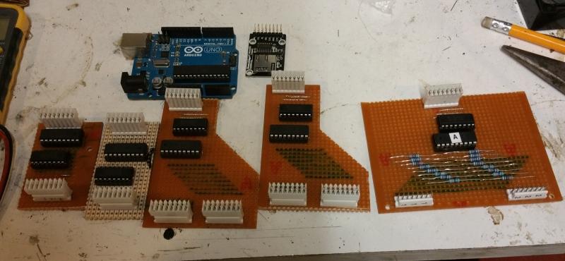

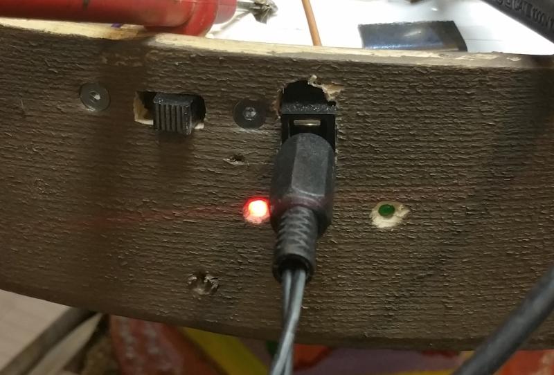

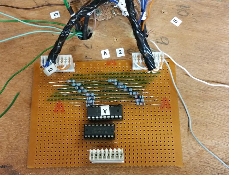

I thought I should post a update in case you all thought this had gone by the wayside again.
I have been busy getting the boards ready for the lights the boards for the top (smaller) dont need any resisters as they are inline on those LED's however the lower boards do as there was not enough room to put them inline in a tidy fashion on those.
the two chips on the board are one SN74HC595 (shift registers) which have a voltage limit of 6volts a mere 80 mA so the second chip is a UDN2981AT which will supply up to 50v at .5A and since I am only using 9 volts and approximatly 320 mA with all light onthey should be more than comfortable here, it took me a while to find these as most of the other drivers are designed to sink the current which would not suit the way I have wired up the LED's.
so anyway pic 1 shows the various bit and 2 shows the first board in the place it will be fixed to, could have done with wiring the connecters the other way around but it should not harm anything the way they are.

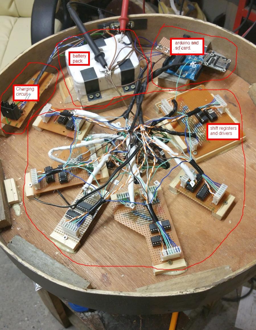

Thanks all its really coming together, I have been spending most of the extra time I had off converting binary to decimal for varous sequences on the lights. File size is currently 22kb and that gives me a varying cycle lasting about 50 seconds so far luckily I only need to do a few conversions the rest is simply cut and paste to repeat the sequences. I will get it to a 3 minute cycle and leave it at that I think.
The rechargeable batteries arrived today so next job is fixing enough of them in to run it all along with the charging circuit then once the serial mp3 player arrives from China that will be everything in place and it will be down to getting the rest of the code right to run it properly.
AdeV the motor will be controlled by the Arduino but hadn't thought about stopping it automatically but I like the idea I might see if I can get it into the code but not sure if I can have multiple milllis()?
Time to brave the sometimes brutal arduino forums I think.

Did get some more done on the carousel however I made up the battery pack from the batteries that arrived just before Christmas and rigged up a charging circuit I got from t'internet.
Made a little mistake with the placement for the charger socket so will need to fill the mess that was left but the only things missing now is the serial mp3 player for the sounds and a little board for the motor.

Still plugging away at it when I get chance in between other stuff which always seems to be a more pressing priority  :doh:
Anyway I have the lights, motor and music all controlled by the arduino now and all thats left is to make a skirt for the bottom of the running board so no little fingers can get under there and be skewered by the bars and sort a roof for it, oh and clean it up because its been in the shed for so long its very dusty  :bugeye:
