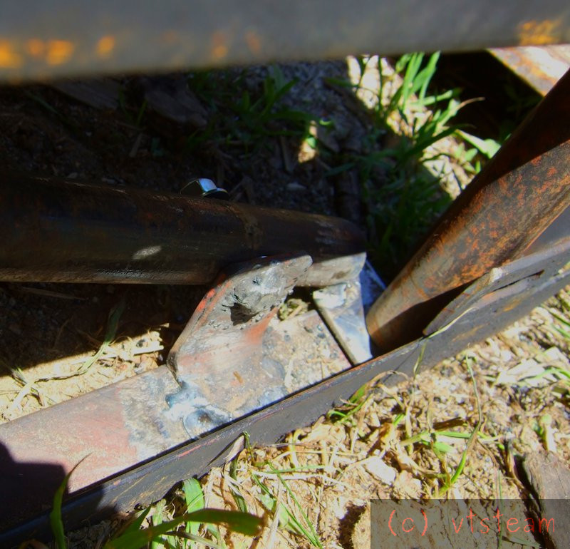

« Reply #75 on: June 05, 2013, 02:15:03 PM »

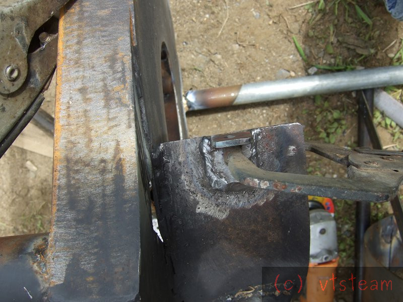

The bracket and bolt welded in place.

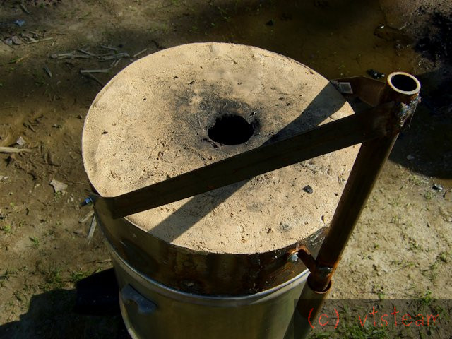

« Reply #76 on: June 05, 2013, 02:17:37 PM »

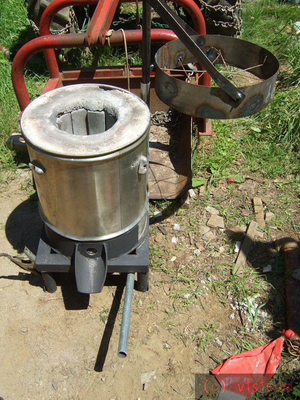

Cupola with lid swung out of the way, and showing the lever extension. Might be a little long, but depending on how hot that furnace and lid is, might seem a little short!
We have rain predicted for the next three days, so that should slow things down a bit.
« Last Edit: January 06, 2018, 04:59:31 PM by vtsteam »

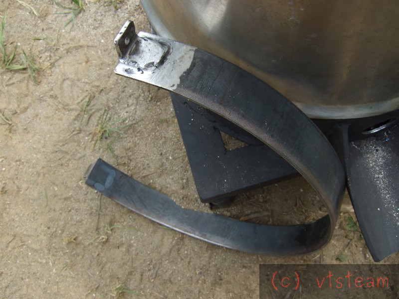

« Reply #78 on: June 06, 2013, 04:35:37 PM »
Thanks Rob!

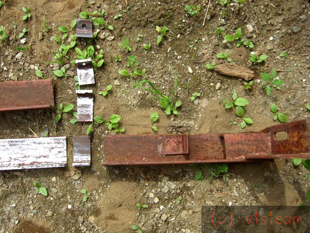

Luckily the rain held off today, and I was able to work on the belt clamp.
First I cut up another piece of that pallet to make brackets:
« Last Edit: January 06, 2018, 05:00:15 PM by vtsteam »

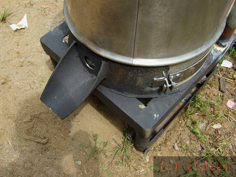

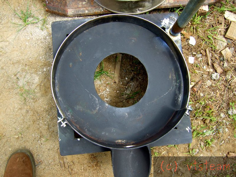

« Reply #80 on: June 06, 2013, 04:45:35 PM »
Then I bent a strap out of 1/8" x 2" and welded the other two brackets to that:
« Last Edit: January 06, 2018, 05:01:38 PM by vtsteam »
  • Posts: 6941
Re: Sawed off cupola
« Reply #81 on: June 06, 2013, 04:49:51 PM »
The strap and base before adding the barrel:
« Last Edit: January 06, 2018, 05:02:47 PM by vtsteam »
  • Posts: 6941
« Reply #82 on: June 06, 2013, 04:53:49 PM »
And the barrel bolted in place:
« Last Edit: January 06, 2018, 05:03:29 PM by vtsteam »
  • Posts: 6941

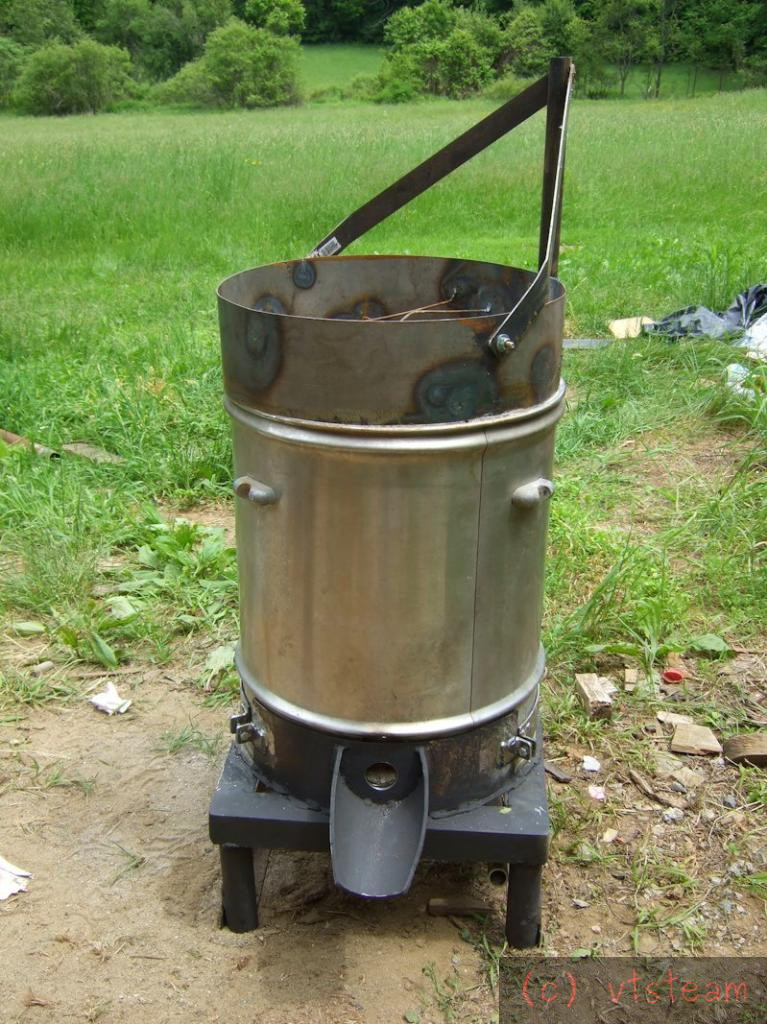

« Reply #83 on: June 06, 2013, 05:00:31 PM »
The furnace mostly finished:
« Last Edit: January 06, 2018, 05:04:14 PM by vtsteam »

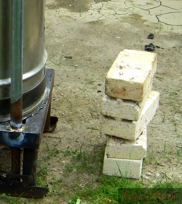

« Reply #84 on: June 06, 2013, 05:12:03 PM »
Because the welding was finished, I moved the cupola up to where it will be tried out. I live on steep ground, so I wanted to get it up there before it started to rain because even the tractor won't make it in mud. We have heavy rains predicted for 2 days. It is supposed to clear up Sunday.
The next job is filling the lid with refractory. I found some lightweight fire brick given to me many years ago by a friend who was rebuilding a kiln. The lid will be quite heavy, since it's 4" thick, so I thought I'd break these up into chunks and plaster them into the mix to lighten it up.
I'll leave a 1" thick layer of pure fireclay and sand as a hot face, since these brick aren't rated at as high a temperature, I believe.

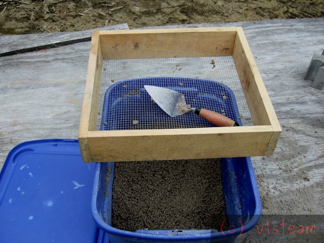

I had a 1/4 bag of fireclay that was in a storage area that was recently flooded with an inch of water. The clay was probably a perfect consistency for making pottery, but poor for mixing with sand to make refractory!
I spent about an hour kneading in sand by hand, then switched to the riddle and put it through that twice using a firebrick as a muller. That was a lot of work!
Finally it seemed to be mixed and stick together reasonably well. I covered it and put it aside, even though I really wanted to ram up the lid. But with rains imminent, I knew that firing it wouldn't protect it, since I couldn't cover a hot lid with plastic sheet, and I could imagine trying to save the whole thing at night in the rain. Bad idea. So, uncharacteristic patience for me -- I put the furnace aside until Sunday.
« Last Edit: January 06, 2018, 05:07:36 PM by vtsteam »

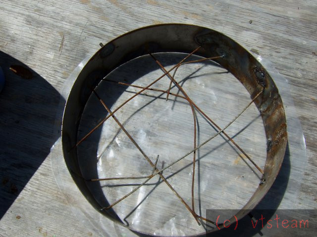

« Reply #86 on: June 09, 2013, 05:46:18 PM »
It's Sunday finally, our one day of sun predicted before we return to rains until Wednesday. Couldn't get much done because of a retirement party for a friend and neighbor this afternoon, but did work on the lid.
Here is the bare metal ring and some scrap reinforcing:
« Last Edit: January 06, 2018, 05:08:32 PM by vtsteam »

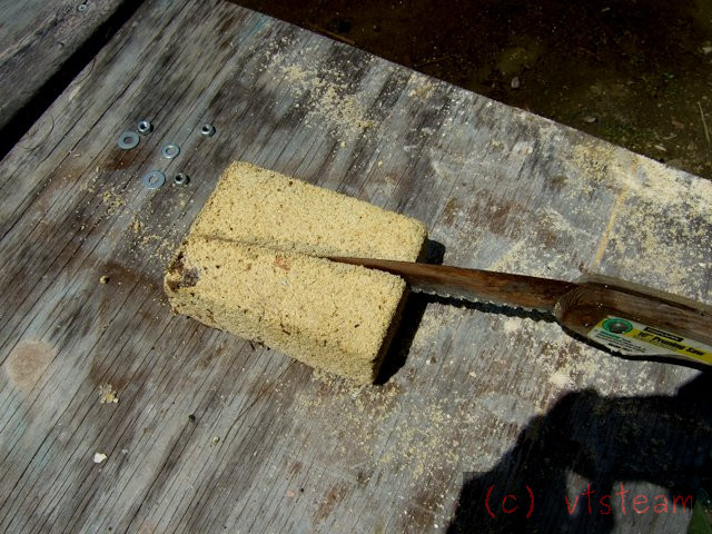

« Reply #87 on: June 09, 2013, 05:48:41 PM »

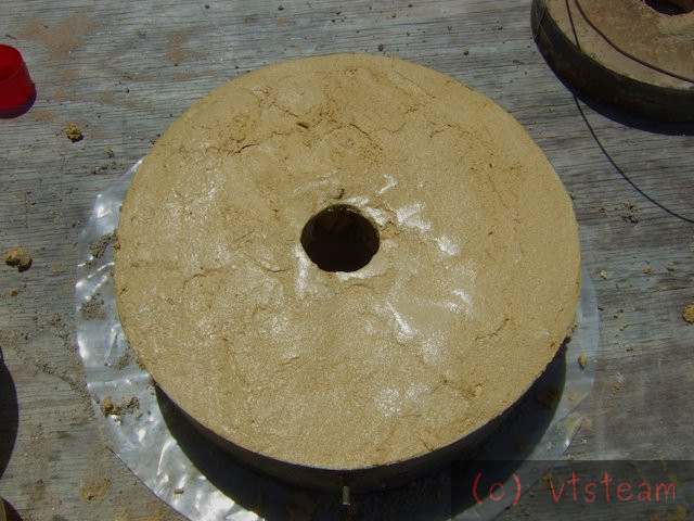

Cutting up soft firebrick with an old pruning saw (never worked well on wood). Cuts quite easily. The bottom of the lid was rammed up first with about 2 inches of refractory before adding the brick:
« Last Edit: January 06, 2018, 05:09:31 PM by vtsteam »

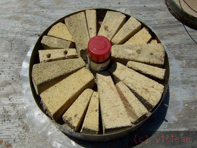

« Reply #88 on: June 09, 2013, 05:50:03 PM »
Checking the brick for fit. The spray can is there to provide a form for the exhaust hole.
« Last Edit: January 06, 2018, 05:10:10 PM by vtsteam »
  • Posts: 6941
« Reply #89 on: June 09, 2013, 05:55:37 PM »
The fire brick was mortared in place with premixed "refractory cement" mixed with Perlite. I had both left over for a few years from other projects. Neither is a super high temp product, but I hope that the 2" of fireclay and sand refractory below will keep the upper portion of the lid within a reasonable temperature range.
I hoped that the refractory cement would provide a better bond to the brick and steel. It contains sodium silicate and fireclay and some kind of non-asbestos fiber. Sticky stuff.
I hoped the perlite would help lighten the lid (as would the insulating firebrick).
Guess we'll find out.

Cooking the lid:
