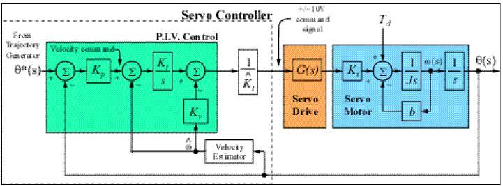

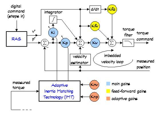

No, I really didn't mean "PID", I meant "PIV" - proportional, integral, velocity.  This seems like the algorithm that has the most promise in the motion controller project I'm working on.  However, I don't understand how to go from the diagrams I've found into code.  Maybe it's a long shot, but I know there are a lot of smart people that lurk here.
I have already implemented PID controlled position, and separately PID controlled velocity.  But getting them to work together is more of a challenge then I imagined.  Right now, I can either command the motor to a specific position (at maximum velocity) or have the motor turn continuously at a controlled velocity.  What I want is to move to the specified position, AT the specified velocity.
Diagrams attached in hopes that someone can give me a simplified pseudo-code example, or point me to some good information about this on the web.  There's lots of PID info, but much less PIV.

This page may be of use
http://support.motioneng.com/downloads-notes/tuning/servo_algos.htm
It shows how they have the PIV velocity loop running inside the PID Positional loop.
