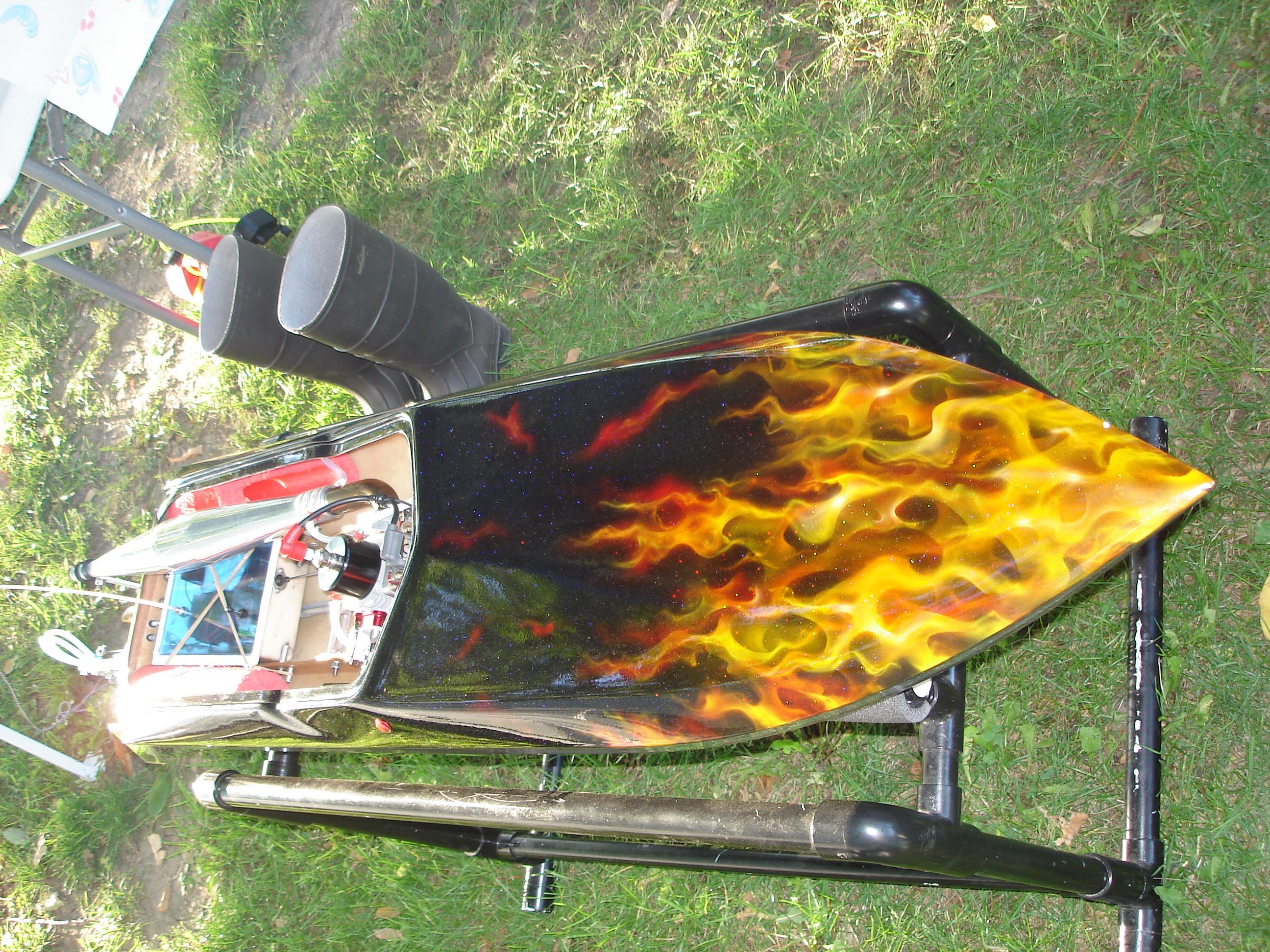

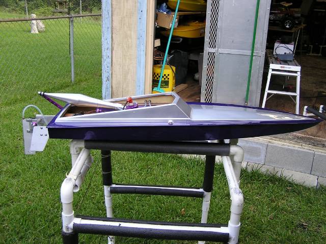

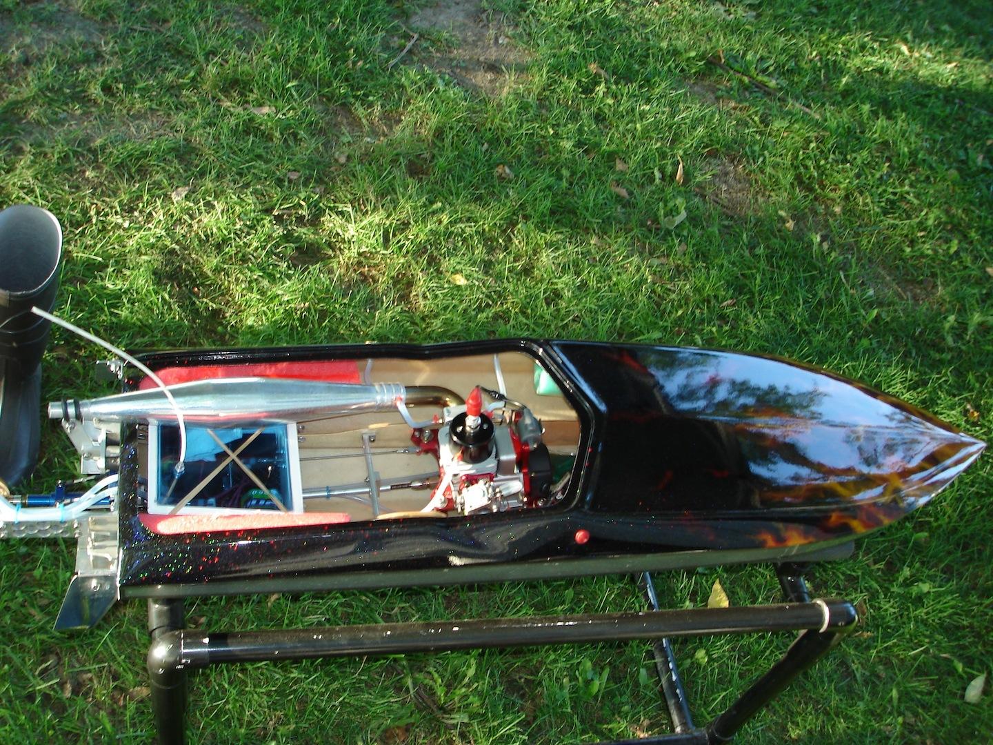

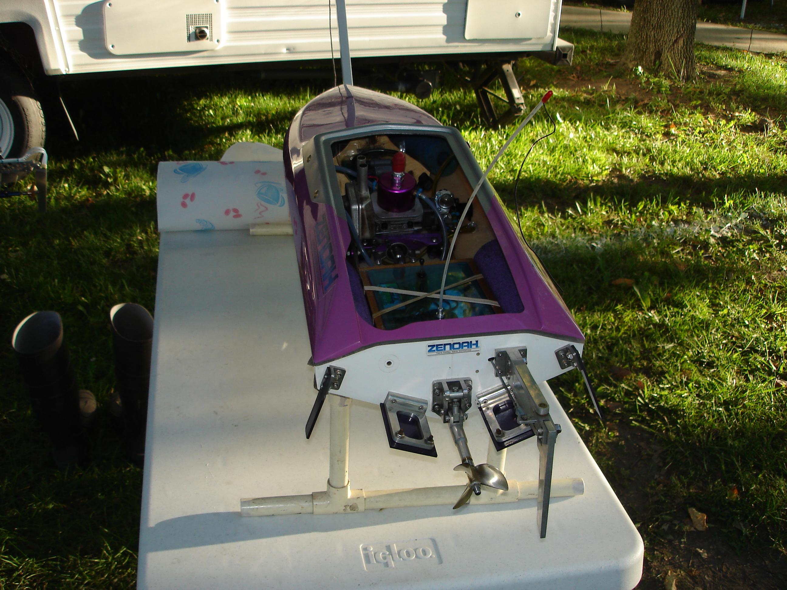

Sorry I forget most of the members here are not from the US.  All of my sources are from the states.
I use to race Gas mono's running full mod Zenoah motors, but got out of the hobby a few years ago because of other interests.  I sold all of my boats, but here are some pictures of some that I use to have.  I made all of the running hardware on the boats with the small lathe and mill in the home shop.
I would love to see some pictures of your boats!
Dale P.
