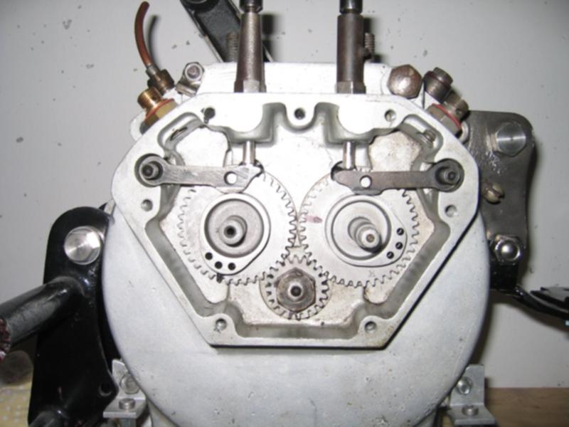

John I found this picture below on the net. I think its Norton. The lifters are not placed over the center of the cam shaft is this a good design ?
http://i1323.photobucket.com/albums/u592/Toms1909engine/norton1_zps50bcb076.png1906 motor bike engine

I wonder if those lifters (cam followers) are original.  Having the sharp edge of them contact with the cam doesn't look very professional.  I would expect severe wear of the cam.
Dave. :scratch:
Re: 1906 motor bike engine
« Reply #34 on: February 09, 2013, 11:19:19 AM »
Tom.
That picture doesn't look right, all the followers I have seen have been top hatted at the bottom.
They are usual off set along the line of the crank where they sit on the cam so the cam first touches on one side and wipes the follower round. This is to equalise wear.
I'll see if I can find a picture.
EDIT Could be right, found this image
http://www.nsamotorcycles.co.uk/ekmps/shops/nsamotorcycles/images/norton-16h-tappet-rod-guide-assembley-complete-1125-p.jpg
  • Posts: 545
« Reply #35 on: February 09, 2013, 12:38:42 PM »
This may be a daft suggestion but could there be something missing from the picture - eg finger type followers pivoted at the corners of the case and lifting the rods.
« Reply #36 on: February 09, 2013, 12:44:07 PM »
I think Russell might be correct as there are two unused bushes right where a finger or slipper would be needed

I think Russell  is right I missed that.

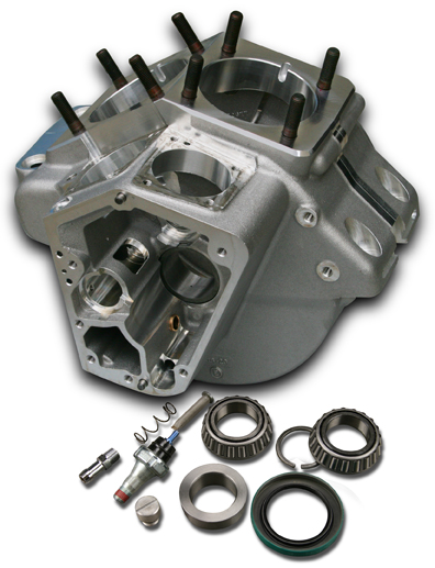

Offline sdezego
  • Posts: 38
« Reply #40 on: February 12, 2013, 06:24:37 PM »
Looking really nice.
Yes, as John mentioned, a lot of early motors had a Breather gear that was timed.  Harley Davidson used the pretty much the same engine case setup and timed breather setup from 1936 all the way up to the 90's (if you can believe it).  ...and almost all earlier models were pretty much the same too.
To give you an idea, the breather was a hollow cylinder about 3" long and 1" in dia and had a solid gear on the gear case side (driven by the cam) (Open end of breather cyl faced into crank case).  It had a window on the side that lined up with a window in the gear case side when in time.  The Breather slid into the case connecting to a pocket in the back of the crank case.  When venting, the windows would align venting crank case pressure into the breather (inside the hollow cylinder) and out into the gear case.  And then from a fitting/tube into the Primary chain side to mist oil the chain.
I am sure I made it sound more complicated than it is, but you could certainly dumb it down for your needs.  I am sure I could come up with some pictures if you need.
Regards,
Shawn
Offline sdezego
  • Posts: 38
« Reply #41 on: February 12, 2013, 06:36:32 PM »
Most of my Harley pictures are pre digital camera  :palm:, but I quickly dug some up on the web to illustrate.
Notice the breather annulus?  And the casting behind it on the left that serves the pocket in the crank case.
and the breather gear
Timed with cam
« Reply #43 on: February 13, 2013, 09:12:52 AM »
I think this shows what RusselT was talking about
« Reply #44 on: February 13, 2013, 02:35:52 PM »
Now that makes a lot more sense.
