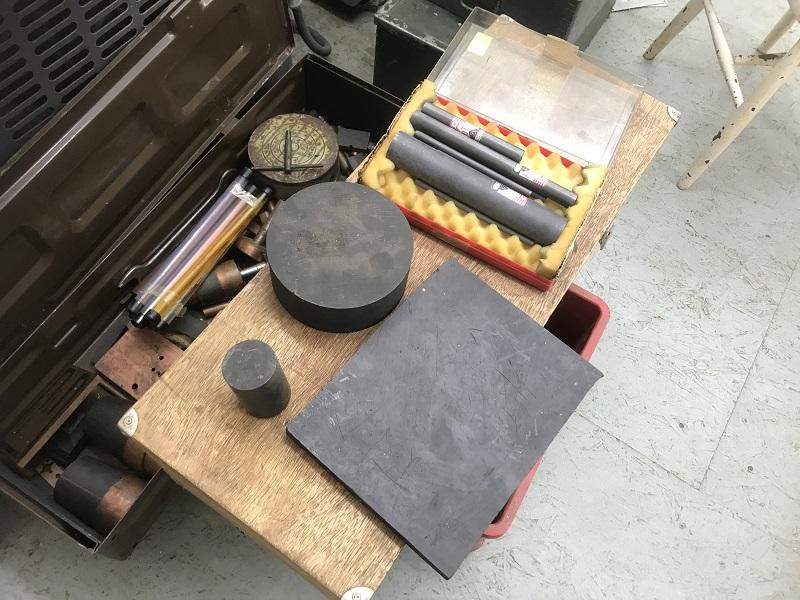

I have another search problem, then I'll stop high jacking this thread! I'm looking for a graphite sleeve or bush, 80mmx 100mm long with a 60mm bore, so far I've drawn a blank , any ideas? Regards, Matthew

Mathew, I may have some in my 'EDM Sinker' box of electodes - I'll have a look tomorrow morning
(The big maker / supplier of graphite as used for EDM electrodes is 'Poco' so meanwhile search on that  :thumbup: )
  • Posts: 9161
Re: Boley 4LV
« Reply #88 on: January 25, 2020, 07:58:36 AM »
Matthew,
My bigger bits of graphite are:
BAR:
50 diam X 85
155 diam x 65
37.5 diam x 225
SLAB
270 x 210 x 20
(All dimensions mm)
Re: Boley 4LV
« Reply #89 on: January 25, 2020, 08:19:49 AM »
Andrew,
Thank you for looking! I am looking for a cylinder, 80mmx100 with a bore of 55mm, so, a bit bigger than anything you have! I have found the POCO Graphite site and I'll do some telephoning on Monday. I have found a very interesting youtube video on making air bearings using graphite, my idea is to make an air-bearing tool holder for my Clarkson tool and cutter grinder!
Thanks again, regards Matthew
  • Posts: 9161
Re: Boley 4LV
« Reply #90 on: January 25, 2020, 08:54:56 AM »
So what advantage has the graphite over bronze, or mild steel even?
When the air is applied shaft and housing do not contact each other, so it is only if the air supply fails when the spindle is still driven that there is any issue, and a pressure switch and air reservoir should cope with that contingency  :scratch:

The advantage over metals is that is porous so the compressed air doesn't depend upon drillings to to create the cushion of air and that it is possible to bore it accurately by hand. With a chrome plated rod there would be no risk of corrosion!

Sintered bronze bushes are porous so don't rule them out if the graphite isn't forthcoming (need to flush the lube out first though)
Re: Boley 4LV
« Reply #93 on: January 26, 2020, 08:31:23 AM »
Andrew,
Thanks for the idea, I've found another solution, 4x100mm squares, 25mm  thick that I can stack to get the size I want. Off to order an off-cut of chromed bar!
Cheers, Matthew
