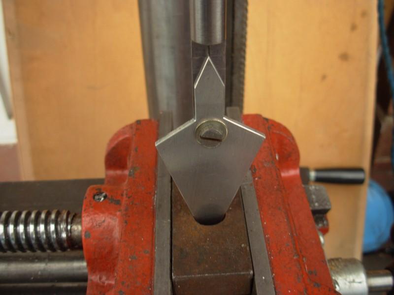

Pic1 Top image shows a BSW screw clamp I made too many years ago, which has been in constant use ever since.

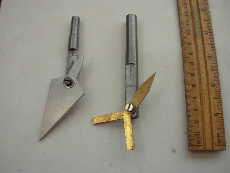

        I recently needed to make some metric screws, so being between projects decided to make a metric version below.
Pic 2 Showing the scale.

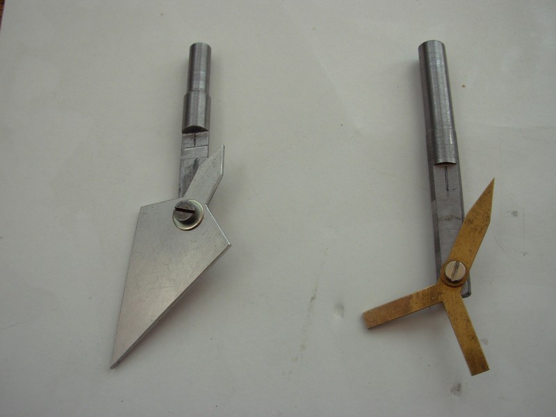

Pic 3 Shows the clamp set up in the vice for sawing a screw to length.

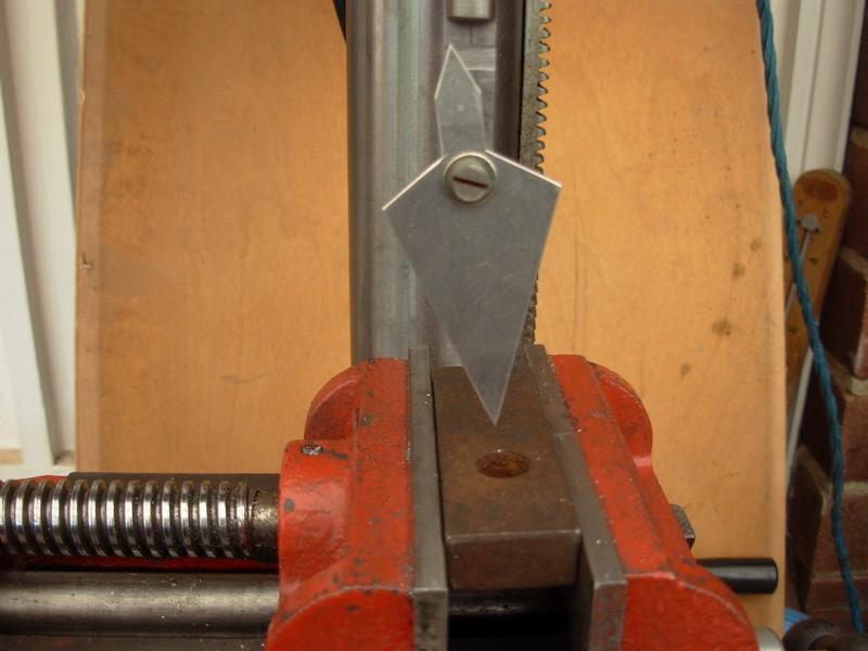

Pic 4 Shows clamp set up for squaring and dressing off the screw end.

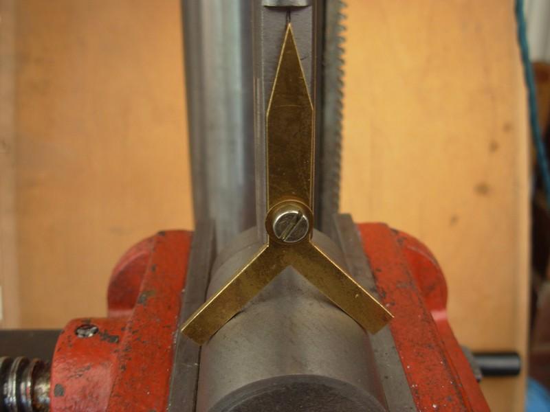

Pic 5 Shows screw head being slotted in the mill.

Excellent! So simple, but so useful. I'll have one made before bedtime.

I have seen a developed version of this tool - which is great by the way.
Imagine that a number of saw cuts are made to a suitable depth for a screw driver slot across the plate. Then a punch mark is made to guide a drill right in the center of the slot thus guaranteing a screw driver slot always being on center on the head. The make a small countersink to a suitable depth  to make sure the scrwe slot will always have the same depth. The rest of the thing is as shown.
Hope you could follow my description  :scratch:
